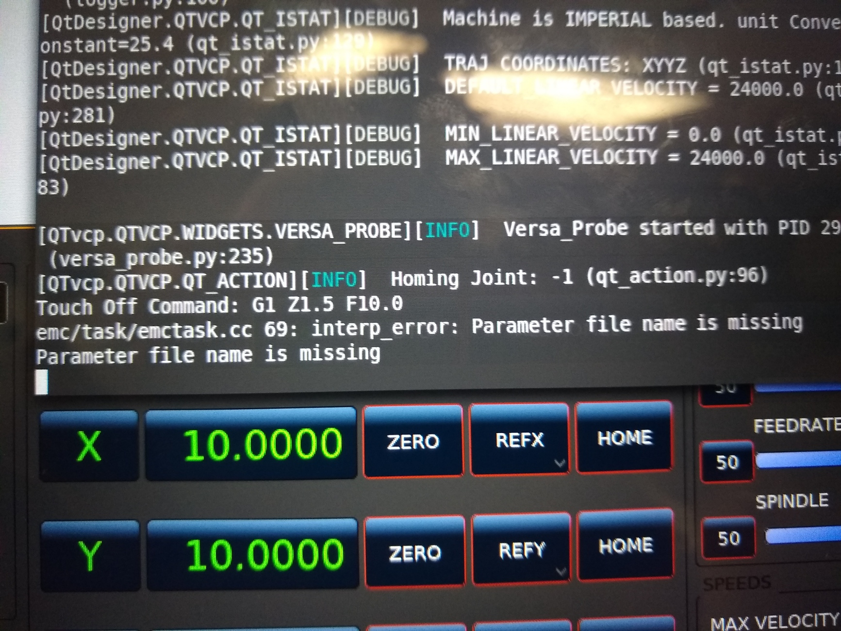

I slept on the problem and determined there must be a problem with the
Running out of things to try I hardcoded the feed rate of 10.0 that I set as search velocity and still an error. Okay, maybe it doesn't like the decimal point.
The 2nd to the last ACTION.CALL_MDI in the touchoff function does not like the '1' digit in the feed rate.
Very strange this makes no sense. Wonder if my machine is corrupted or something. The Vesa probe routines all work fine.
Mathew, what value do you have set for search velocity in settings? If you use the same search velocities I tried do your results match mine?
function inserting bad characters into the command. I then added a print to check the output..format(search_vel)
Oddly though the printed command looked fine despite the error I was still getting. I attached the console output as an image.print("Touch Off Command: " + command)
Still get an error.command = "G1 Z1.5 F10"
command = "G1 Z1.5 F15"
These commands worked without any errors. A feed rate of 15 did get the "parameter file not found" error.command = "G1 Z1.5 F20"
command = "G1 Z1.5 F21"
command = "G1 Z1.5 F30"
Last edit: 19 Jun 2021 17:23 by Myscion.

20 Jun 2021 00:39 #212455
Replied by cmorley on topic Touch plate error
if the command takes lmore then 5 seconds to finish - that will cause an error... not sure why it would be the parameter missing error though.
Does that sound like it might be the problem?

22 Jun 2021 00:00 #212619
by mb_cnc
Replied by mb_cnc on topic Touch plate error
Myscion, I tried hard coding the search velocity with various values and the error message always displays. When displaying the code in message windows it all appears correct. Interestingly the routine has been updating the offset table and positioning the machine correctly so really it's mostly just an annoyance. So if the function is working correctly then what? Maybe it's not exiting the function clean and throwing the error? Not sure.
thanks
thanks
