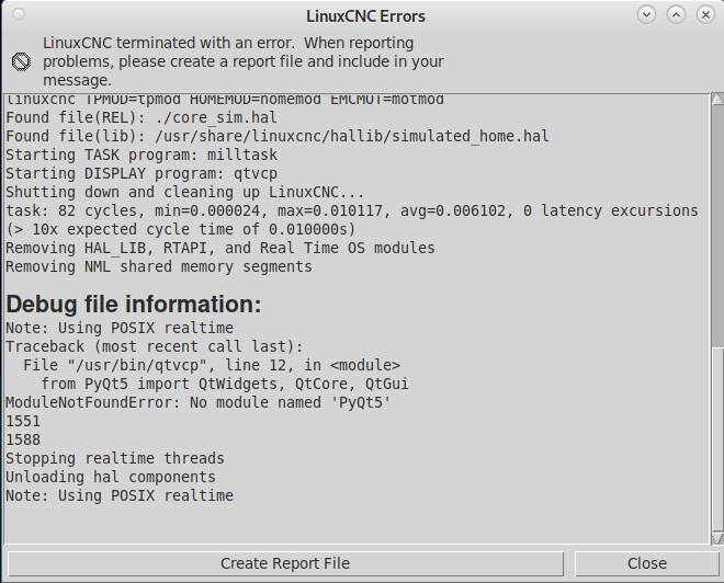

27 Dec 2022 09:41 #260400 by Roguish
Replied by Roguish on topic Up-to-dateness
Chris, thank you for checking in.
'Up-to-date' means Qtvcp works, stock, out of the box.
Make up a simple 3x3 matrix of the combinations of Debian versions and Linuxcnc versions, and check off the ones that work completely, without any problems or errors or warnings, of any kind.   At least for all the gui examples provided in the linuxcnc installations.
Pretty simple question.
Debian current release is 11 Bullseye.      www.debian.org/download
Andy P and others are working to release linuxcnc 2.9.
Since Qtvcp is packaged with Linuxcnc, it should be 'up-to-date' and work error free in the 2.9 release, with debian 11.
Qtvcp should also work for all previous Debian and linuxcnc version combinations.
And, since Debian 12 will be released in 2023, it would be smart to get it going, now.

27 Dec 2022 17:01 #260443 by tommylight
Replied by tommylight on topic Up-to-dateness
To fix that, here:
forum.linuxcnc.org/qtvcp/38414-installing-qtvcp
This should also fix all the dependencies for QtDragin and QtPlasmaC.
As for the rest, not all those GUI's are LinuxCNC projects, those are user made GUI's for LinuxCNC, so mostly maintained by their creators with the help of other users.
LinuxCNC works perfectly with Axis GUI and some others, but i stick to Axis for production machines always, as i got tired of QT and it's huge overhead and consequent issues. Despite this i tried to help developers whenever i bumped into any issue (mostly my fault though :) )
As a side note, how many times did you complain to MicroSoft or Adobe or AutoDesk? Those are paid software that much much worse than Linux, by a huge margin.
I absolutely understand your frustration, but it is an Open Source software, and it is magnificent at it thanks to all who invest their spare time in adding new features and fixing stuff consistently while never asking for compensation, ever.
Just getting things to work with Python 3 was a monumental task that they went through without us here ever noticing much.
So, again, thank you all.
