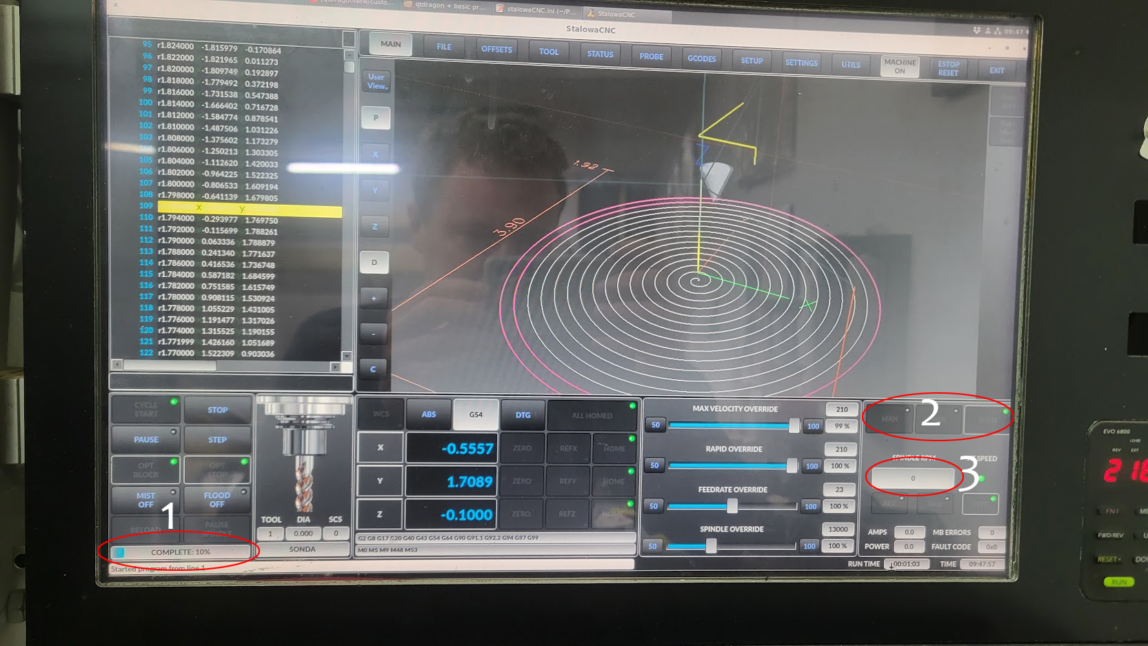

Hello, I need a little help setting up QT. I allowed myself to take a photo with a description.
1. Is it possible to show the time until the end of work here?
2. Are there keyboard shortcuts to enable individual buttons from selection number 2?
3. How to enable the display of turnover in this window

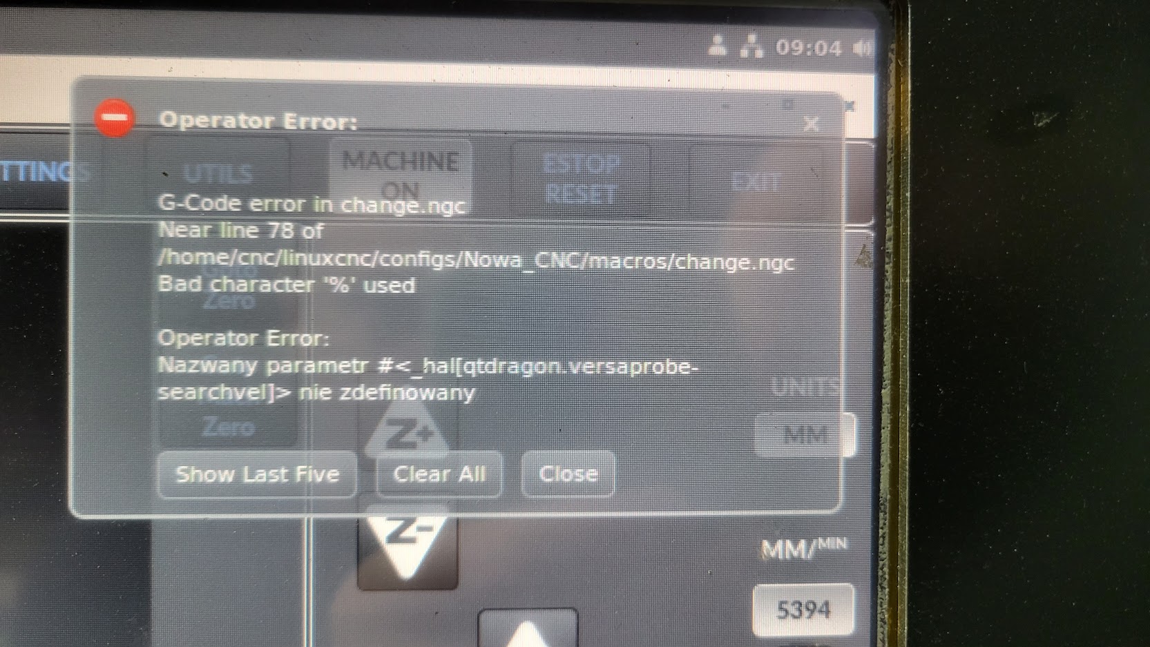

I have versaprobe manual tool change enabled. Unfortunately, it does not work, an error pops up saying that there are no searchvel pins. Where should I add them?
Thanks for any help Tom.

1) There is no easy way to reasonably estimate time. Acceleration of axes usually play a large part of time.
2) There are no short cut keys for mode changes.
3) The spindle RPM status label widget monitors the HAL pin: spindle.0.speed-in
So that pin must be connected to something.
If you would rather it just display the requested spindle speed that can be changed fairly easily.
Can you post the actual error message? I'm not super familiar with versa probe but we can work through the problems. I assume you want to use auto probe on tool changes?

The change.ngc ends with a % but doesn't start with one, I think that is not allowed.
The versaprobe pins are named like this:
qtversaprobe.searchvel
linuxcnc.org/docs/2.9/html/gui/qtdragon....ool_measurement_pins
