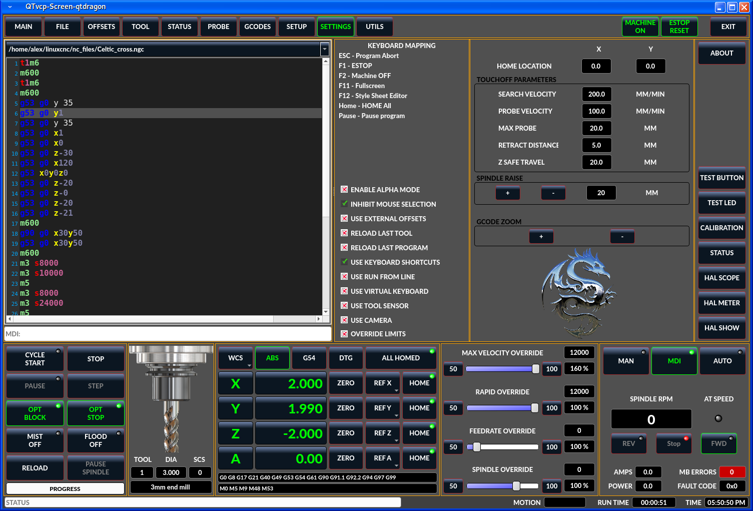

When I hit the stop button it runs returns to the home switches - Prefect. ( MDI_COMMAND = O<b01-go_to_switches> call )
When I hit pause the spindle pause comes on. Also good. However the spindle does not raise out of the material
While looking on the internet I found this thread. The last entry describes exactly what I was thinking of, but there is no further information on how to do it.
I noticed that when the spindle pause is active, it does not actually stop the spindle. I guess there is something else I have missed.
Is there anything further you can help me with?

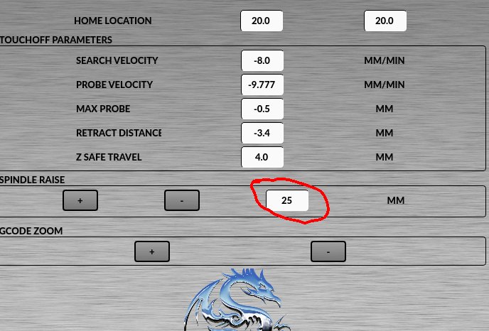

For the spindle to lift, the value in this place must be greater than zero.
The method that Chris did works for me, minor corrections could be made to the button descriptions, but that's a detail.

Did you connect qtdragon.spindle-inhibit to spindle.0.inhibit ?
This is how the spindle is stopped temporarily by Qtdragon.
You have everything setup described here?
linuxcnc.org/docs/2.9/html/gui/qtdragon....xis_on_spindle_pause
As Marek said you also should set the 'spindle raise' setting in the settings tab.
i don't see the link to the thread you reference.

I have everything setup as per your instructions.
I put the 3 lines in my postgut hal. Does the file name matter so long as its loaded?
I have added to my postgui hal file..
net spindle-stop qtdragon.spindle-inhibit spindle.0.inhibit
Which I had missed and now when paused the spindle speed goes to 0
I have the offset set to 20mm in the settings screen although I have now noticed that this is not saving when I exit.

Even if I set the spindle raise value & then run a program and then hit pause, the spindle goes to 0 speed but does not lift up.

I don't see these two lines in your post fui file:
setp axis.z.eoffset-enable 1

Yes. That is definitely the problem. it is now working exactly as you described.
Sorry to waste your time. I had looked at the page & thought those lines were only ment for QTDragon_hd. My miss reading.
Do you have any idea why the spindle raise & other settings are not being saved when I exit?
