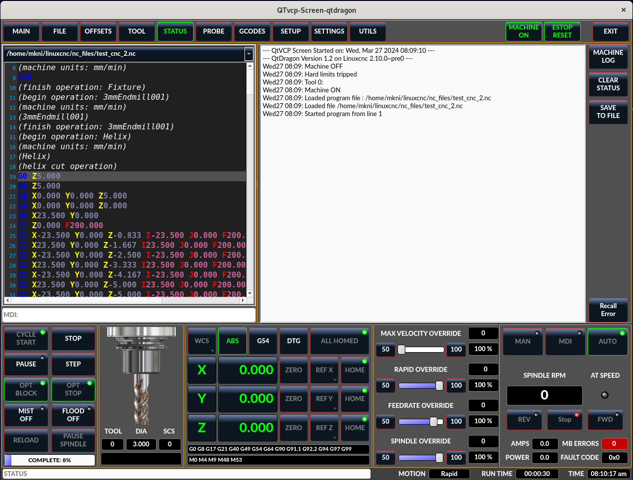

Hi, first af all thanks for all the amazing work being done with linuxcnc
Im currenctly trying to get qtdragon together with linuxcnc 2.10 on debian 11 and a mesa 7i95t.
I can run my gcode using the Axis user interface, but when switching to qtdragon, i can't run my gcode.
With qtdragon, I can jog stepper motors.
When using Axis user interface, it is possible to use MDI commands, but the same commands will not work with qtdragon.

When wanting to run gcode program, are you in auto mode? You must press the auto mode button to move to auto mode.
What command are you trying in MDI That doesn't work?

I'm in auto mode, I have attached screen shots of how the GUI looks.
MDI CMD: G0 X10.000 and G0 X0.000
If i switch to axis display with the same config, the MDI commands are working.

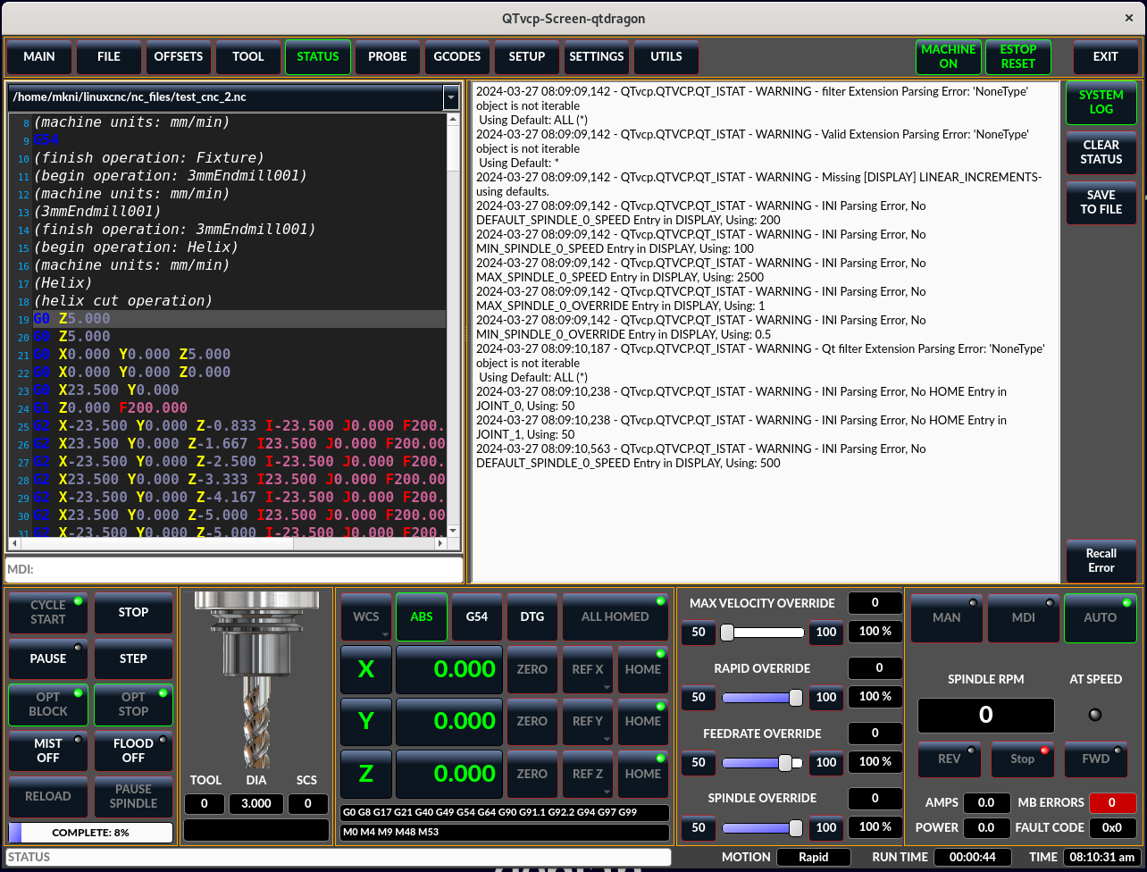

There is to much stuff missing from the ini file, how did that happen?
Make a new configuration.

If the "max velocity override" slider is set to zero, it will not work

This was the source of the problem.
Under
[TRAJ]
MAX_LINEAR_VELOCITY = 0.0
When this setting was changed, the gcode would run.

OK, then edit the ini file to add what is missing, just look at the second screenshoot you attached, there is a long list of what is missing.
It might work as is, but might also cause unwanted issues during later use. Make a copy first and keep it safe.
