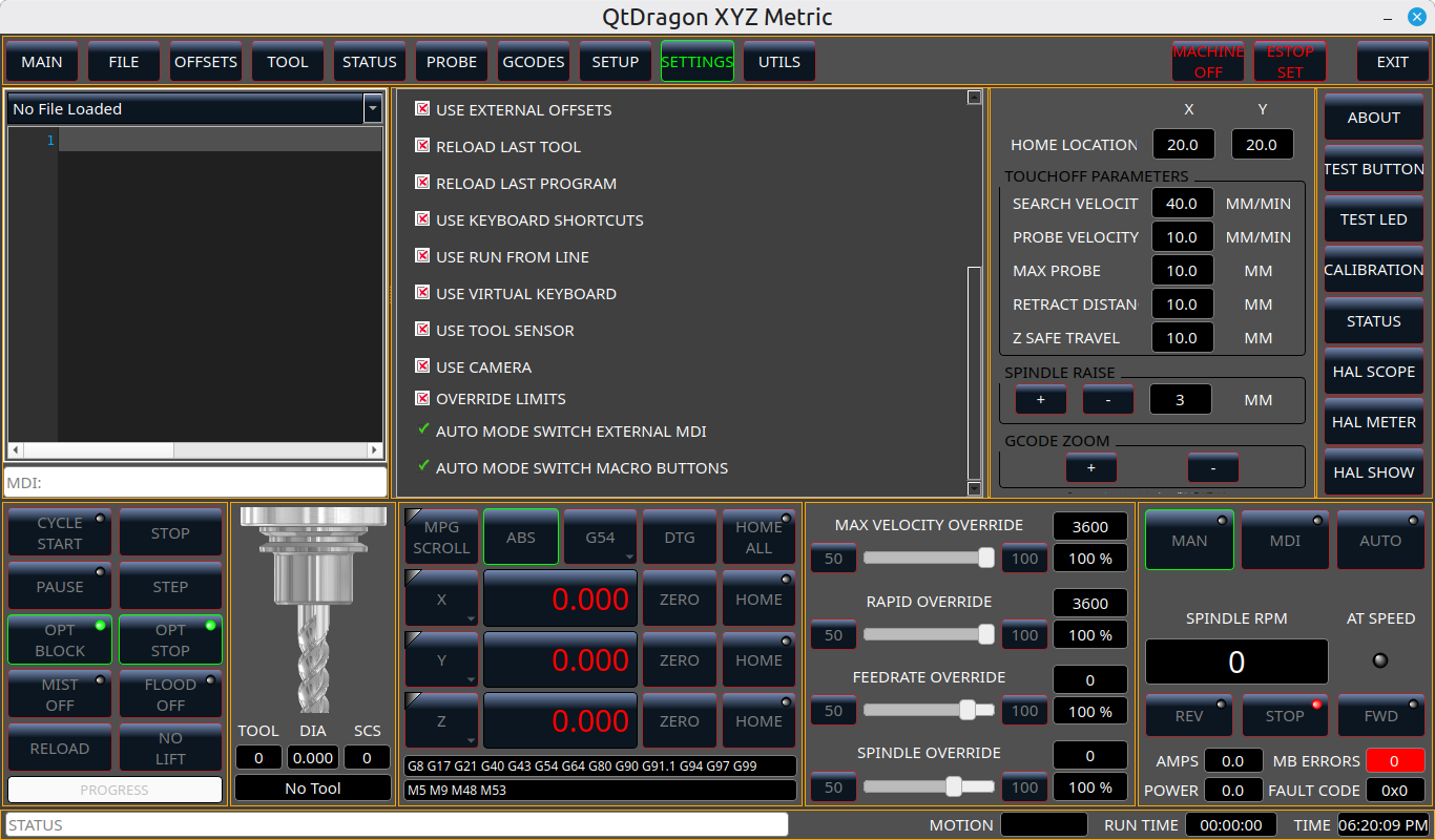

08 May 2026 01:21 #346266
Replied by cmorley on topic Qtvcp GUI and hal pins
Does the settings page look like this?

Replied by COFHAL on topic Qtvcp GUI and hal pins
There seems to be a misunderstanding; I don't think I've been clear. I'm using a QTDragon HD, and this screen is also from QTDragon. I don't know if that has anything to do with the problem.
Indeed, those functions do appear in the Qtdragon version, and it also automatically switches from Manual to MDI, but the problem of not finding the Oword route persists. This was also updated in Qtdragon HD, but not in Qtdragon HD. I thought they were the same, but now I realize they are different projects.
