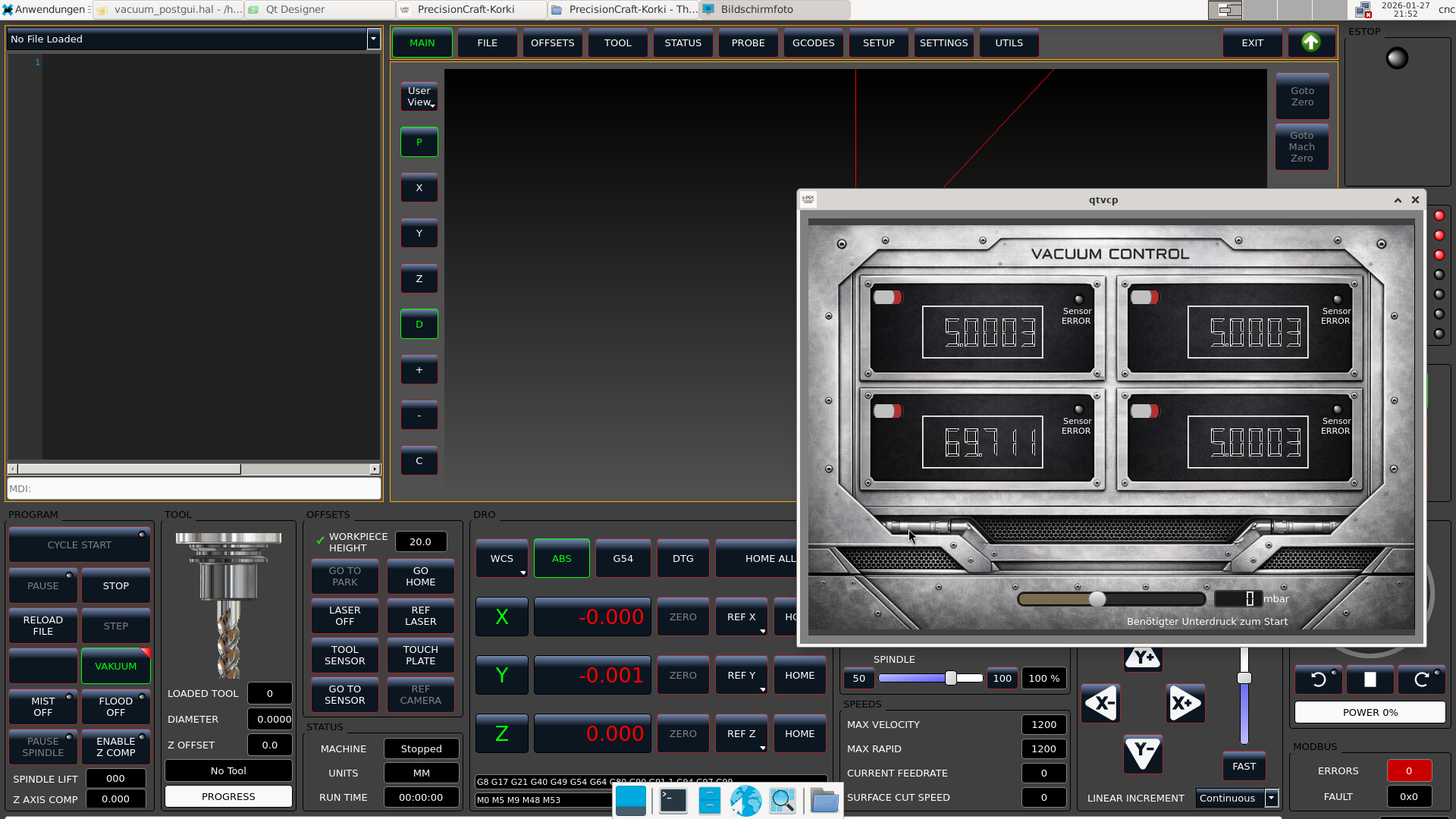

27 Jan 2026 21:11 #342022
by DemonClaW
Replied by DemonClaW on topic Generating a own Popup
Hey Guys,
I was quite busy that week so i didnt get much work into it but here is what i got at this point.
On left down corner you can find a Vakuum button that allows you to switch Clamping variant between a vice or something like that and vacuum clamping. It opens the PopUp on the right side, there you find 4 displays for 4 vacuum plates, your able to switch them on or off depending on how large your workpiece is you can work with 1 or with all 4. The Main Slider down in the middle allows you to set the needed pressure. Every plade is moitored by a single Pressure sensor on a beckhoff EL3124. If the pressure gets lower then the main slider value the system goes immediately in E-Stop mode to provide serios accidents. The main slider may gets removed after i made some experience with the system.

27 Jan 2026 22:11 #342032
Replied by tommylight on topic Generating a own Popup
We need a GUI with that industrial design !!!
Looks very ... industrial..
I like it.
I like it.
