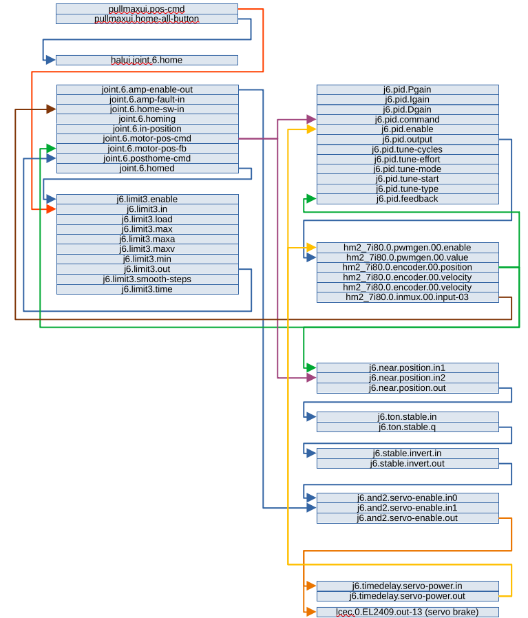

10 months 4 weeks ago - 10 months 4 weeks ago #339706
by NWE
Replied by NWE on topic Ursviken Pullmax Optima 130 press brake retrofit with 4 axis backgage

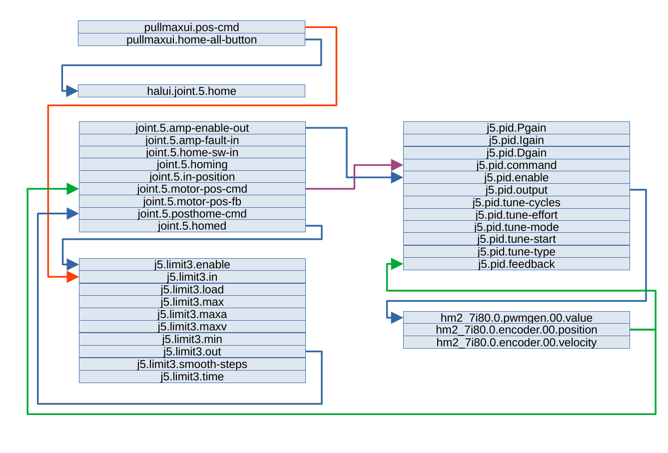

I think I begin to see into how this 'extra joints' command flow works.
1. My ui will trigger homing via a "Home all" button. NOTE: Y1 and Y2 will need footpedal operation to complete the ram homing and they home simultaneously.
2. When homing is complete, the joint.5.homed pin enables the j5.limit3.enable to enable program control of that servo.
3. My ui sends a position to j5.limit3.in then j5.limit3.out feeds joint.5.posthome-cmd. This seems to be a position value (not velocity). If I am correct, that is what I need here.
4. The position from #3. feeds straight through to joint.5.motor-pos-cmd into j5.pid.input
5. j5.pid.output is a velocity command driving hm2_7i80.0.pwmgen.00.value
6. Feedback is in the form of hm2_7i80.0.encoder.00.position to joint.5.motor-pos-fb and to j5.pid.feedback
I attached a flowchart of this for reference.

- Posts: 4819
- Thank you received: 2177
10 months 4 weeks ago - 10 months 4 weeks ago #339716
Replied by Aciera on topic Ursviken Pullmax Optima 130 press brake retrofit with 4 axis backgage
if you don't want the 'axis' gui at all you can set DISPLAY entry in the [DISPLAY] section of your ini from 'DISPLAY = axis' to 'DISPLAY = halui'
Note:
if present you would also need to comment out 'HALUI = halui' in the [HAL] section
Note:

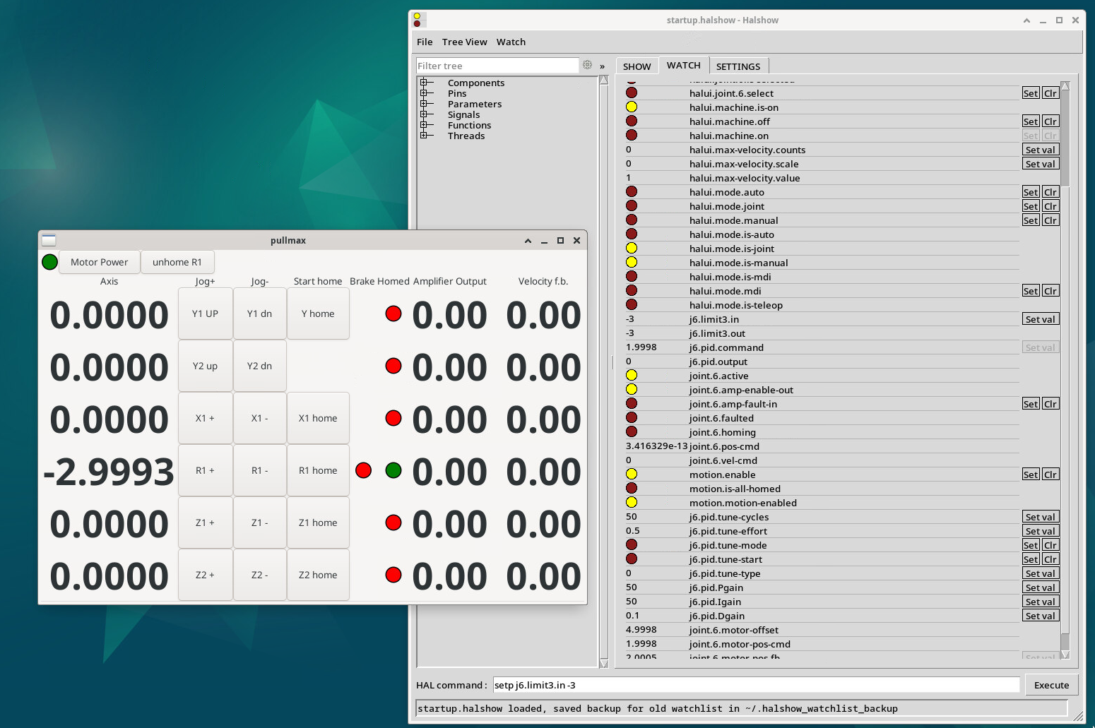

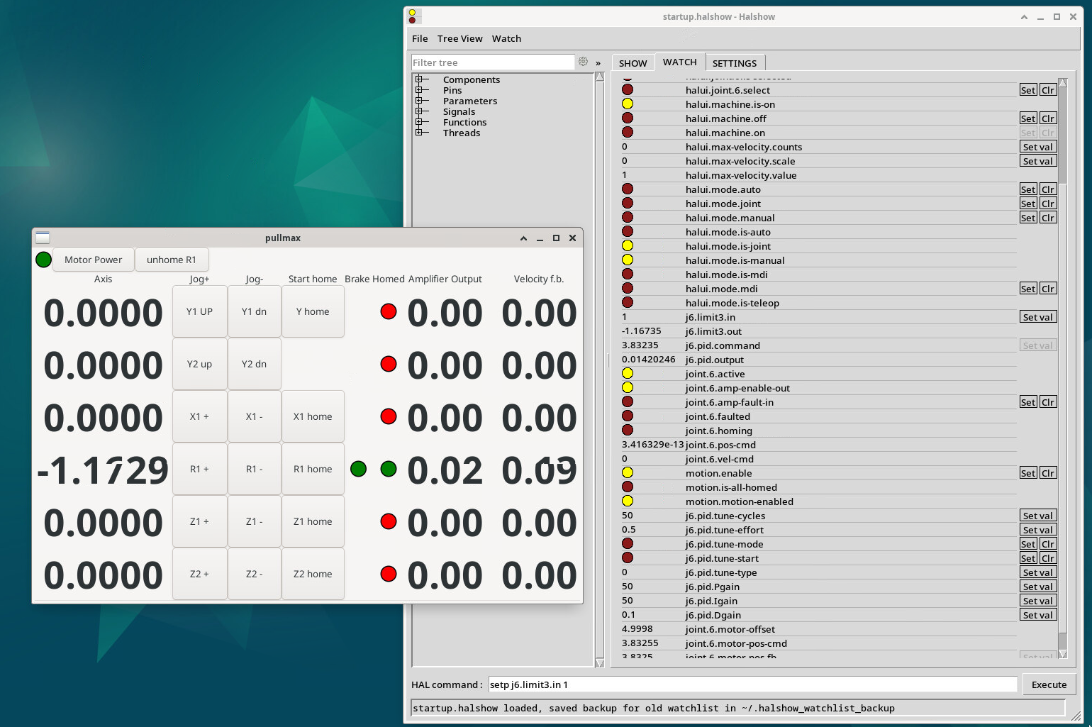

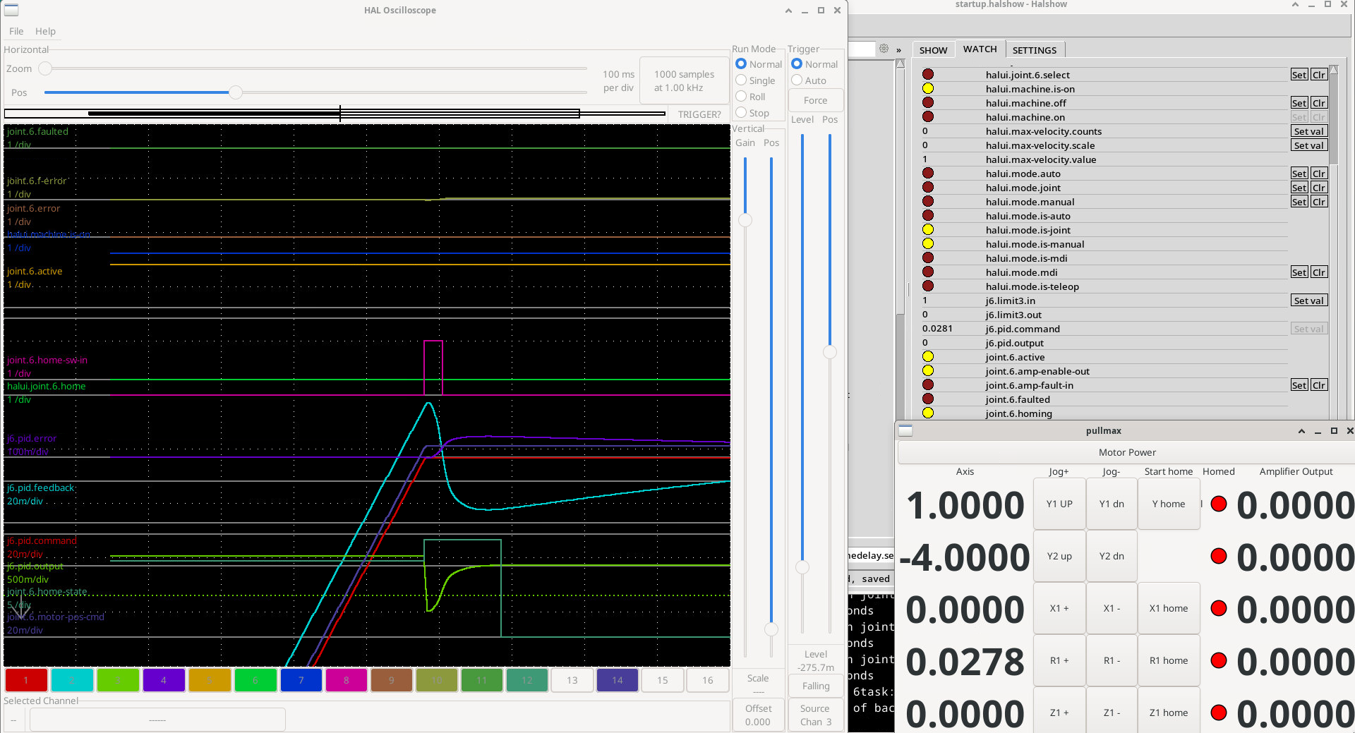

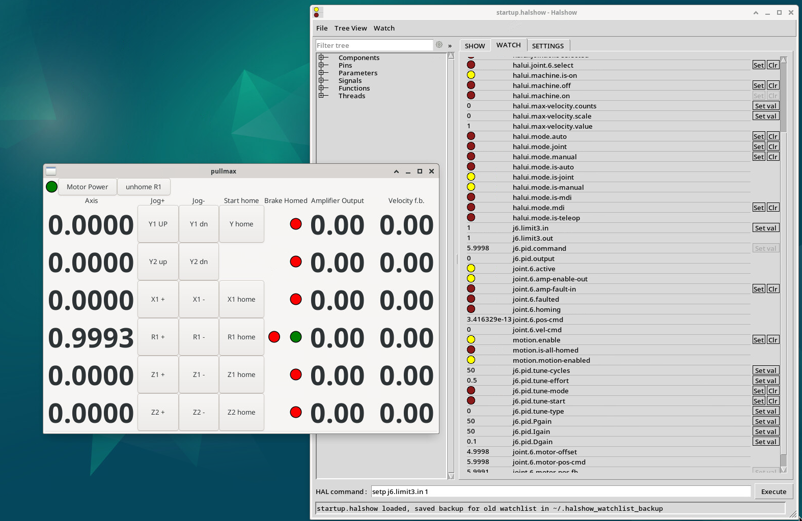

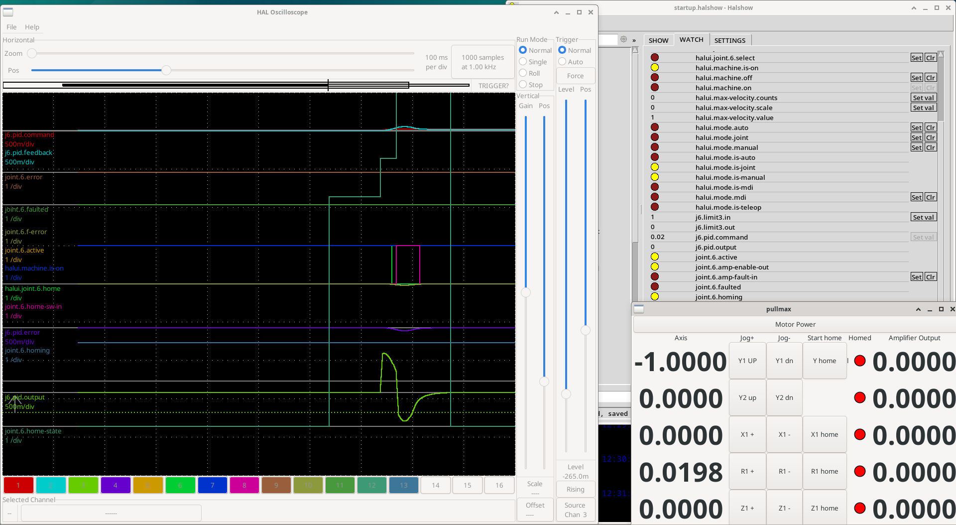

For a bit I made poor progress tuning the R axis. No wonder, it has a brake in the servo and I overlooked that. Yesterday I had a bad day with that little brake. I was manually driving that axis closed loop by setting j6.pid.command and j6-unlock via halcmd in a terminal. I parked it with the brake locked, jiggled pid.command around till pid.output went to 0.0000 then looked at my brake hal logic....
About 2 hours later I was submerged in hal logic. 30 feet away a guy was welding. Somewhere in the back of my mind I'm blaming him for welding through paint. 5 minutes later the boss comes worrying. "I smell hot wires!" He stuck his nose in the big cabinet... nothing there. He walks around the back of the press. Phew! I hit e-stop, cutting power to the servos, but that nice old Baldor DC servomotor is now junk. Good thing I earlier forbade the boss from promptly scrapping the PSA and PSB axis. It had an identical motor.
It appears the brake had at some point allowed the axis to drift down about 7 encoder counts. At that point the pid slowly wound up but the motor was unable to fight the brake back to 0.000 position and gradually overheated and then smoked.
I now have hal logic automatically operating the brake for me. But it is interfering with the homing. I just now saw into it: my servo enable after brake release delay must be slightly too long. Homing starts then after my 0.1s delay the pid has some catch-up to do and overshoots just enough to fault the homing sequence.
I'm attaching my complete config. Most of the working part of it at this point is joint 6 (almost working). More to come...
Last edit: 10 months 3 weeks ago by NWE. Reason: typo

Does not seem to be my brake logic. Now I have it searching for home slowly for several inches. It touches home then my pid.output slams in reverse, pulling back off the home switch then I get this error:
Home switch inactive before start of backoff move j=6
Ah-ha! This must be something with pid tuning. I suspect my I-gain is too low. And maybe I need to give it some D-gain.
My brake logic is (if I'm correct) straight passthrough during joint motion. The only exception is the enabling period at start of motion (currently 0.05s) and the parking after 10s of no axis motion.
edit: More than anything else, looks like MAX_ACCELERATION was way too high.
Another problem was the homing is not finding the encoder index, disabled the home-to-index for now.
Now I got joint 6 homing. Needed to make some polarity corrections to HOME_SEARCH_VELOCITY and HOME_LATCH_VELOCITY. Next problem: I command it to go to R 0.000 and it goes to R -0.7683 instead, showing -0.7683 on the gui and that is also where it seems to be at when I measure the physical joint position. This is the motor offset value that is being set during homing. Looks like I need to sort out in my config which value is "raw axis position" and which is the "user friendly value"
This did it: I adjusted HOME_OFFSET so I could command 0.000 and have it go to 0.000
To correct the joint position readout in the gui I moved its hal pin from hm2_7i80.0.encoder.00.position to joint.6.pos-fb
Last edit: 10 months 3 weeks ago by NWE. Reason: MAX_ACCELERATION

I see I need to fix my brake logic: I've been noticing glitches in joint motion and have discovered that when I am moving the joint slowly for longer than my servo-to-brake delay, it will lock the brake momentarily then release it again. I will just need to have it monitor several values besides j6-pwm-cmd. I'm thinking velocity feedback and distance-to-go. This will be directly related to the timeout logic above.
Once I get it right I want to rewrite it in a custom hal component which I plan to reuse on additional joints. The other joints with no brake probably need a parameter to switch off the unlock feature so it does not use the servo enable delays and cut servo amp output during no motion.
