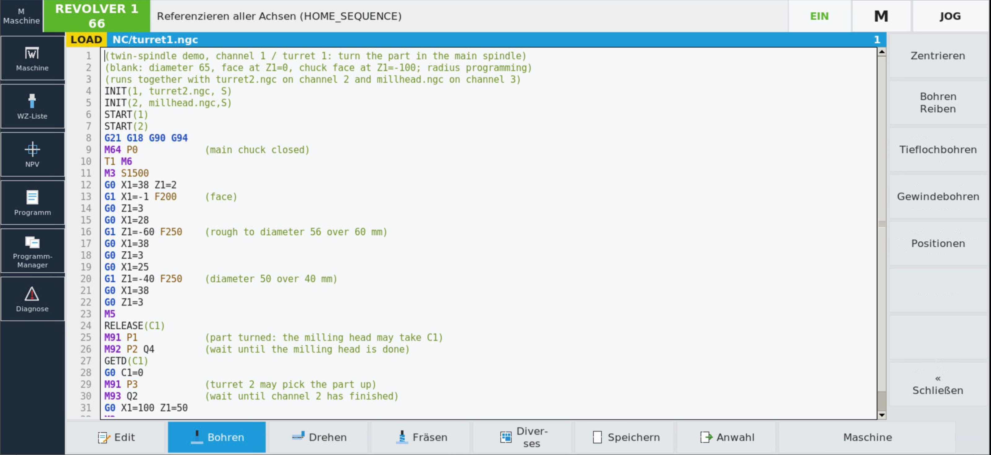

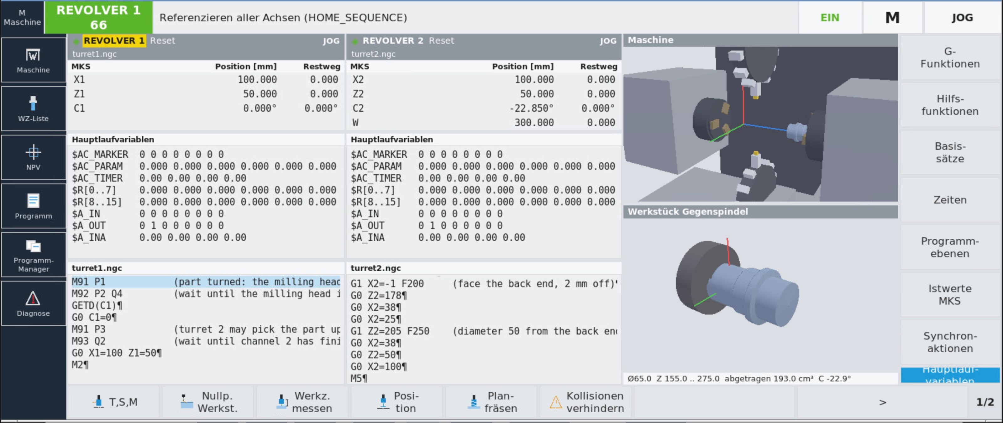

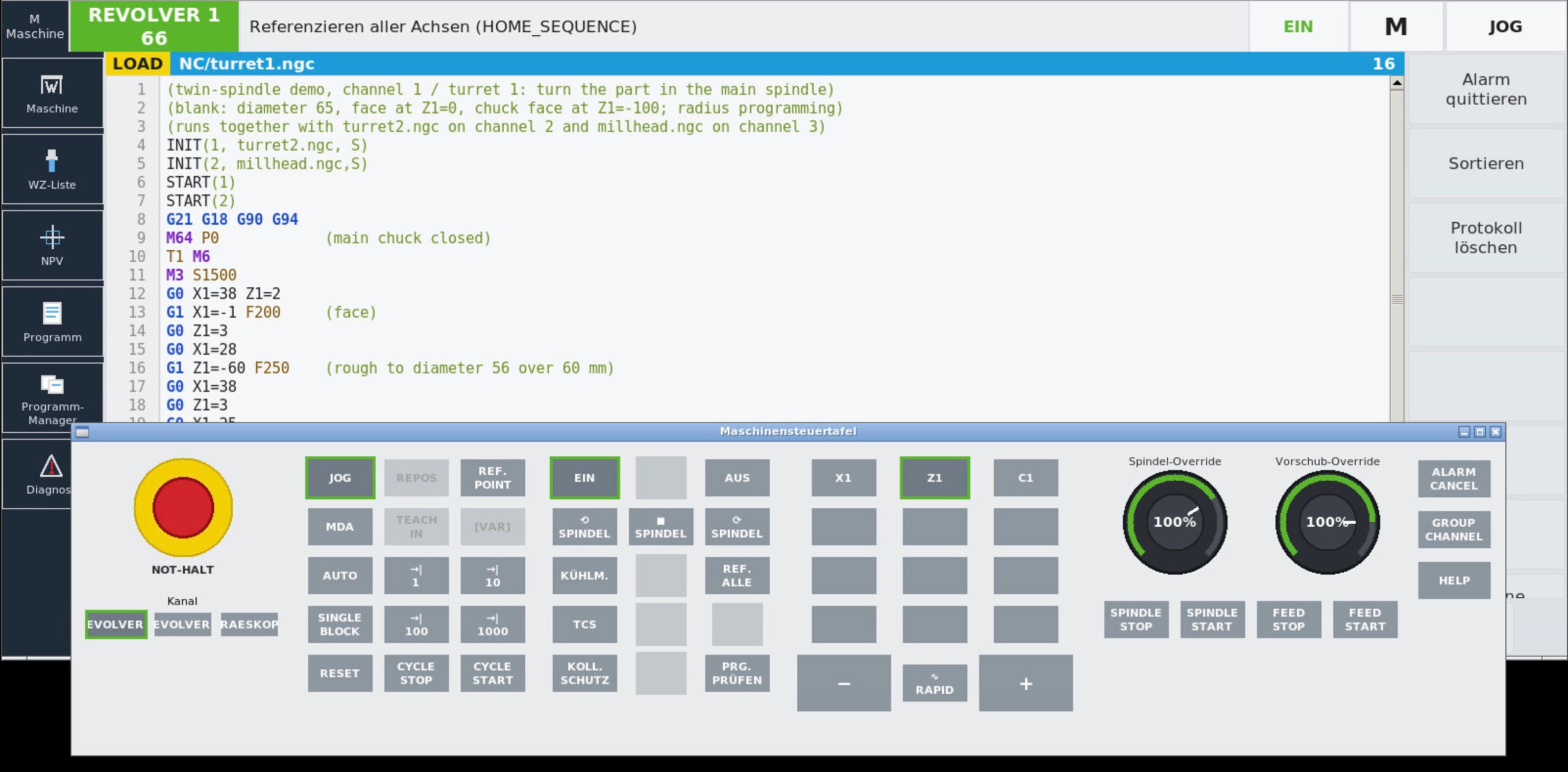

Hi everyone,I’ve been working on a new multi-channel extension for LinuxCNC, mainly targeting complex turning/milling machines such as INDEX, Gildemeister, multi-spindle lathes and other machines with several independent machining units.The goal is to bring LinuxCNC much closer to the functionality normally found on industrial controls such as Siemens SINUMERIK, especially for machines with multiple turrets, spindles and synchronized machining processes.Main featuresMultiple CNC channelsThe system can run multiple independent machining channels simultaneously. The architecture is not limited to just two channels and is designed to support a very large number of channels, depending mainly on the hardware and machine configuration.Each channel can execute its own NC program independently.Example:Dynamic axis assignmentAxes are not permanently tied to one channel.An axis can be transferred from one machining channel to another during operation.For example:This makes it possible to handle machines where several machining units need temporary access to the same spindle or axis.Channel synchronizationThe system includes synchronization functions similar to those used on industrial multi-channel controls.Channels can wait for each other or synchronize at defined points inside their NC programs.Typical applications are:
Channel 1 → Turret 1 / Main spindle
Channel 2 → Turret 2 / Sub spindle
Channel 3 → Milling unit
Channel 4 → Additional machining unit
...Channel 1:
X1 Z1 C1
Channel 2:
X2 Z2 C2
Transfer C1 →
Channel 2:
X2 Z2 C2 C1- part transfer between main and sub spindle
- synchronized machining
- waiting for another turret
- synchronized spindle operations
- coordinated tool changes
- machining sequences involving several channels
- cylindrical surface machining
- face machining
- C-axis milling
- turning/milling combinations
- complete machine geometry
- tools
- workpiece
- fixtures
- spindles
- turrets
- axis movements
- tool and machine
- tool and chuck
- tool and fixture
- turret and spindle
- machine components
- workpiece and machine

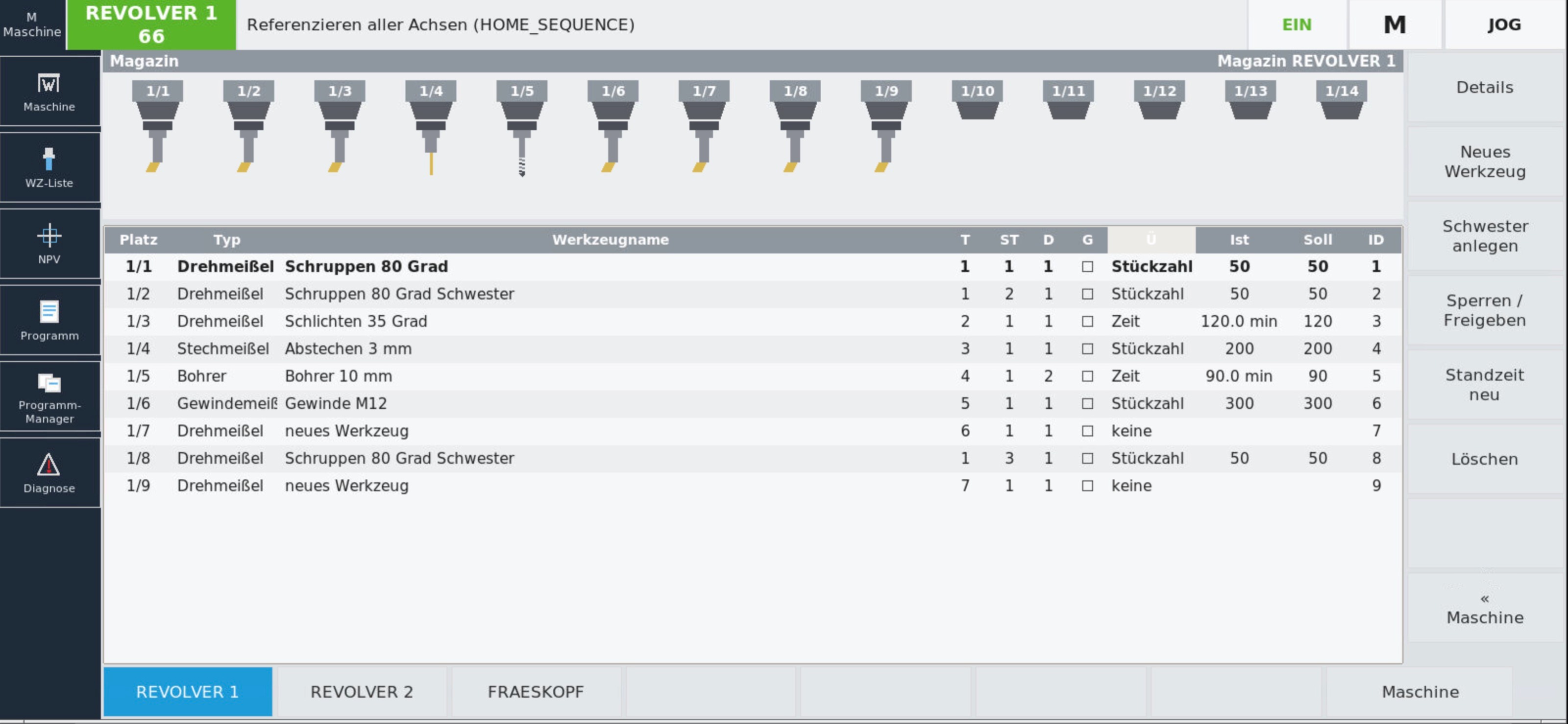

- tool geometry
- tool offsets
- sister tools
- tool life monitoring
- remaining tool life
- automatic replacement with sister tools
- tool status
- tool usage tracking
