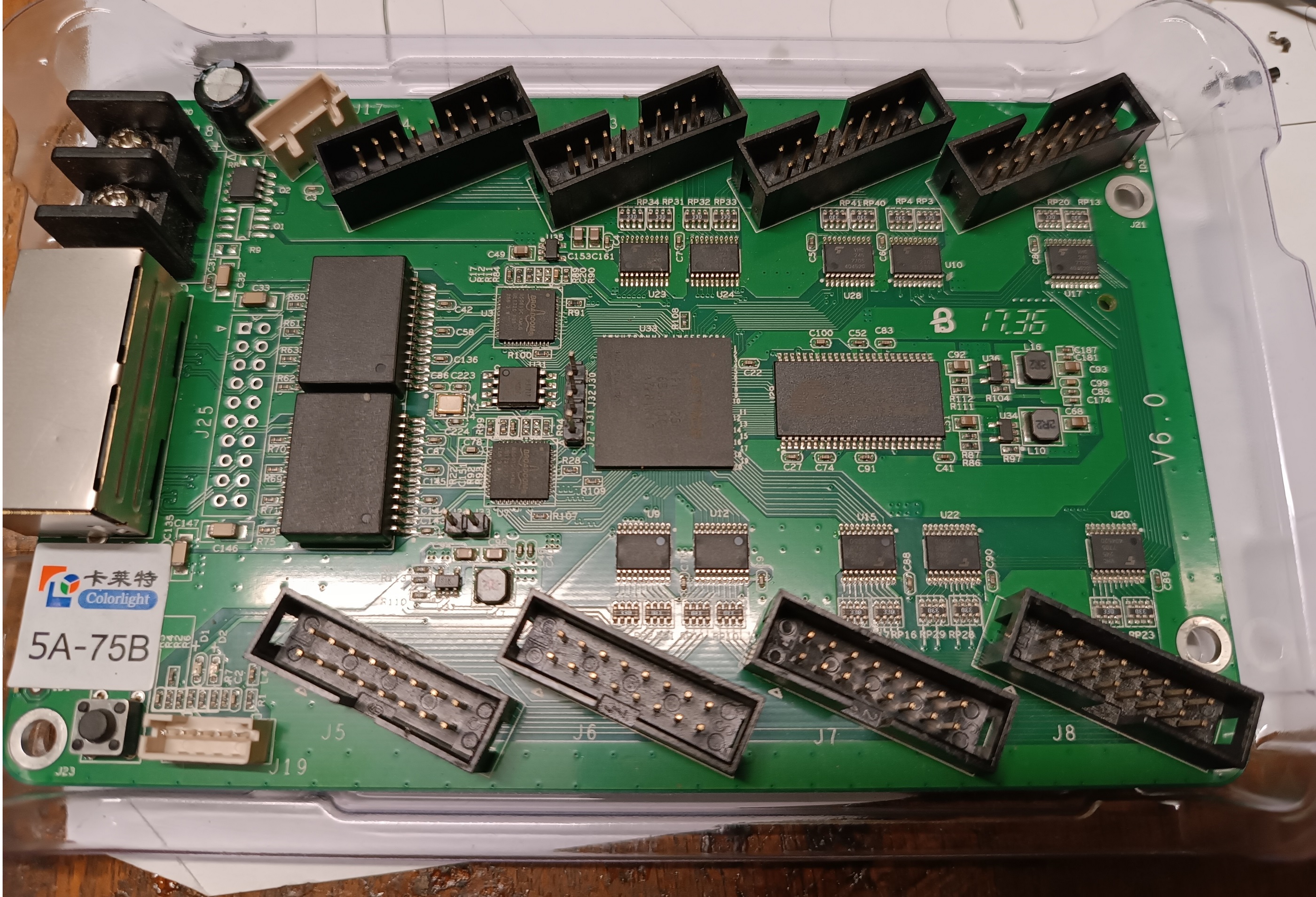

Quick question, sorry if it's a bit lame, I just ordered a 5A-75E to use for DRO duties (I may add CNC functionality in the future) on my mill, I already have LinuxCNC running nearby (for my hobby CNC), so can I just flash the 5A-75E and connect the three glass scales (I haven't bought scales yet) to it (do I need any level shifters?) and run MDRO? Thanks!
Last edit: 24 Jul 2023 09:56 by rthorntn.
24 Jul 2023 11:59 #276146
by deroj
Replied by deroj on topic ColorCNC Colorlight 5A-75E/5A-75B as FPGA controller board
There are Level shifters already in the board.
But all are configured as outputs.
You can change some, or all with bi-directional drivers, or modify the one's on the board you would like to use as inputs.
But take care about the input voltage for the fpga, 3,3V

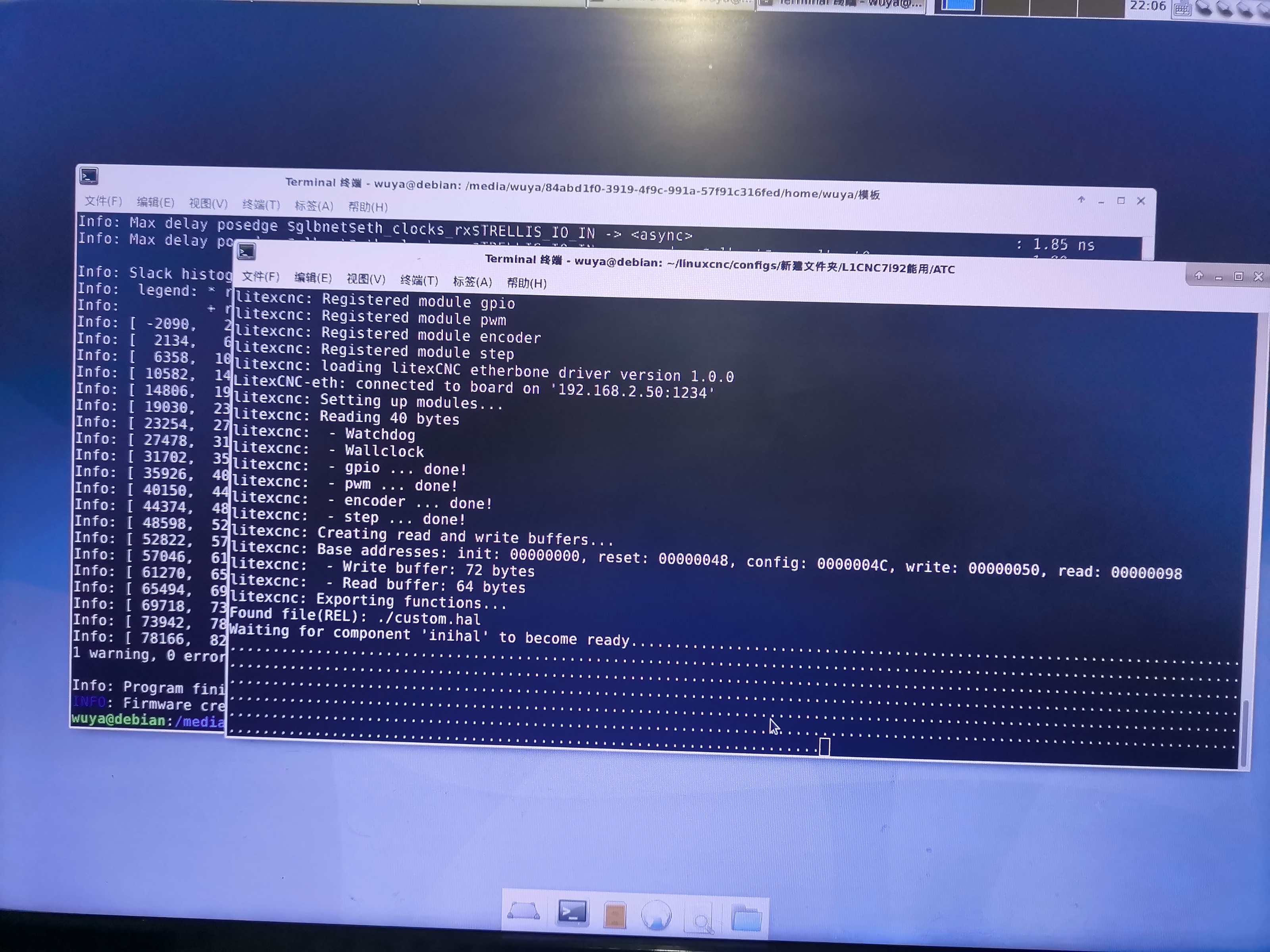

01 Aug 2023 14:21 #276700
by wuyatom
Replied by wuyatom on topic ColorCNC Colorlight 5A-75E/5A-75B as FPGA controller board
01 Aug 2023 14:25 #276701
by wuyatom
My IPL board is 5A-75E8.0, and the firmware generated with version 6.0 will be fine if you don’t add stepgen to the configuration file to generate the firmware
