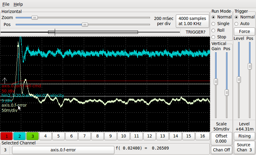

30 May 2012 13:46 #20506 by jd896
hi guys im trying to tune my axis only the x for now as the drives not come back from repair yet
but can anybody give me some clues as to how accurate the scale in the hal scope is ie what the u's and such relate too i want to know how close my error is
also what would people say it acceptable for a plasma gantry ?
thanks
30 May 2012 14:44 #20508 by BigJohnT
I guess that depends on if your torch is high-dev or just an air torch. I'm happy if my position is <0.010 from commanded and in my case that would be due to belt stretch and other items as mine is stepper driven.
axis.N.f-error OUT FLOAT The actual following error
Not much to go on in the manual for that pin, I assume your watching that pin and iirc it is in machine units. When I tuned my CHNC I triggered on velocity and watched commaned vs actual and or following error as I adjusted the PID.
John
30 May 2012 14:59 - 30 May 2012 15:01 #20509 by jd896
the commanded vs actual velocity are exact up to around 400mm/s but for small high speed jogs it shakes the gantry so ive taken it down to 250mm/s i think
so in the image the text at the side of F(0.02400) = 0.26509 does this after the = sign mean 0.26509mm?
and for now the power sources a powermax 85 till we get it burning most of the day and can warrant a fancy new hydef one
also what needs a fine tune to get that spike out is it d or ff2?
Last edit: 30 May 2012 15:01 by jd896. Reason: no photo
