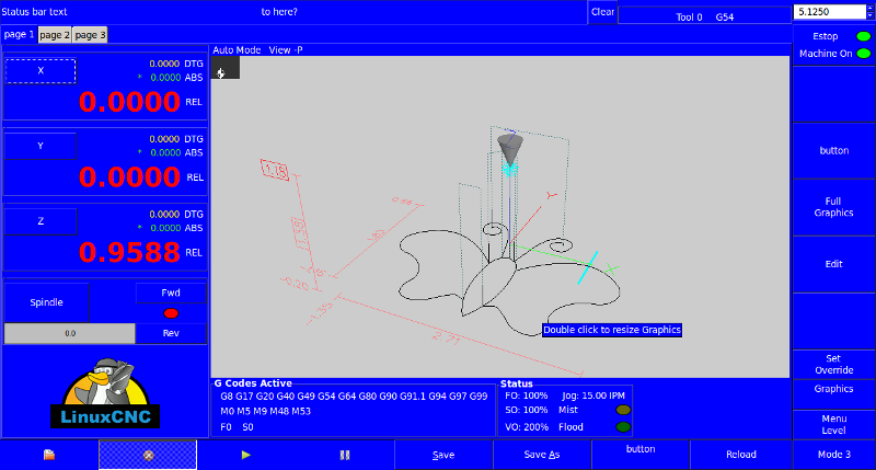

03 Jul 2012 07:28 #21513 by cmorley
Here is a sample:

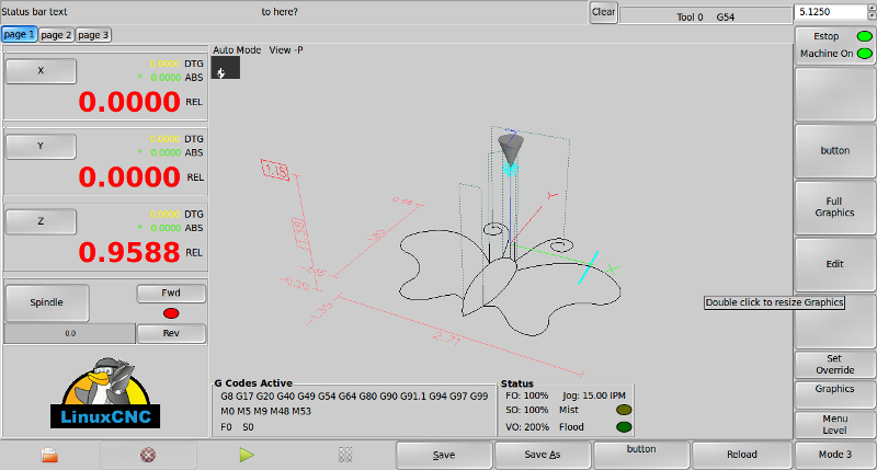

03 Jul 2012 07:31 #21514 by cmorley
and another. I'm pretty sure I could expose the colors to the Hal_gremlin widget so users could change them
but I'm not sure whether its worth it...
