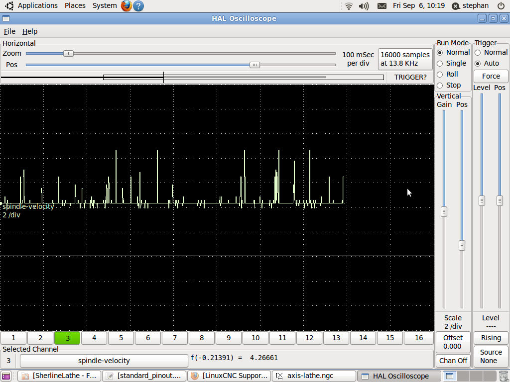

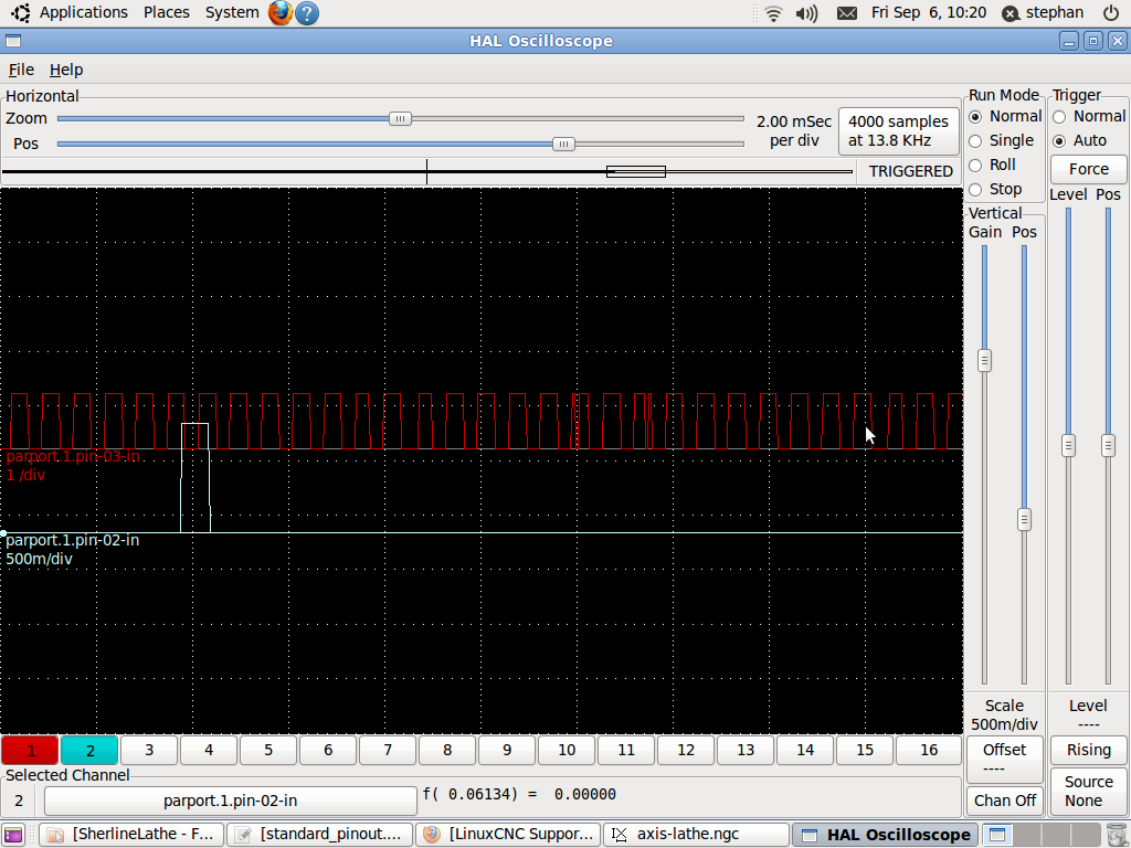

I am trying to get my spinlde feedback setup correctrly so that I can make use of closed loop control.
The problem is the spindle-velocity is not constant and jumps arround allot (Screenshot 2).
Does anyone know what I have done wrong or can do to improve the consistency?
I have a 360ppr encoder with index pin, which appear to have minimal interference (Screenshot3).
I am on version 2.5.3,
my lathe config is attached, HAL - standard_pinout.hal.
my spindle position also keeps increasing without resetting every revolution.
I have tried ArcEyes exact code and various other thing with no success.
