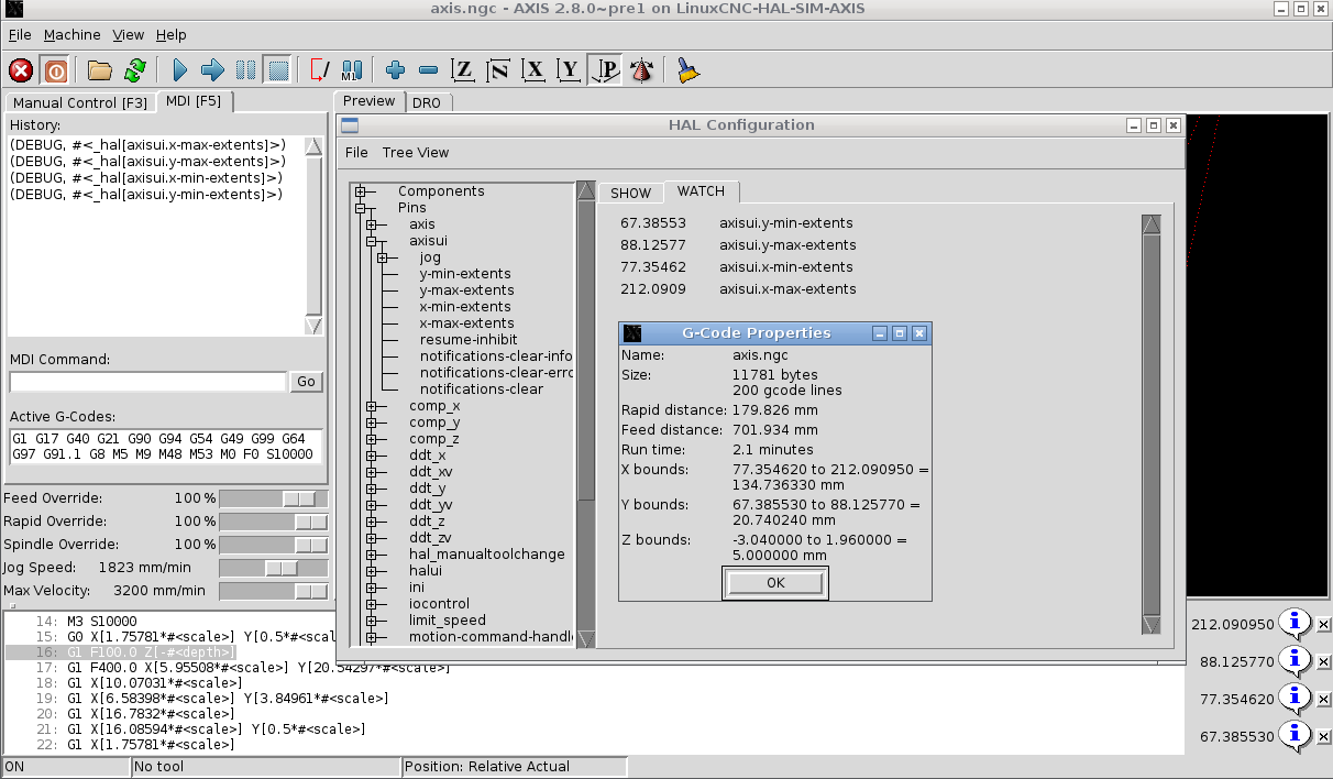

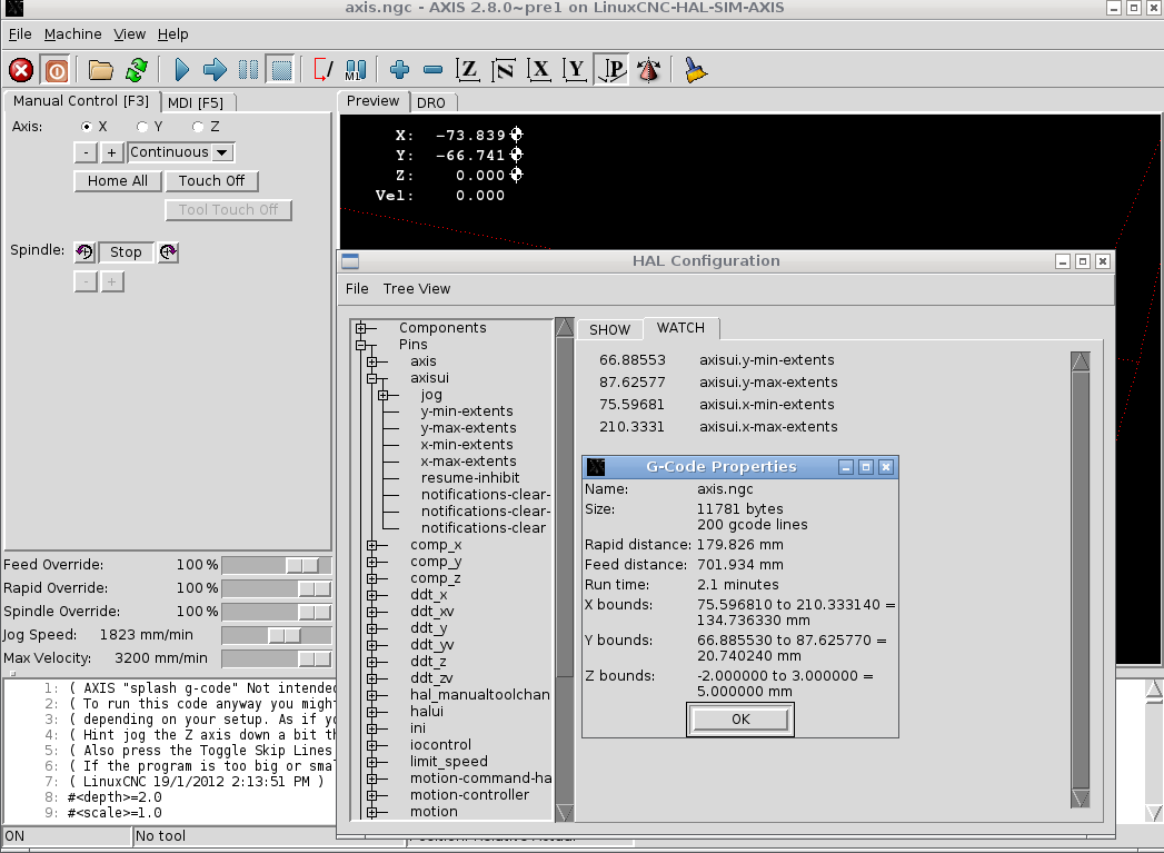

03 Jul 2015 14:06 - 03 Jul 2015 17:54 #60378
by ArcEye
Replied by ArcEye on topic Move on extents
Axis gets the extents from canon.
If you created axisui pins, say axisui.x-max-extent, axisui.x-min-extent etc, you cou copy these values to those pins and make them accessible, both though hal and directly in gcode through the #<_hal[xxxx]> mechanism
Line 1791 onwards (master)
min_extents = from_internal_units(o.canon.min_extents, conv)
max_extents = from_internal_units(o.canon.max_extents, conv)
for (i, c) in enumerate("xyz"):
a = min_extents[i]
b = max_extents[i]
if a != b:
props[c] = _("%(a)f to %(b)f = %(diff)f %(units)s").replace("%f", fmt) % {'a': a, 'b': b, 'diff': b-a, 'units': units}
properties(root_window, _("G-Code Properties"), property_names, props)
Last edit: 03 Jul 2015 17:54 by ArcEye.

03 Jul 2015 15:13 - 03 Jul 2015 18:21 #60381
by ArcEye
Last edit: 03 Jul 2015 18:21 by ArcEye.
The following user(s) said Thank You: FiliP

03 Jul 2015 17:52 #60385
by ArcEye
The following user(s) said Thank You: jtc, FiliP
