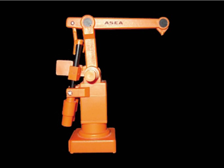

Hi everyone,
Recently I did a simulation of robotic manipulator with 5 DOF. A simulation was made in vismach, with a new kinematics definition. Now, the next step is migrate the new configuration to the physical robot with the linuxcnc advantages. But, I have a doubt with the real implementation. The inverse kinematic has the relation with the links like if each servo-motor was in the appropriate link to generate a robot motion. However, it's not like that, the motor are located away of each joint, the motion transmission is by gears and linear actuators, like you can see in the image.
I have the relationship equation of the displacement of motors in function of the angles (theta) generated by inverse kinematics computations. So, I need the motors values for the real implementation and the angles (theta) values for simulation and relationship equations.
When the *.c file is compiled, it generate the angles values (inverse kinematics):
   joint[0] = th1*180/PM_PI;
   joint[1] = th2*180/PM_PI;
   joint[2] = th3*180/PM_PI;
   joint[3] = th4*180/PM_PI;
   joint[4] = th5*180/PM_PI;
But I don't know, how can I manage this variables in the HAL file with simulation and real implementation. I think that I can add the relationship equations (motors and joint angles) in the *.c file, to compute the displacement motor values, but again I don't know how in the HAL file invoke them to generate the signals for the parallel card (who controls the motors through gecko drives). Recently, I can integrate one DOF with the simulation in vismach and one real motor, but the real application is different because the values are different too.
Thanks for your time and suggestions.
22 Sep 2015 23:06 #62863 by andypugh
If the relationship between joint angles and motor turns is linear then it is purely a matter of setting the correct scale for the step generator to give the correct steps per degree.
However, it looks like that might not be the case.
Are there encoders in the joints? (how big is the robot, it looks like it might be tiny?)
The output of the kinematics through the motion component is an angle in degrees. You could consider modifying this using the lincurve HAL component to change the steps-per-degree as a function of requested motor position. Alternatively you could modify the kinematics file to incorporate the nonlinearity.
Some sample kinematics files do include code that creates HAL pins, and makes the value available to the kinematics. it is surprisingly straightforward. This is an example from 5axiskins.
114     result = hal_pin_float_new("5axiskins.pivot-length", HAL_IO, &(haldata->pivot_length), comp_id);
 115     if(result < 0) goto error'
This creates a variable that can be used in calculations and which will always hold the value from HAL. (What actually happens is that the address of the variable is changed so that it points to a shared-memory area that other HAL pins write to).
There is a bit of complexity in that the variable must be a pointer, and is wrapped in a struct that makes is possible to hal_malloc it. This is not 100% necessary, but allows for easier expansionof the number of pins.
You can see the value being usd in a calculation here:
48     pos->tran.z = joints[2] + *(haldata->pivot_length) + r.z;

23 Sep 2015 06:17 #62872 by jstoquica
Hi and thanks a lot for the reply.
Yes, It's not the case.
The encoders aren't in the joints, are located in each motor, away from the joints. The size of the robot from the floor to the third axis (like the image) is approx. 1.2 mt.
The output of the kinematics through the motion component is an angle in degrees. You could consider modifying this using the lincurve HAL component to change the steps-per-degree as a function of requested motor position. Alternatively you could modify the kinematics file to incorporate the non-linearity.
It's right, the outputs of the kinematics are in degrees, and the results relationship equations are en degrees too. If I only want to do the movement of the real motor, just for each variable joint[0] to joint[4] will add the relationship with the motors, like this:
th1=th1*180/PM_PI;
joint[0] = (th1 - alpha1) / k1;
//where alpha1 and k1 variables of the robot, like reduction gear and offset constant respectively.
But I want to use the simulation that was made in vismach and the integration with the real robot. Therefore I think I need for that, 5 variables like joint to control the real motors and 5 variables like joint too, to control simulation motors.
I still don't understand how in the HAL file I can see the interaction with the kinematics variables (joint[0]->[4]), linuxcnc does the relationship like:
AXIS_0 -> joint[0]
AXIS_1 -> joint[1]
AXIS_4 -> joint[4] ?
I hope to make clear my idea for receive your suggestions. Regards.
23 Sep 2015 17:12 #62881 by andypugh
One option would be to modify the Vismach model to be a more exact copy of the real robot. (This might be difficult).
Alternatively, your kinematics could perform the calculation of joint angles from actuator positions (this is probably necessary anyway) and output those values to HAL. You would link these angles to the Vismach model rather than the axis.N.motor-position-cmd signals.
You probably want those output pins from the kinematics anyway, for troubleshooting.

What can I do for link the new variables irb.th# with the motion module? I think to create in the INI file 5 additional axis, but It's a rude and undesirable solution....
regards.
24 Sep 2015 04:03 #62904 by andypugh
What can I do for link the new variables irb.th# with the motion module?.
Just don't.
In the kinematics file joint[0] goes to the motion module, has backlash compensation applied, etc, then comes out as axis.0.motor-position-cmd.
You want to pass the unmodified theta value to the Vismach model, so just connect irb.th* directly to the Vismach model.
