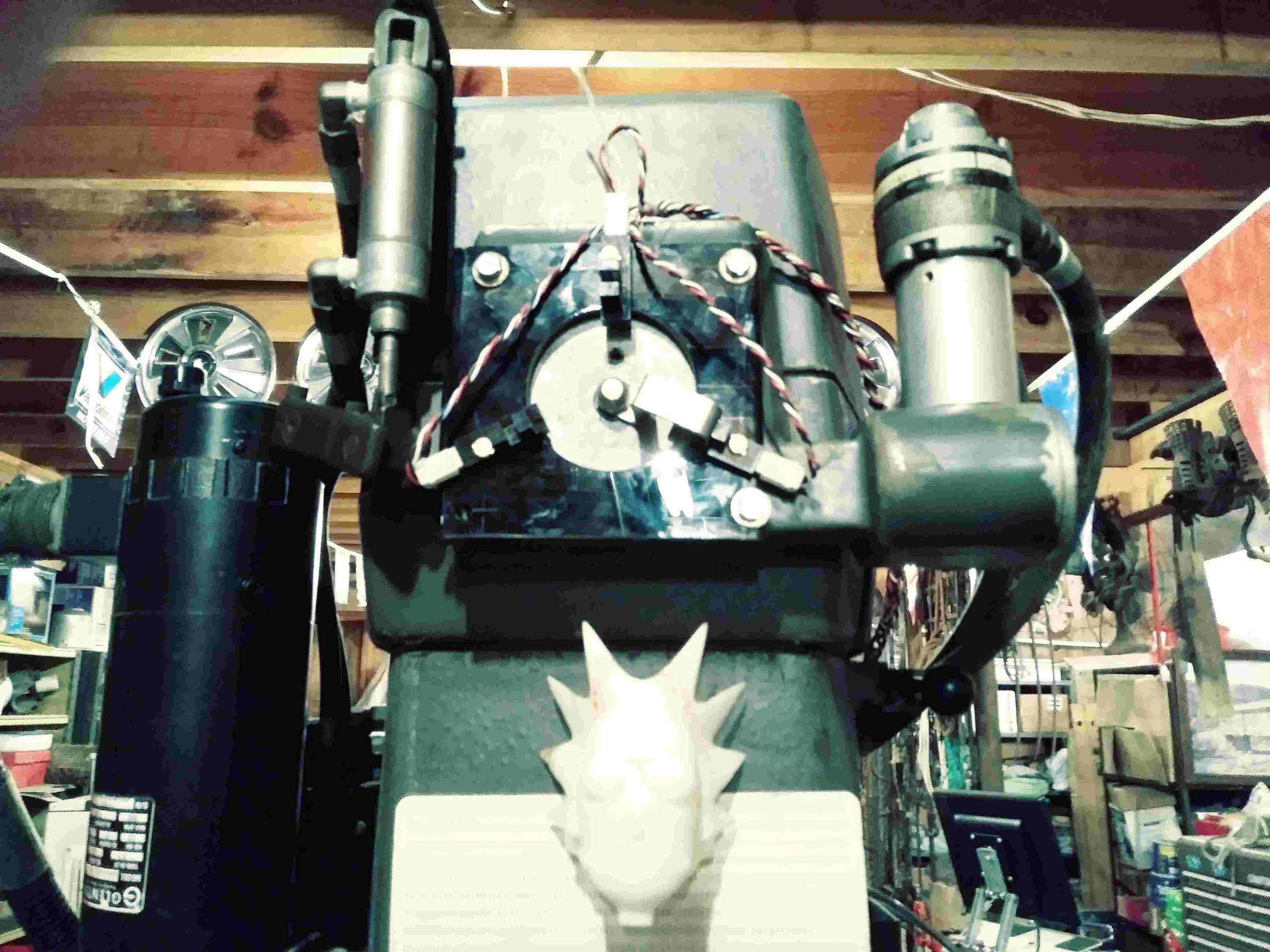

I've been tinkering and have a couple things set up.
cmorely, you would think that it would have _some_ means of at least open-loop speed detection (reading the position of the belt discs, etc), but it has nothing. The original operator panel has pretty well knackered, but looked like it had buttons for raising/lowering RPM. Apparently this was an operator adjustment. There's not even a place to mount a tachometer, so apparently it would be by reading the sight disc at the front.
I roughly set up a 3-position optical gate for detecting the range, kind of looks like a flux capacitor.
The thought right now is to set 3 ranges in my post processor (in Fusion 360, I did a similar thing for manual gear changes in my Nardini Fast Trace lathe). It will send a M101 P1, 2 or 3 to request one of those three ranges.
I've done some preliminary bash scripting, but I still need to write in something to ensure the spindle is on. I'm using serial commands for the VFD, so it would be great to have the capability to issue a serial command for 60Hz during this ratio change...

I was thinking it has some way to detect when its at either end of the limit - something that overrides the manual buttons.
I think I would make a realtime component that detects spindle on and when it's on it adjust the belt to the requested range.
bit Input: spindle on, range 0, range 1, range 2
bit outputs: speed up, speed down
s32 input: range request
Pretty close to what you have as a script but it monitors all the time.
then with your M101 you set the range request pin.
In this way it doesn't matter where the M101 is in the program, when the spindle starts the component adjusts.
Might be better to use spindle speed feedback rather then spindle on, so you know the spindle is actually turning maybe even a minimum speed.
I bet this is gonna work great!

I'm using the hy_vfd component. Within my custom.hal, I have scaled the spindle:Which worked for about the 1000RPM position on the visual RPM wheel.
Maybe I could write to this in those switch cases to set the correct scale for each one?
Also, as far as getting the scaled speed command into the VFD:Would it be a violation to just callwith a constant to start the spindle in each adjustment, thenafterward to stop the spindle? As for direction, I would assume it would use the last commanded spindle direction, which could be handy to preserve (rather than changing directions).
New (preliminary) code:
setp scale.0.gain 0.92Maybe I could write to this in those switch cases to set the correct scale for each one?
net scaled-spindle scale.0.out => vfd.speed-commandvfd.speed-command <xx>vfd.speed-command 0.0New (preliminary) code:

I looked into creating a realtime component, and I like your reasoning behind it. I think it's just a bit too much while my machine's down though. I would like to revisit it at a later time if at all possible (also placing it on github for others to use).
I tried a couple different flavors of this (one with the pins directly using getp/setp, the other with signals using gets/sets, both with some address tweaks) but I get nothing out of either. No errors, no spindle movement, nothing.
Am I doing something obviously wrong? (I'm a bad programmer!)

add this :
halcmd show pin
then run linuxcnc from a terminal, if it prints all the HAL pins to the terminal then you know its getting run
halcmd show pin

11 Apr 2020 19:03 #163677
by fungus
Replied by fungus on topic Variable pitch belt driven spindle
I addedinto the M1xx, but I saw no print of the pins or signals in terminal.
It's definitely executable, and within the search path (it will error out if not executable, and I have it in the NC file folder).
I do have a "Run" LED on the front panel I made, which blinks while in automatic mode. It cycles once when I issue the "M1xx Px" command, so it's acting like it's just shooting through without hitting any loops. I'm going to try some echos.
halcmd show pin
halcmd show sigIt's definitely executable, and within the search path (it will error out if not executable, and I have it in the NC file folder).
