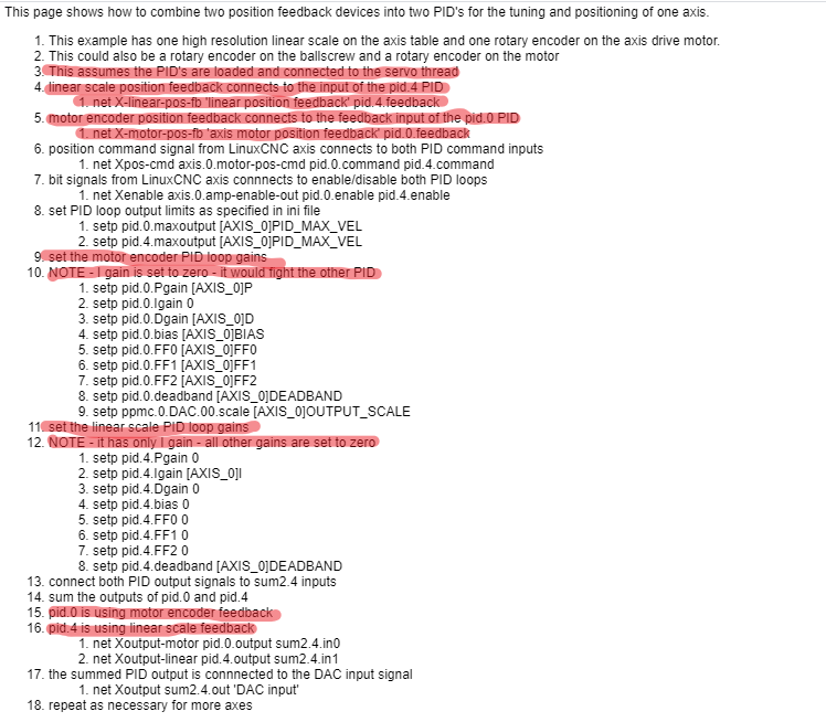

i think this was the link you were talking about and it was me
but i might be getting off track with the advanced form? Galil had some information about changing the loop for improved response time. maybe that's just with their products and not something that linux cnc can do?
one other thing was tom made reference to 1 of the 6 encoder inputs being a spindle control on the 7i77 but after looking for that in the manual i did not happen to come across it? i did not see anything about spindle control? i could have missed it? plus i thought you needed the 7i92 to connect to the 7i77? i thought the 7i85 was just an expansion card or more encoders? Mesa stuff is hard to keep track off for me since there are so many combinations of boards to use
granitedevices.com/wiki/Dual-loop_feedback_position_control

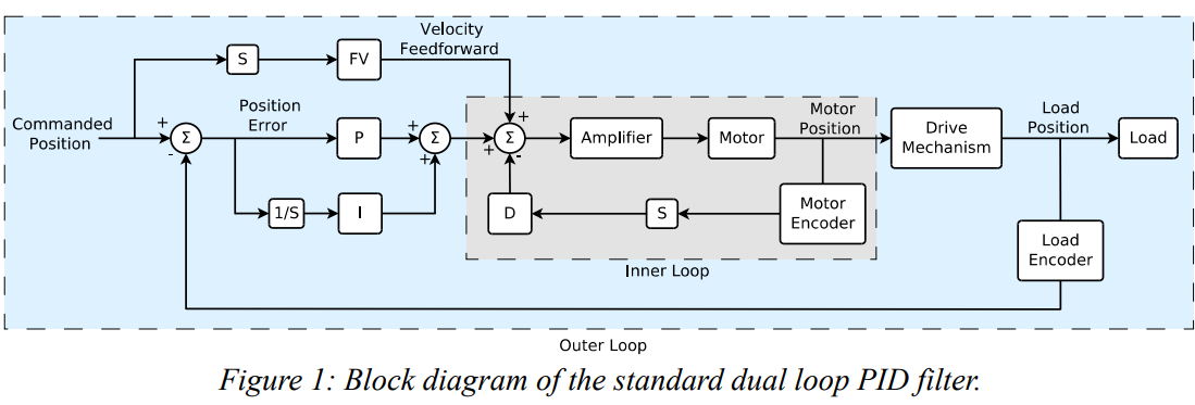

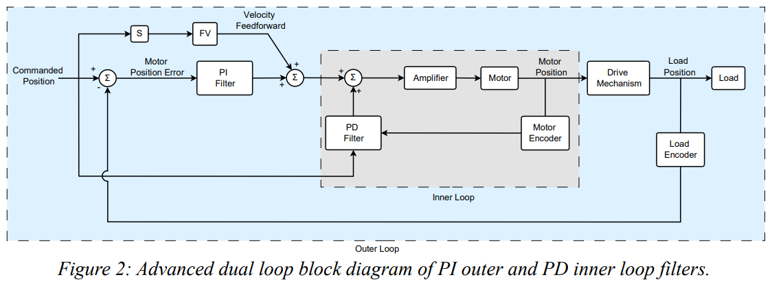

here is some more Galil information in block diagrams for a standard dual loop and an advanced dual loop set up. i'm not sure if linux cnc can do this or not? this could very well be things that only pertain to their motion control products? they have some terms that i have only seen with their stuff. so i will dig into it more and see what i can figure out.

I don't think that is really any different to the other diagram. Its just drawn with a bit more detail

OK i think i figured some stuff out that had me confused. i found something useful on here that filled in a lot of missing details. I also spent a lot of time gaining some understanding to how things tie together between the physical wiring and the software in the big PDF book on Linux cnc. i see how all the HAL files have to be assigned locations to everything on the Physical side of things. so having a better understanding of that lets me see how things fit together. the Servo thread is where the PID Loops fit into this and by only using the P & D gains on the servo motor encoder and leaving the I gain set to 0 and this will handle the inner loop and when you attach the outer loop to that servo thread you only use the I gain and leave the P & D gains set at 0. this explains how you keep things from fighting with each other. and this has to be done for each axis. knowing how to isolate the two good to know. so with out a doubt analog in speed or torque is the way to go since that would give you a stable inner loop the easiest way. so in order to do this on all 3 axis's you would need 6 interfaces for encoders so now i see why tom said you need the extra expansion. so the next question would be how to fit spindle control in this for the use of a 4th servo for that. i did look at the Mesa manuals but nothing stuck out as an obvious solution. but since things are flexible i was thinking this might be something that has to be configured on the card itself?
one other thing was if a sinking or sourcing version of board would be better for my situation. the linear encoders are push or pull so they could go either way. i still need to dig through the DMM manual and see what the encoders are on that side. simpler stuff can be wired to suit either or. spent some time understanding the difference on that topic as well
i am pretty sure i looked at LInux cnc when it was EMC a long time ago and was like holy sh!t that's complicated and ended up on the Mach 2 before it was Mach 3 band wagon as a result
now that i am a lot old i see now why Mach 3 sucks
if you want something close to industrial grade for controls.
i think i will need the 7i92 ,7i77 and 1 7i85 or 7i85s i just need to sort out the versions based on my needs first. if i am not mistaken the 7i92 is the part of the hardware that takes a lot of the load away from the computer?
here is the info that filled in a lot of the question for me.
