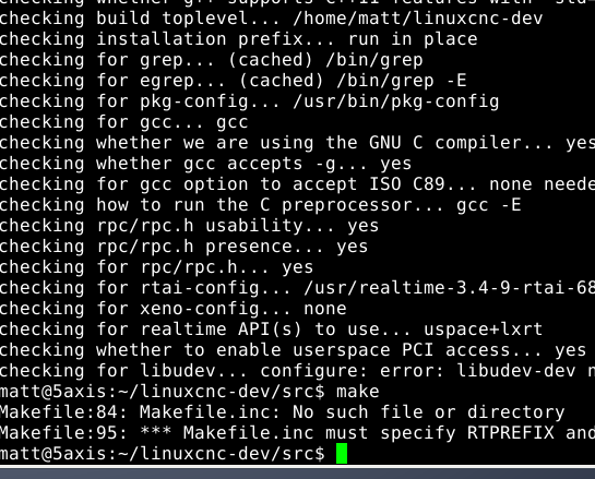

I have been trying to work out how to install switchkins and this is far as i have got .
matt@5axis:~$ cd ~/linuxcnc-dev/src
matt@5axis:~/linuxcnc-dev/src$ git checkout dgarr/s_kins
Already on 'dgarr/s_kins'
matt@5axis:~/linuxcnc-dev/src$ git branch | grep \*
* dgarr/s_kins
matt@5axis:~/linuxcnc-dev/src$ git log --oneline -1
b8bc51e switchkins: switchable kinematics
matt@5axis:~/linuxcnc-dev/src$ make -j16 sudo make setuid
Makefile:84: Makefile.inc: No such file or directory
Makefile:95: *** Makefile.inc must specify RTPREFIX and other variables. Stop.
i have tried to find information on how to do this but have not found something that i can understand. i am sure it is basic for linux users. i am very willing to learn if some-one can help.

- Posts: 22037
- Thank you received: 7505
02 Oct 2020 05:29 #184548
Replied by tommylight on topic switchkins install advice
Make -j16
Should be separate line from
Sudo make setuid
Sudo make setuid
- Mkcherni
- Posts: 14
02 Oct 2020 05:51 #184551
by Mkcherni
Replied by Mkcherni on topic switchkins install advice
no such file or directory? was i meant to have created a file location first?
appreciate your help

- Posts: 4819
- Thank you received: 2177
02 Oct 2020 12:46 #184595
Replied by Aciera on topic switchkins install advice
Are you following this?
www.panix.com/~dgarrett/stuff/s_kins_guide.txt
If so, have you successfully completed step 2?
2) To get the source code and build LinuxCNC, see:
linuxcnc.org/docs/master/html/code/building-linuxcnc.html
Learn how to build the default (master) branch first.
You must succeed with this before proceding.
The following user(s) said Thank You: Mkcherni

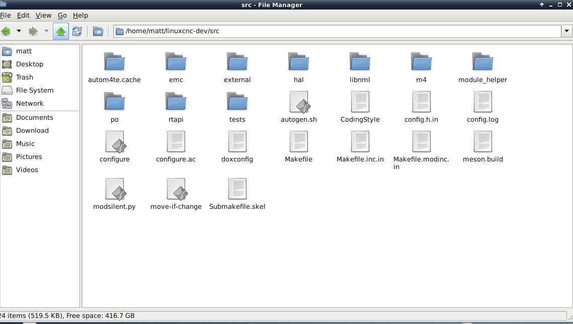

- Mkcherni
- Posts: 14
02 Oct 2020 22:36 #184660
by Mkcherni
i had come to this conclusion last night but am still struggling with building from source. i have the feeling i am close to finished but am stuck at gathering dependencies. that said it is starting to make sense as i now have a folder name linuxcnc-dev that is full of the files that i have not been able to find. i believe these are the missing .c files that i have been trying to find. i also believe these are the text files that you edit or add then compile to be written
and so become part of the executable linuxcnc.
if nothing else i am determined, and will succeed and have a history of getting their in the end.
thank you for the link. i have been trying to get this to work. i have also been referencing my heap's building form source video 018. without much luck.
