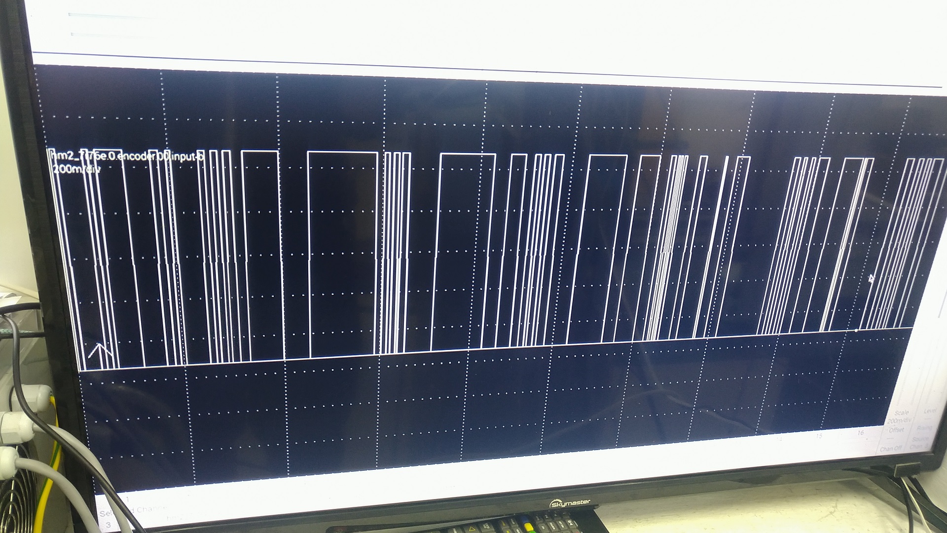

I built open-loop LinuxCNC milling machine. I tuned the axis. I decided to add linear TTL 5um encoders.
I connected 7i85s, programmed 7i76e+7i85s, mounted and connected encoders. I set encoder scale to 250 to get rig of follow error (see photos). This scale is strange as it should be something like 200 for this encoders.
When I move x axis all is fine until I stop. When I stop jog I get en error "Joint 0 following error" and the machine goes off-line. When I try to make machine online, X stepper motor tries to rotate, LinuxCNC puts immediately "Joint 0 following error" and goes off-line. To make another one-move test I need to restart LinuxCNC.
Worse case is when I try to use homing X. Then after LinuxCNC restart machine still is in homing procedure. In this case I need also to turn the mesa power off and on.
I really have no idea what is happening. I measured 7i85 voltage - 4.98V - so it's not a case. A and B readings are not good (see photos) even in 16k samples mode.
I attached HAL and INI files and HAL scope graphs

Replied by andypugh on topic Mesa 7i76e + 7i85S encoder feedback problem
You won't be able to see the scale quadrature pulses properly if your only thread is the servo thread, except at low speeds (ie, less than 5mm/S, possibly 1/4 that)
Yes, 5um scales should be 200 pulse/mm so 250 does not make sense. Is your primary scale correct? ie, do the axes actually move the programmed distance?

Replied by PCW on topic Mesa 7i76e + 7i85S encoder feedback problem
For encoder feedback I would first get open loop working properly
and the verify that the encoder position is correct and repeatable
before closing the feedback loop.
Note as Andy said, that the A/B signals displayed in halscope are not
representative of the inputs unless you are moving _very_ slow because
you are only sampling the inputs at the servo thread rate.

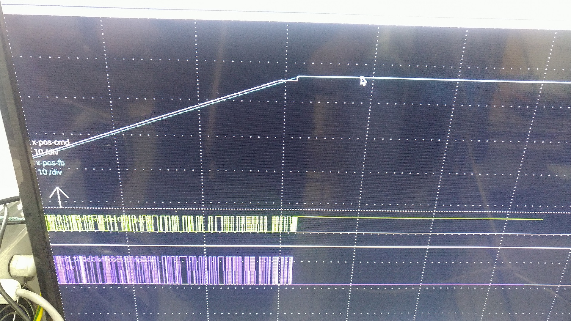

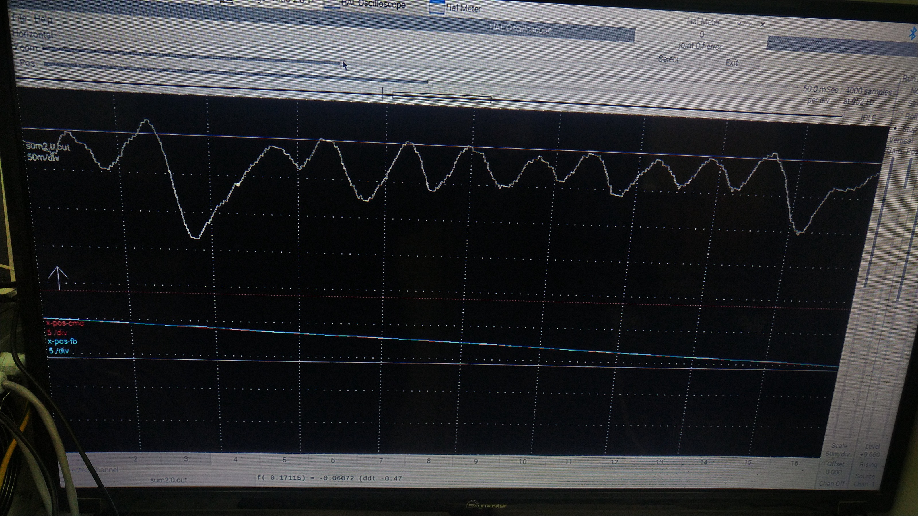

I put in attachment photo of x-pos-cmd, x-pos-fb and follow error represented by sum2.0.out signal. All looks good. Sorry that it's not a screenshot but I'm a rookie in Linux world.
Unfortunately I still have some problems:
1. even if I set in .ini file ferror =10, 100 or even 1000 I always get "joint 0 follow error". This error appears only in the moment of releasing jog button. As you can see on the photo follow error is lower that 0.2mm. No idea where is a problem.

First I'm not sure why you have the sum2 function, closed loop following error
should be handled exactly the same as open loop following error. Its simply the
difference between the commanded joint position and the actual joint position and
calculated internally. It does not need any additional hal support.
Second a P gain of 1000 is way too high for a system using encoder feedback
1000 is used for open loop systems because they are nearly perfect first
order control loops. For closed loop, I would start at 10 or so and work my way up

sum2 = x-pos-cmd + (-1*x-pos-fb) so it shows an error between commanded and current position. This error is low.
I'll try tomorrow other PID devices.
Any idea why I get follow error just after I release the jog button?
LinuxCNC already calculates this: joint.N.f-error
and this is the value to monitor as it is what is checked
for exceeding the following error limits.
Not sure why you are getting the following error, but
in any case joint.N.f-error is what to monitor.
