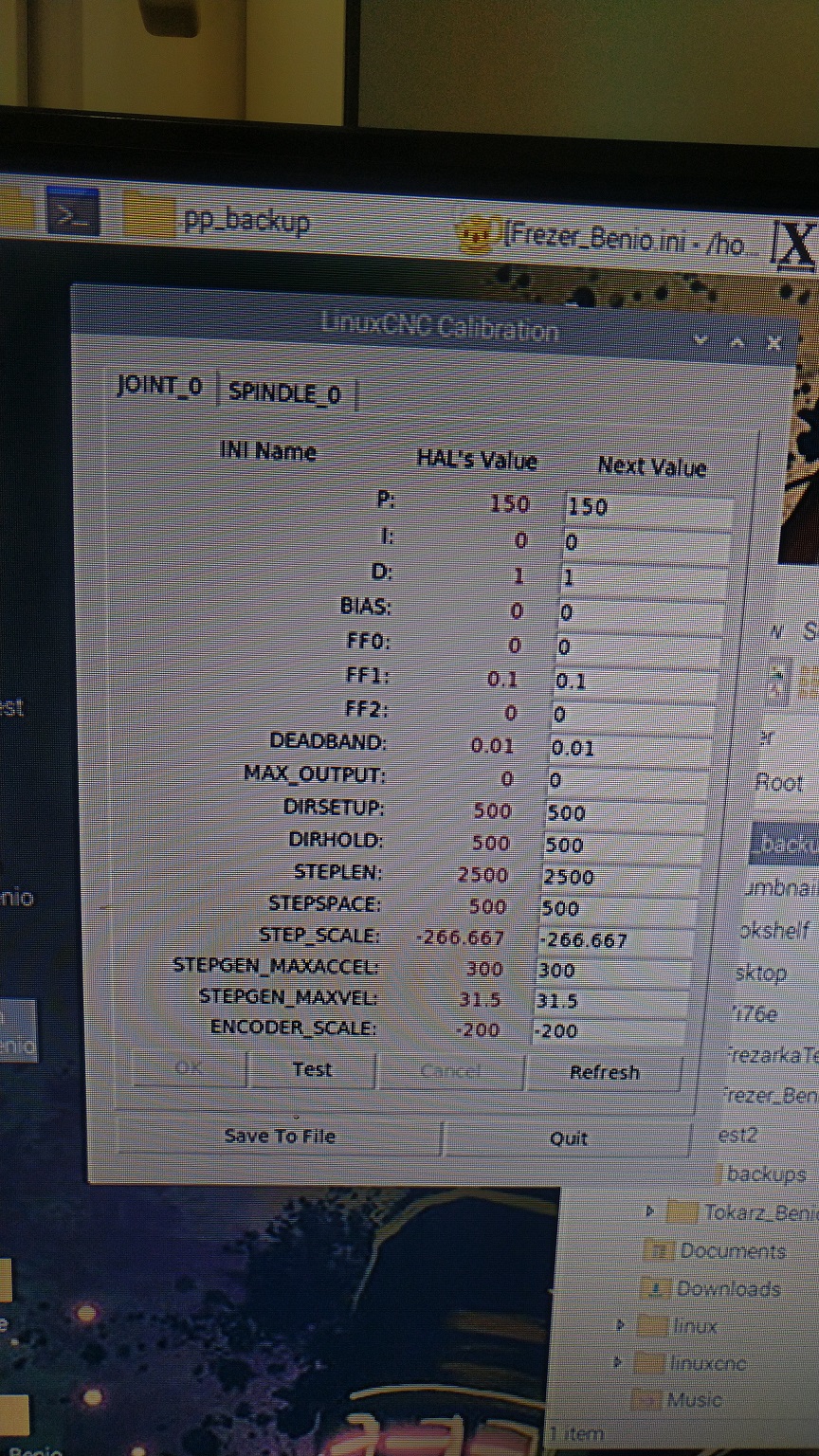

I did today some tests. I found that MAXVELOCITY parameter has crucial influcence on Joint 0 Following error. Then I hange in .ini file this parameter to 8 (mm/s) system starts to work much better but slowly. When I did tests in pncconf I got 25 mm/s (1500mm/min) so I have no idea why I need to slow the speed to 8mm/s.
I have used calibration tool. STEPGEN_MAXVELOCITY has no influence on speed. PID parameters only matters when I set MAXVELOCITY to 8mm/s. How do you think where is the reason that I need to set speed so low?
Here is my Configuration tool screenshot:

Hi, I have linear encoders on my stepper motor milling machine.
I see some things in the PID screen.
FF1 should be 1. When you set this to 1 and P I D to 0 0 0 you basically have a stepper motor system without feedback. It should work fine with only FF1=1. Use velocity mode. FF1 should always be 1, don't ever change it.
Then to gradually start reducing the following error, start with P=10 or maybe even P=1 and gradually increase P until ferror overshoot and there is vibration in the following error. Use halscope as you have done. Let I and D be 0 until you have P dialled in. D can get a value of you like, but if you set I there will be a constant search back and forth around the zero position that never stops. So let I=0.
I have P=40 and D=0.025
You can increase STEPGEN_MAXACCEL and STEPGEN_MAXVEL to ridiculously high numbers, I have 2000000 and 800 respectively. It allows stepgen (I think) to react as fast as possible to output extra steps needed to compensate for error. MAX_VELOCITY and MAX_ACCELERATION are 70 and 250 thats what my machine likes.

Hello again!
I did some mods in PID controler and finally it works much better. Unfortunately follow error shows from time to time. I realized that backlash of my Chinese mill is huge - 0.4mm! I think this could be additional reason that follow error appears. I will do next tests after making new drive nut on lathe.
My question now is about Stepgen_maxvel and Stepgen_maxaccel. Whtat is correlation between them and maxvel and maxaccel parameters? What these parameters change in PID?
Thank you for your support!

The stepgen maxvel and maxaccel number should be about 25% greater
than the joint values (to allow some headroom for the PID to operate when at
max joint velocity and acceleration)
