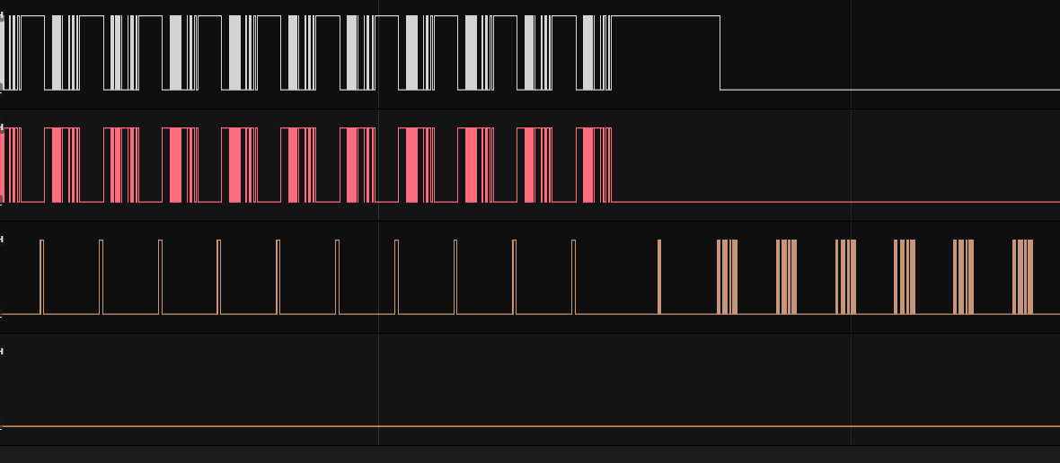

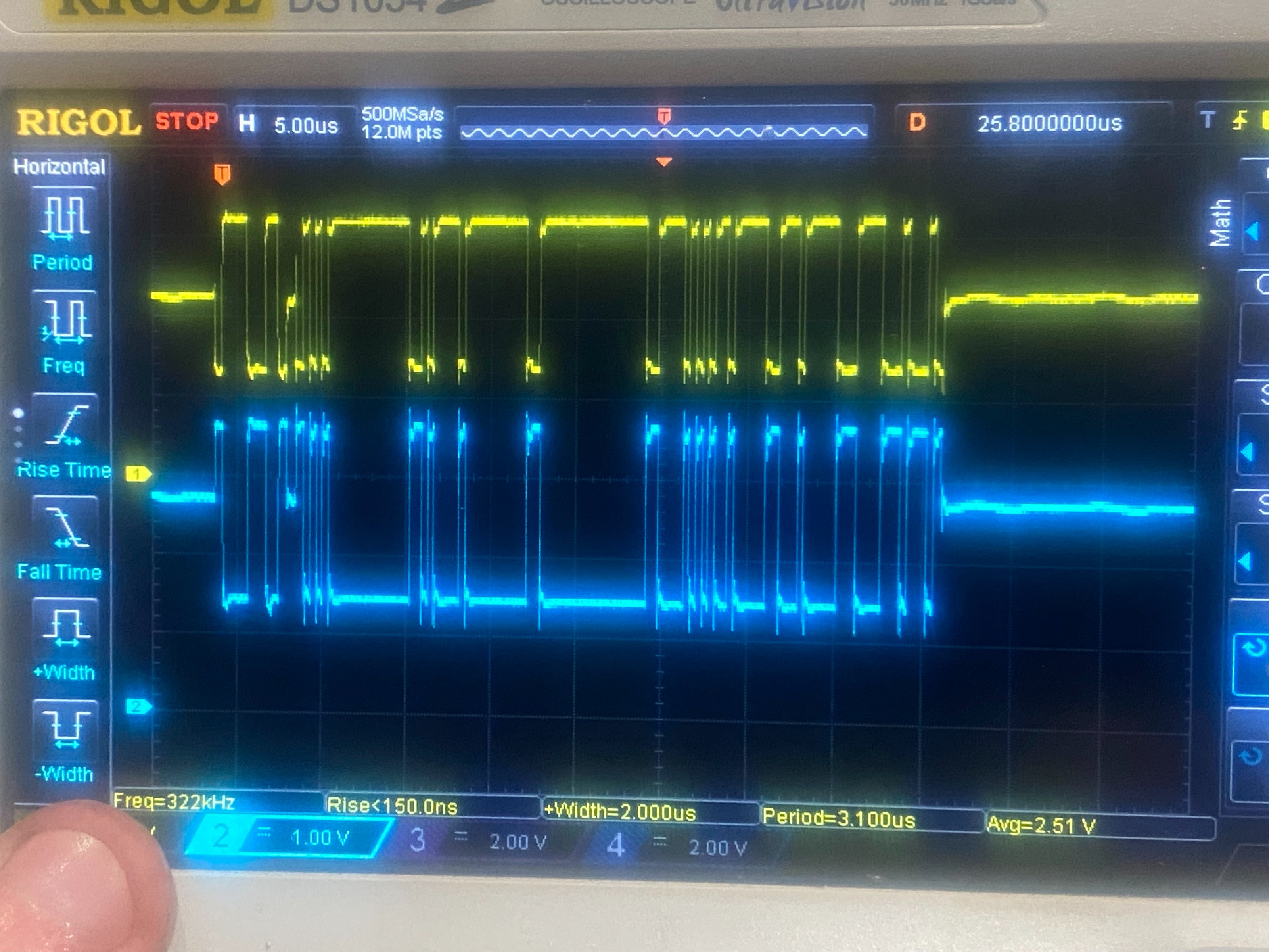

16 Nov 2021 18:16 #226667
by ExcessiveO
Replied by ExcessiveO on topic Fanuc ABS encoder data transmission not complete
So I have ran into more issues. I got the A64 encoders I have working with the standard configuration(request pulse then data out on separate pairs). Unfortunately the robot only has connections to the request pair. This ended up adding quite the challenge. I am thinking the encoders are designed to be backwards compatible and therefor still work with the regular request pulse. I looked at the captures between the original fanuc controller and the encoders and now realize it only uses a single pair to communicate both directions(so rs485) and it uses 2Mhz instead of 1Mhz. I believe the controller still needs to send a request signal but it is instead ~8 bits rather than a single pulse.
I'm thinking the easiest fix would be to connect the rx and tx lines of the encoder together then modify the existing fanuc configuration to handle the drive enable pin. Other than that, I'd either have to find a way to output a custom request byte and change the data reading format, or run a bunch more wires through the robot, neither of which I am too excited to do...
I attached the logic analyzer output which shows the encoder data pins on the top and the encoder request pin on the bottom. This is the very beginning when everything is turned on.
The scope picture is of the request lines after everything is running, notice the signal goes back to floating after the first few bits, this leads me to think the first few were from the controller and the rest are the encoder data.
Any suggestions on what would be the best way to go?

16 Nov 2021 18:40 #226671
Replied by PCW on topic Fanuc ABS encoder data transmission not complete
I think I have a similar FANUC encoder (though its 2 million count/turn) but 2.048 mbits/sec and RS-485. I bought it years ago to add support but never did. It should not be terribly difficult to add support. It looks like the request data is perhaps a single byte with a start bit
and stop bit.
The needed firmware things would be:
Request char send /RS-485 drive ENA logic
RX data masking during request
Driver changes would be to enable the RS-485 mode
and set the request char
and stop bit.
