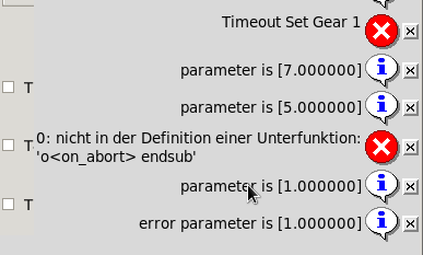

Is it possible to set an motion.analog-out-xx pin to 0, wenn starting the machine?
I remap an gcode and set in an owert-function an motion.analog-out pin to an value x.
If an error occurs an estop will be triggert. But anyway the motion.analog-out pin remains on
the value x.
the value x.

Thank you! That is what i searched for and it works as expected, but when switching on the machine, i got the error:
0: nicht in der Definition einer Unterfunktion: 'o<on_abort> endsub'
(or
0: not declared in a subroutine: 'o<on_abort> endsub' )
In my INI-File:
[RS274NGC]
REMAP=S argspec=s ngc=s
in on_abort.ngc:
o<on_abort> sub
(DEBUG, parameter is [#1])
o100 if [#1 eq 5]
(machine on)
o100 elseif [#1 eq 6]
(machine off)
o100 elseif [#1 eq 7]
M68 E0 Q0
(estopped)
o100 elseif [#1 eq 8]
(msg, abort pressed)
o100 else
(DEBUG, error parameter is [#1])
o100 endif
o<on_abort> endsub
m2
What do i wrong?

- Posts: 19904
06 Feb 2023 18:20 #263881
Replied by andypugh on topic Setting motion.analog-out-xx to 0 when starting the machine
As an ON_ABORT subroutine, or manually?I tested your on_abort.ngc without error.
