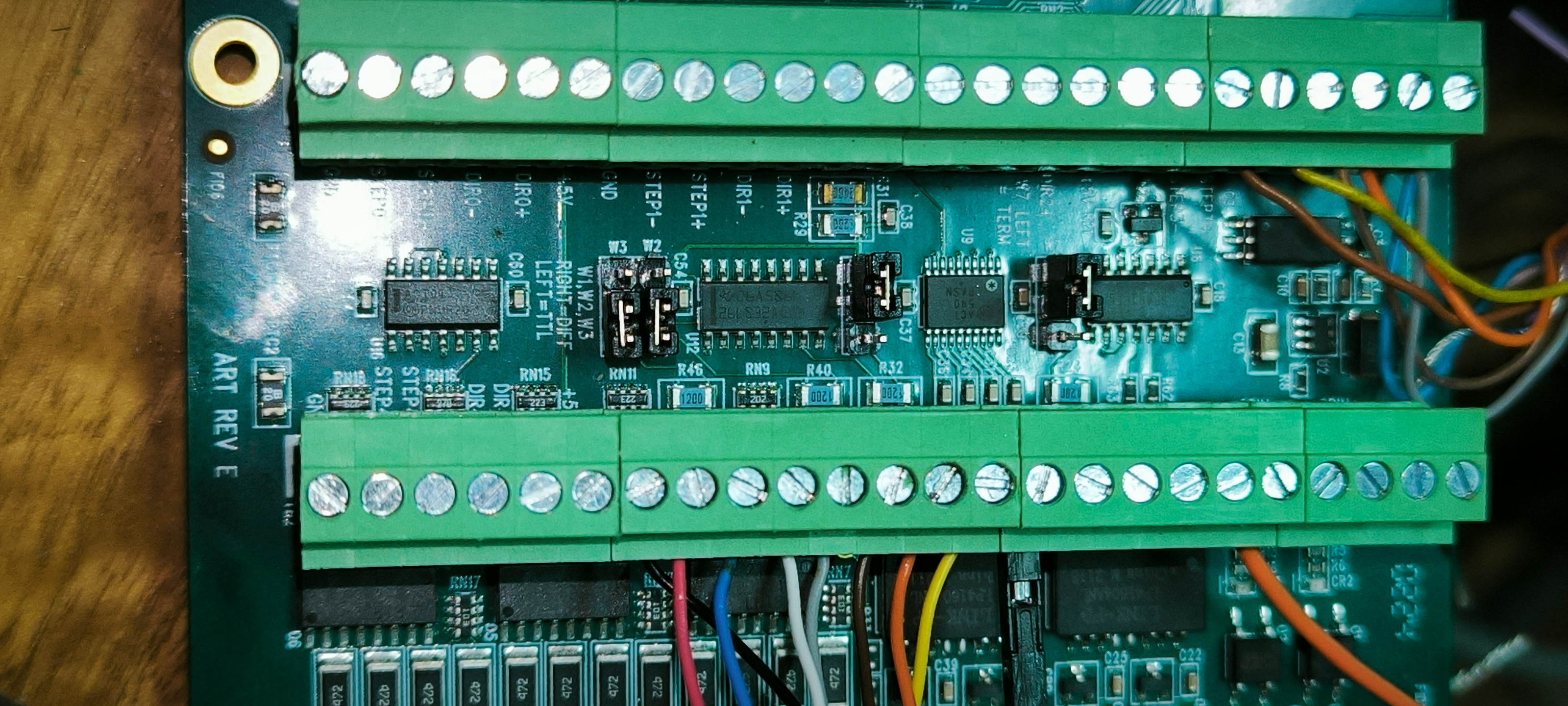

- I get a tracking error. the scale of my encoder is correct on my B axis display

Replied by PCW on topic I get a tracking error. the scale of my encoder is correct on my B axis display
That points to hardware issues, are you sure:
The index wiring is correct.
The encoders actually have an index output.
- JackRay
- Posts: 212
- Thank you received: 14
23 Jun 2025 17:08 #330762
by JackRay
Replied by JackRay on topic I get a tracking error. the scale of my encoder is correct on my B axis display
My wiring is good. I followed the MESA7i96s documentation. I think everything is correct.
I've tested 5 RS-422 encoders with phase A+,A-,B+,B-,Z+,Z-. Or maybe my MESA board isn't working properly. I don't know how to get out of it
- Posts: 18829
- Thank you received: 5200
23 Jun 2025 18:38 #330763
if you:
1. Disconnect the encoder
2. Change the index input to TTL mode
(W1 left)
3. With LinuxCNC running and halshows "Watch" tab showing
hm2_7i96s.0.encoder.00.input-index, does the state of
hm2_7i96s.0.encoder.00.input-index change when you ground
the IDX+ input (TB2 pin 13)?
(W1 left)

24 Jun 2025 17:16 #330808
by JackRay
So, my signal goes to true, but doesn't return to false once the wire is removed from GND. moreover, it doesn't happen every time. sometimes it works, sometimes it doesn't?
- Posts: 18829
24 Jun 2025 17:48 #330810
Is the index input jumpered for TTL MODE? (W1 left)
Unless this is done, the results will be unpredictable.

25 Jun 2025 17:38 - 25 Jun 2025 17:42 #330868
by JackRay
So, when I insert the wire into pin 13, the signal is on “Fasle” and when I remove it, the signal is on “True”. Without connecting Z to GND
