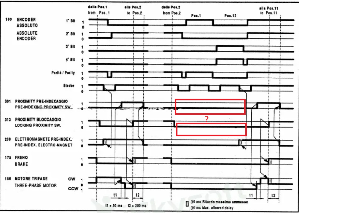

I have a sauter SK-501 turret.
I managed to find the function diagram, see below.
My questions are as follows:
- I haven't been able to find much about how the strobe pin works. What is it used for in an encoder?
-The diagram shows that the strobe signal is used to continue the tool change procedure.
Does courousel9.comp manage this on its own (does it have a signal out that I can use?), or do I need to use carousel.N.strobe to count the number of falling edges between my current tool and my next tool in my HAL file?

A strobe signal is normally used to indicate that the
other signals are valid (so should be latched/captured)

The strobe pin serves to indicate that the position of each tool is valid, this pin on the carousel enables the carousel pin. ready and serves, for example, to stop the rotation of the motor. The pin of the pre index control proximity sensor is used to activate the pre index solenoid, which must be activated when the pre index sensor signal is activated. I don't know what the exact model of your turret is. I have a TOE 100 turret that is very similar to yours. The diagram that I publish is blurry and cannot be seen well.

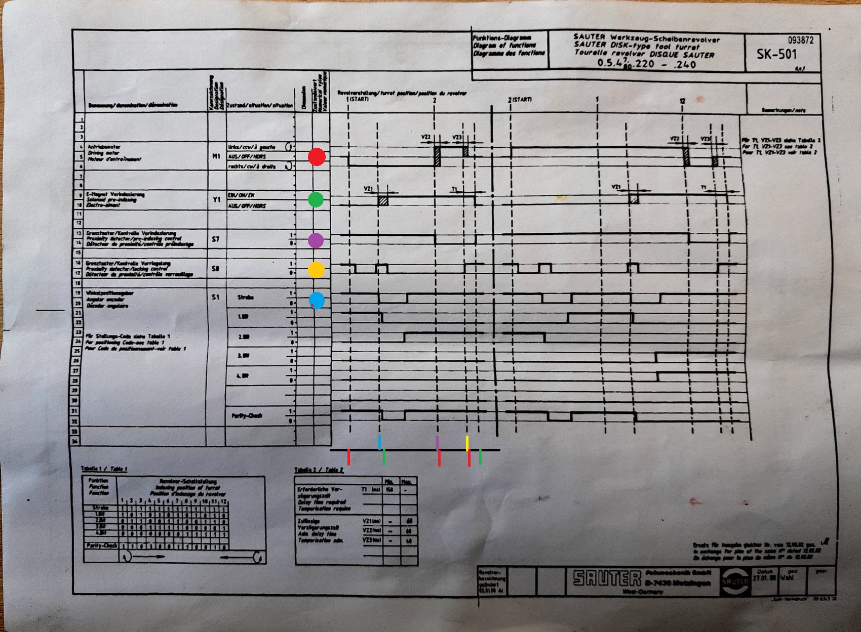

I think I'm wrong, yesterday reading your turret manual carefully I thought that it works the same as the TOE100, the difference apparently is that yours does not have a brake. I sent you my configuration, the difference is that your encoder has an additional output for the parity bit, mine does not have it because they changed the encoder for one with a gray output.

thank you for your hal, yes I confirm the diagrams of our two turret are identical.
here is the diagram of my turret in better quality to avoid hurting your eyes
red : motor
green . solenoid
purpel : pre-indexing control
yellow : locking control
blue . strobe
i will check your hal and i come back to you for sure some questions !
red : motor
green . solenoid
blue . strobe

after reading the hal file, i have a few questions.
why use a gray encoder when your code table encoder is binary?
you activate the solenoid when the selected tool is in activate position whereas the schematics show that the solenoid activates at the last falling edge before the selected tool. is it too complicated to program this? or is your solution sufficient?
you only have one direction of rotation, is it too complicated to use mux to manage reverse directions of rotation to block the turret?

I used gray code, because the turret I have is used and did not have the original encoder and that is why I manufactured my own encoder and I did it with gray which has the advantage of not needing a parity bit to verify the correct reading of the position as if A binary encoder needs it. The tool holder disc is locked internally with a disc with "nails", this disc retracts when the motor begins to rotate, releasing the tool holder disc and it begins to rotate, when the desired position is reached the preindex sensor is activated, This causes the solenoid to activate and it locks this disc with nails and in turn, reversing the direction of the motor causes this locking disc to move forward and so on. Lock the tool holder disc. Regarding using the bidirectional rotation, I have not tried it, unfortunately the carousel component only reverses the rotation of the motor automatically when the motor rotates forward, but when it rotates backwards, it does not reverse the rotation automatically, that is why I do not do it. I was able to implement, and the truth is I have not found how to save the initial direction of the rotation, to determine which way the motor should rotate later. In another thread I wrote to Andy, who was the one who created that component, to see if he could help me with the bidirectional solution, but I didn't get a response.
