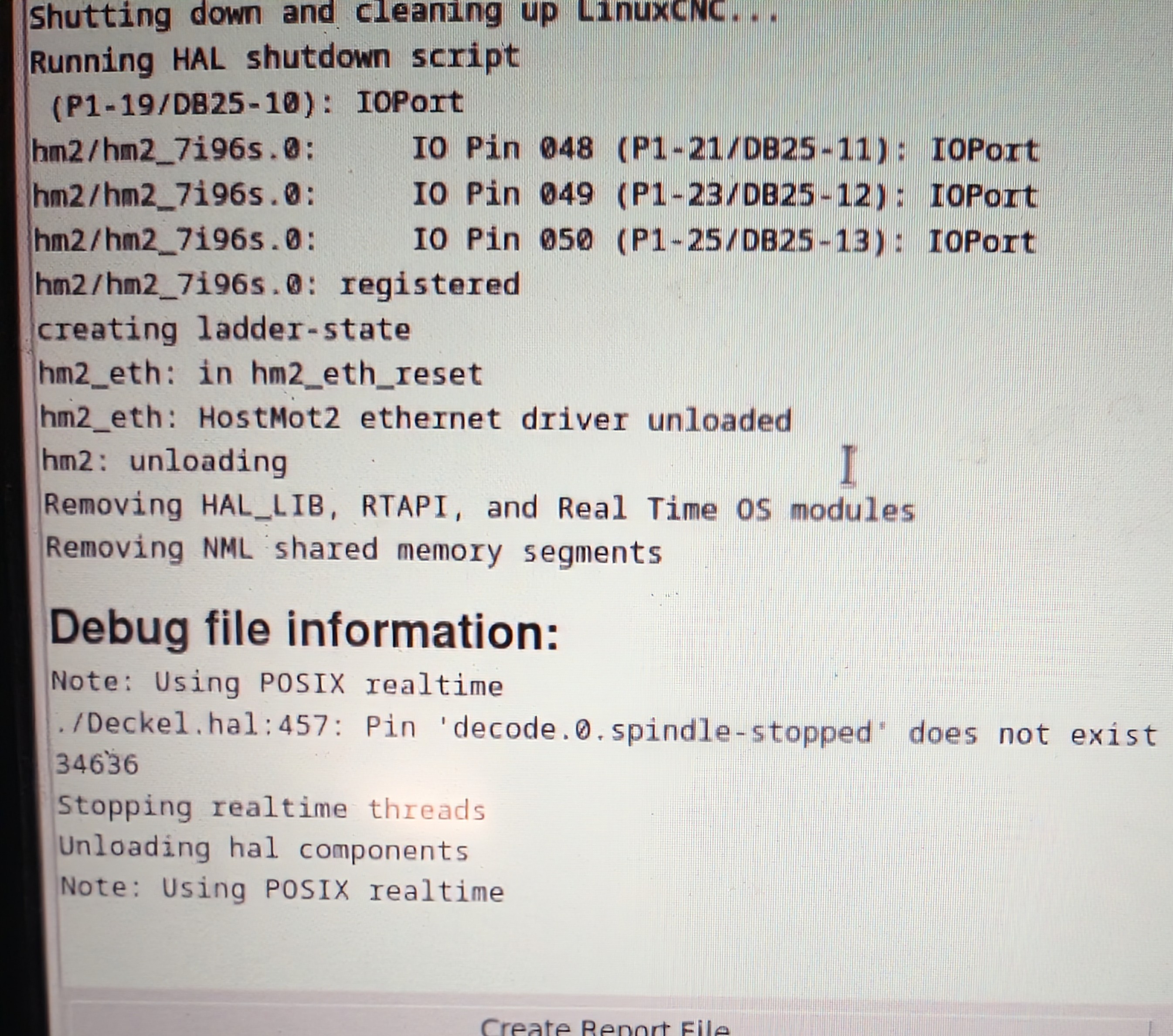

However once i had changed all the pin outs to suit my wiring i was unable to open linux CNC as it was throwing errors saying it was unable to find certain pins (i.e. the decode)
I tried opening the ladder program once i reset the hal as it comes straight out of PNCConfig but it seemed to be missing variables/pins as they were replaced with ????  (could be related the the hal??)

20 Jun 2024 08:23 #303415 by Aciera
Replied by Aciera on topic Deckel FP4 Gearbox Comp
That is because 'decode.' pins are created by a custom hal component called 'tumbler_decode'
This is from the 'Deckel.hal' file in the post you linked:
loadrt tumbler_decode names=decode.0
addf decode.0            servo-thread
For this to work you will need to install the 'tumbler_decode.comp' from the original zip folder.

21 Jun 2024 06:09 #303482 by Walkahz
Replied by Walkahz on topic Deckel FP4 Gearbox Comp
Installed the tumbler_decode.comp and still getting an error.
Have checked it's included in the hal.
21 Jun 2024 06:41 #303487 by Aciera
If you have these two lines in your hal:
And you are still getting an error then I would comment out all the hal lines that contain 'decode.0' pins to get linuxcnc started and then use the 'show halconfiguration' tool to check that the 'decode.0' component is actually loaded and what pin have been created.
