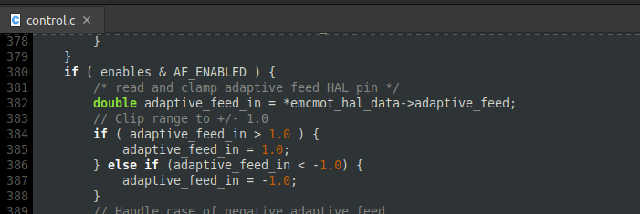

I am using the motion.adaptive-feed to control my feedrate. The linuxcnc manual states:
"When adaptive feed is enabled with M52 P1, the commanded velocity is multiplied by this value. This effect is multiplicative with the NML-level feed override value and motion.feed-hold. Negative values are valid and will run the G-code path in reverse."
While trying this out, it only seems to work for the range -1...1 any values above or below that are clipped to 1 or -1.
I need to be able to set the value to greater than -1, e.g. -10 or greater. Is this possible and how can that be done?

- Posts: 4819
- Thank you received: 2177
11 Oct 2024 08:19 - 11 Oct 2024 09:20 #311808
Replied by Aciera on topic motion.adaptive-feed range problem
Last edit: 11 Oct 2024 09:20 by Aciera.

11 Oct 2024 08:37 - 11 Oct 2024 08:42 #311809
by snowgoer540
Replied by snowgoer540 on topic motion.adaptive-feed range problem
I wonder if there was a functional reason this was clipped to +- 1?
Edit: I’ll reach out to the author for that commit and see if I can get an explanation. The commit details explain the negative stuff, but no reason as to why 1 was choosen in either direction.

12 Oct 2024 23:43 #311923
You could set your programmed feed rate to double and set adaptive feed to .5, then you could ramp up and down in feed rate.
Replied by cmorley on topic motion.adaptive-feed range problem

13 Oct 2024 05:32 - 13 Oct 2024 05:37 #311944
by BaxEDM
Replied by BaxEDM on topic motion.adaptive-feed range problem
Yes, I considered that too, but that is a work around not really a nice solution. For instance I want my customers to be able to set a feedrate which makes sense, e.g. that is in the same order of magnitude as the actual expected cutting rate. However the incidental retracts need to be much faster.
The workaround approach would then be to set the desired feedrate two orders of magnitude greater that the expected feedrate, just to cope with the -1...1 limits of motion.adaptive-feed. Doable but not intuitive for my customers.
Also, setting the feedrate two orders of magnitude higher than the expected feedrate requires modifications to my feedrate control loop depending on the material and thickness. This would require an additional dail for my customers to tune, I do not want that. The simpler the better.
Up until now I managed with the -1...1 limits, but I think the control can be much better without them.

13 Oct 2024 10:31 #311977
by spumco
Replied by spumco on topic motion.adaptive-feed range problem
Refining @cmorley's suggestion...perhaps you could use two scale components to manage the adaptive feedrate.
Step1: scale.0.gain => programmed feedrate down to -1/+1 range
Step2: feedrate adjustment based on arc voltage
Step3: scale.1.gain => back up to desired output
The operator/programmer, as well as your control loop, wouldn't see the backstage math fiddling. I know it's not 'elegant', but should be easy to do in HAL until someone can edit the adaptive feedrate programming.
