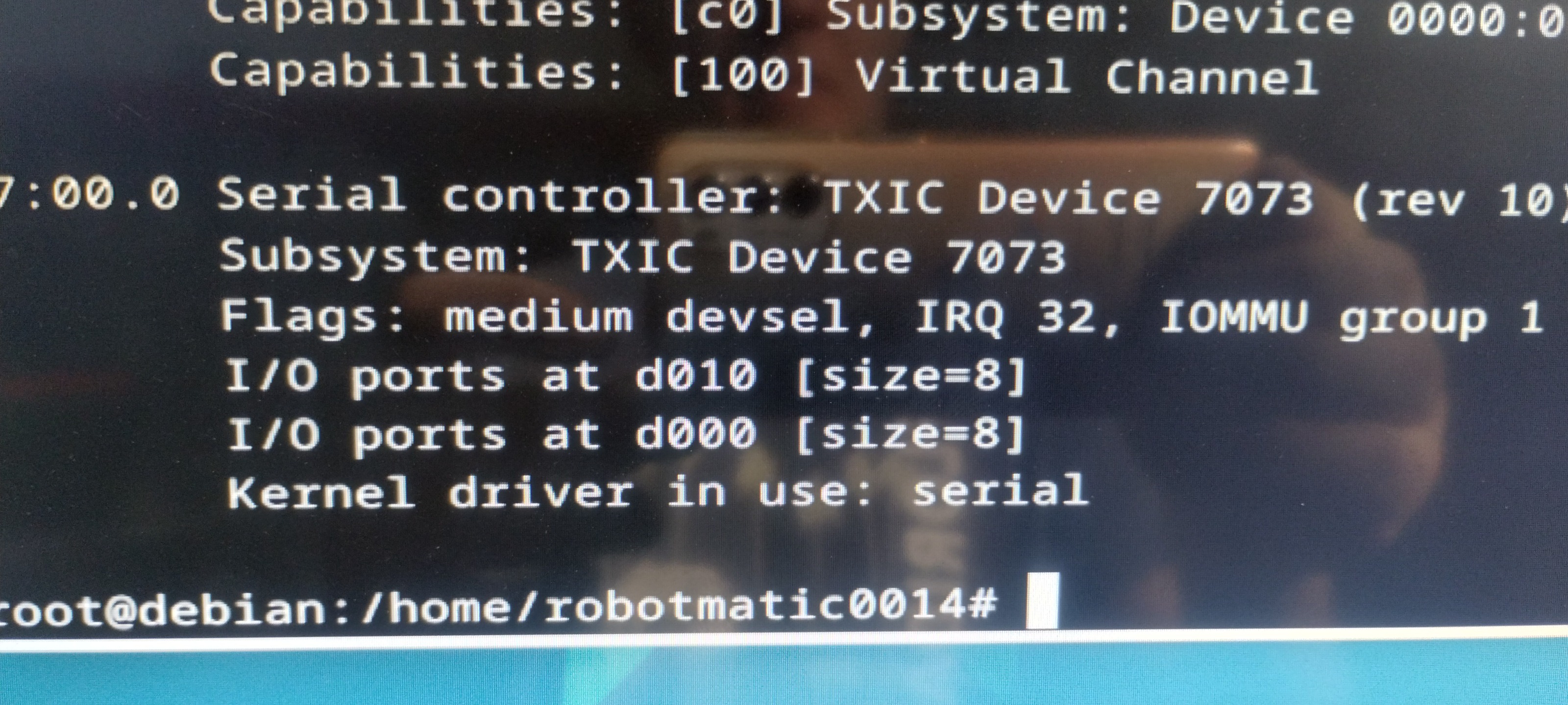

the point is that Linuxcnc does not find a parallel port, it finds a port that it can use but the kernel driver defines it as serial, it does not matter what is the capacity of the micro that uses the PCIE board, nor does it interest all the capabilities that you mention. Linuxcnc does not know how to solve the situation and gives us an alarm with a dual message, everything works perfectly, we are the ones who have to follow. I'm asking if you can somehow eliminate this situation of alarm or Dual message, I'm not trying to discuss technology, Nothing in the cpus works in Parallel, everything is serial, if you think differently perfect, I have no problem with that, but please don't deviate the reason why this thread was created in the forum. Thanks a lot.

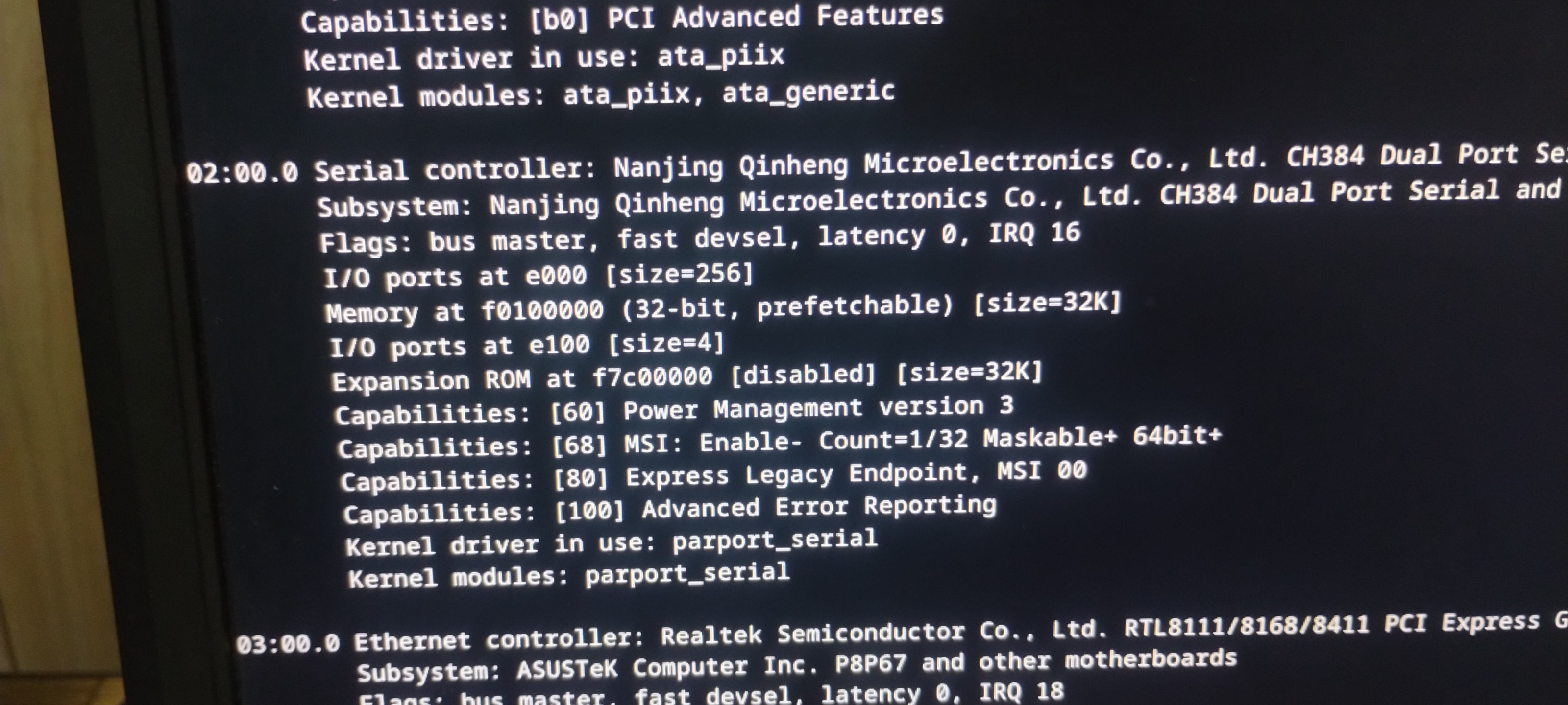

Watching RoboMatic's pictures it just dawned on me, the normal PCI ports use one of the 16 IRQ's (FYI PC has 16 IRQ from 0-15) but this in the picture is 16 and still shows like a normal IRQ, so i wonder.... but the other one is IRQ32 and in a group of IOMMU so it has no memory address.
Also most probably lack of DMA access might be triggering the warning...
This needs more testing, whenever i get a chance, and whenever i get more PCI-E ones as i am out of those for now.

Hmmm, if it works, i am sure LinuxCNC can find it as parallel port, the driver in use being serial is strange if there is actually nothing serial on the board, but from experience most of those boards do show as serial and parallel or both, despite missing serial ports.
I would aim at missing "driver in use" when the error appears...

The IRQ32 plate is the one that triggers the ALRMA

What if you try 0xD010 ?
