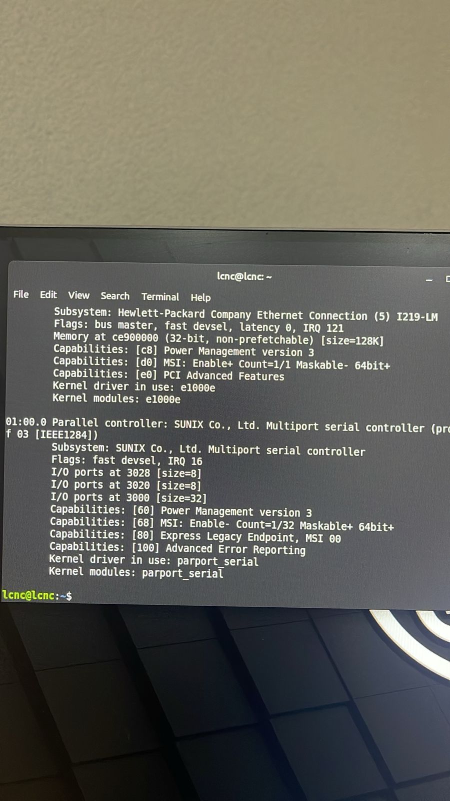

21 Mar 2025 23:37 #324494 by tommylight
Another PC with another of the Sunix PCI-E cards, no warnings on startup, notice the lscpi result where it clearly states the driver in use. This is not near me, a friend i am teaching CNC got this PC and card today, and it works out of the box, well after disabling secure boot in bios as that would cause permission denied and seg faults!!!
Now we need more test systems to figure out why the driver loads on some systems and does not on some...

22 Mar 2025 00:46 #324501 by tommylight
I think i should do a summary of the Sunix PCI-E card as the info got scattered in pieces, so:
I had one, it works perfectly but:
In a Lenovo PC it show the warning when LinuxCNC starts, but it works fine
In another PC with Asus Prime Z270 board, it shows no warning and no ................................
IT JUST dawned on me:
It will show the warning on older kernels, it will not show on new-er kernels!!!
Lenovo has Mint 19.3, the Asus has Mint 21.3, the friend with the same model cards has LMDE 6
Ok just checked the original post and it is Debian 12 so most probably 6.1.nn kernel, should be the same as in LMDE 6, so there goes my joy, oh hell, back to more testing! :) :) :)

23 Mar 2025 11:23 #324646 by tommylight
Picture, capabilities access denied, that is usually due to not using sudo, so
sudo lspci -v
see if it shows the driver and kernel module.
Always use sudo when dealing with kernel level stuff, for reading only.
