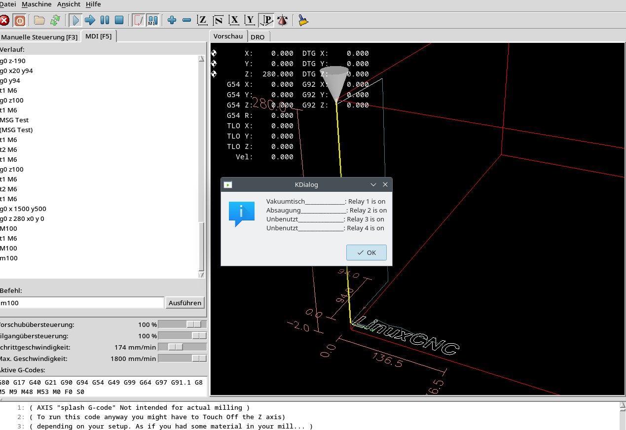

Hi all
I was looking for a way to control my vacuum table's vacuum pump from within axis. After reading the manual, searching linuxcnc's forums, I realised others were probably struggling with similar tasks (myst, dust extraction, ...), too. I could not find a proof cooked recipe. Below, you'll find what I am ready to go with. It is a proof of concept at the time. However, and since I use same/similar components the same/similar way in home automation, I am positive, it works in the real harsh world. Teaser wanted?
The KDialog message box is being called by M100, this reads the relays statii and displays as shown
So: let's go, just a remark: the editor seems to be disfunct, so I use my own marking:

So we can set relays from command line, as user "user" (cnc in my case) and read their status. Howto do it from within g-code?
M1xx comes handy:
Place a script similar to attached M100 into the directory specified in the .ini file's [DISPLAY] section under PROGRAM_PREFIX = /home/cnc/linuxcnc/configs/cnc0/macros
My path above needs to be changed to your definition.
Maybe, there is some rebooting and logging in/out/in required. I did not make notes on this.

08 Aug 2025 23:54 #333083 by tommylight
To late, but:
Axis (and probably other GUI's) already have built in control for Mist and Flood so you could have just used those as that would also make it possible to use the M7/M8/M9 codes to control them directly, more info here
linuxcnc.org/docs/html/gcode/m-code.html#mcode:m7-m8-m9
For more outputs/stuff, you would have to go with what you did, and there are probably many ways of doing it, and you can use PyVCP panel to show info about it at all times:
linuxcnc.org/docs/html/gui/pyvcp.html
I use PyVCP panels a lot with Axis GUI, a lot, even for showing all Mesa IO and everything else, on industrial machines. :)
forum.linuxcnc.org/30-cnc-machines/31792...ofit?start=100#88523
See the right side, all is added as PyVCP panels.

12 Aug 2025 12:13 #333272 by meister
you can reuse the 'iocontrol.0.coolant-mist' hal-pin and change the name in the Axis-GUI to 'Clamp'
