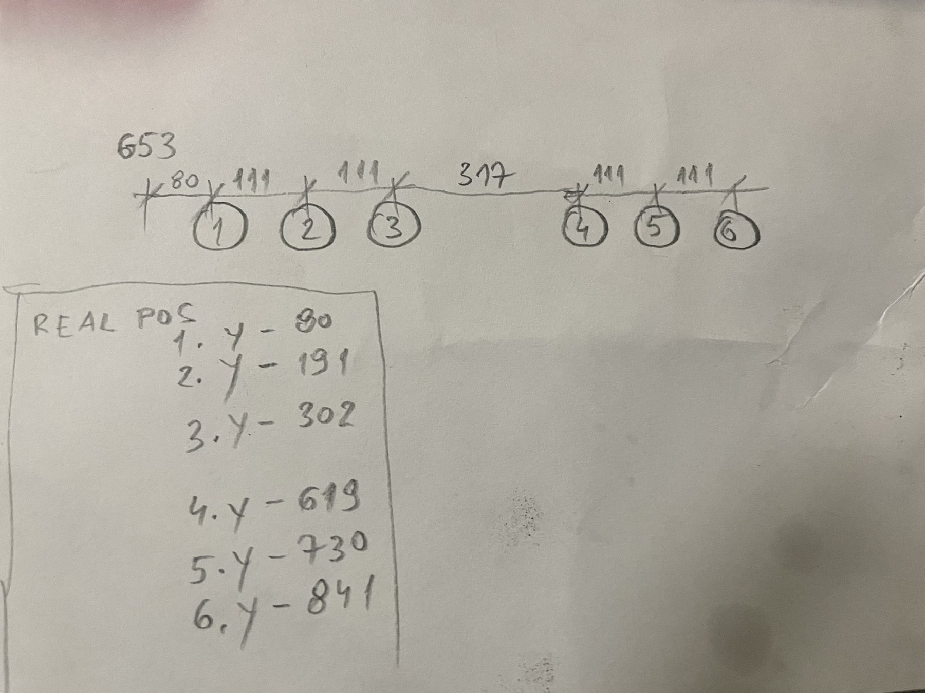

now, I don't know how to set the delta y for the second toolbox 4-5-6, because it has a gap between 123 456

Is the gap a multiple of existing tool distances?
If yes, set it as tool (4 i think in your case) and just do not use tool 4 in post, and even if someone asks for tool 4 no damage should be done as the spindle does not go that low.

The space between 3 and 4 do not agree to say that it is possible to divide by 111I would like all 6 tools to work, the delta between 1,2,3 is 111mm, so there is a gap, so the same delta raster between 4,5,6 is also 111mm, so the distance between 3 and 4 is 317mm...I will post the script for the first 3 tools later...if I copy and put an additional [change position delta 2]' in the ini file with ``if<current_tool GT 3>`` it doesn't work

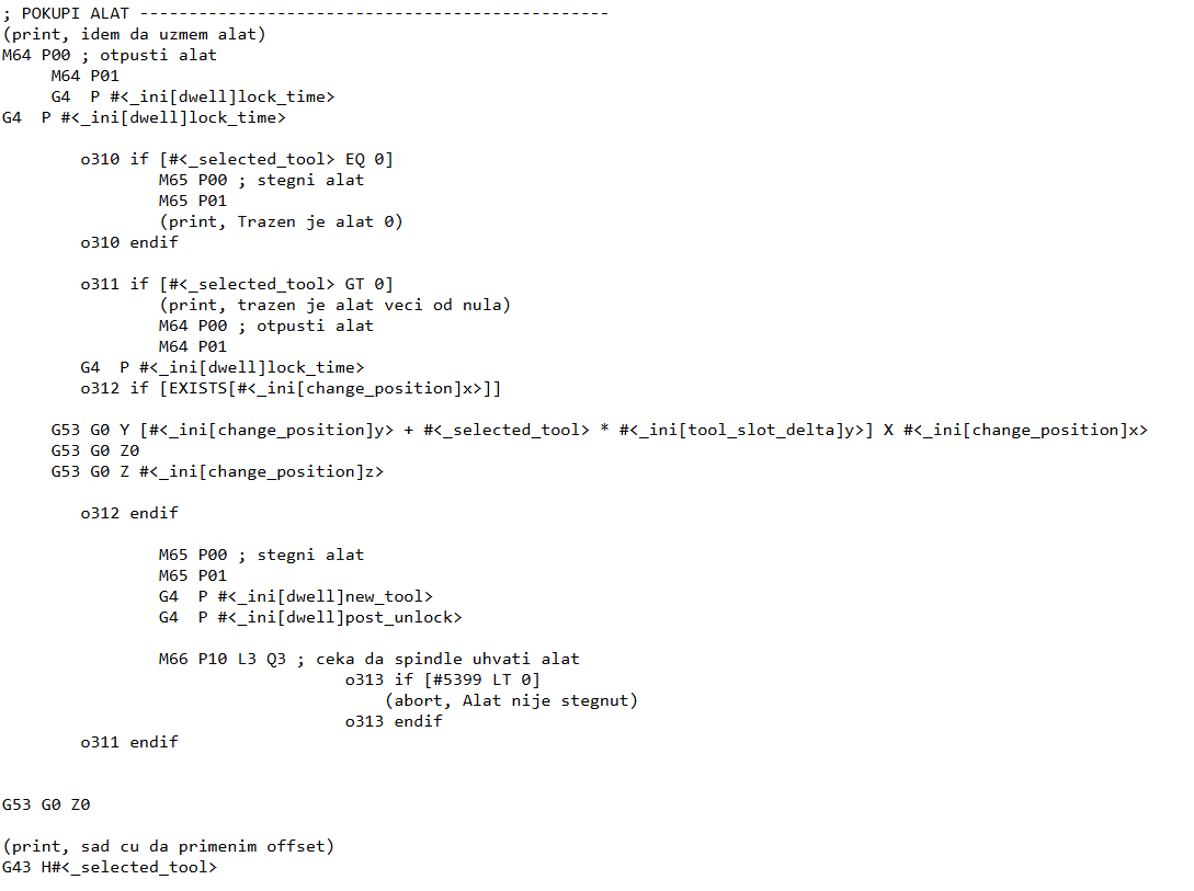

if someone know to edit ini and rack_change.ngc files according to my y positions for tool 4,5,6 here are my files.thank you
Replied by Masiwood123 on topic freelancer needed to create a routine for ATC tool change (rackchange)

The distance between 3&4 = 317 and its therefore 206mm more than the delta. (111_206 - 306)

thanks Rodw, I can try ``it in the air'' but that would also be ok if I get a change for slot 4, but since slot 5 and 6 are also bigger than GT3, then I will get some other distance for 5 and 6, unless I make additional lines again, ``if GT4`` is bigger than 4, then again only delta y will work, which is 111mm?

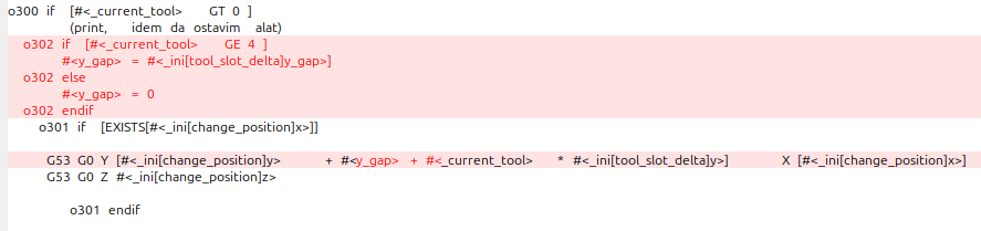

I see you got replys already, while preparing this. My idea to solve that, by adding the gap value for tool 4 to 6. Extend the ini entry for [TOOL_SLOT_DELTA] by y_gap, then apply that value for tool 4 to 6
in o<rack_change> sub
in .ini
Edit:
AS the 'tool_slot_delta' is always added, the 'y_gap' should be reduced by 111 to 206
o300 if [#<_current_tool> GT 0 ]
(print, idem da ostavim alat)
o302 if [#<_current_tool> GE 4 ]
#<y_gap> = #<_ini[tool_slot_delta]y_gap>]
o302 else
#<y_gap> = 0
o302 endif
o301 if [EXISTS[#<_ini[change_position]x>]]
G53 G0 Y [#<_ini[change_position]y> + #<y_gap> + #<_current_tool> * #<_ini[tool_slot_delta]y>] X [#<_ini[change_position]x>]
G53 G0 Z #<_ini[change_position]z>
o301 endif in .ini
[TOOL_SLOT_DELTA]
X = 0
Y = -111
Z = 0
y_gap = 317Edit:
Last edit: 12 Dec 2025 19:21 by MaHa.

.this does not work, maybe because you entered the parameters in the routine in the section of returning the current tool to its place, also o302 already exists, so I changed it to o303, but the same thing happens when selecting T4 M6(spindle goes 111mm from tool 3). you should somehow add it to the section of the file where it says ``POKUPI ALAT'',- means that is, ``selected tool'' down in routine, if you are able to edit that part. Thank you very much

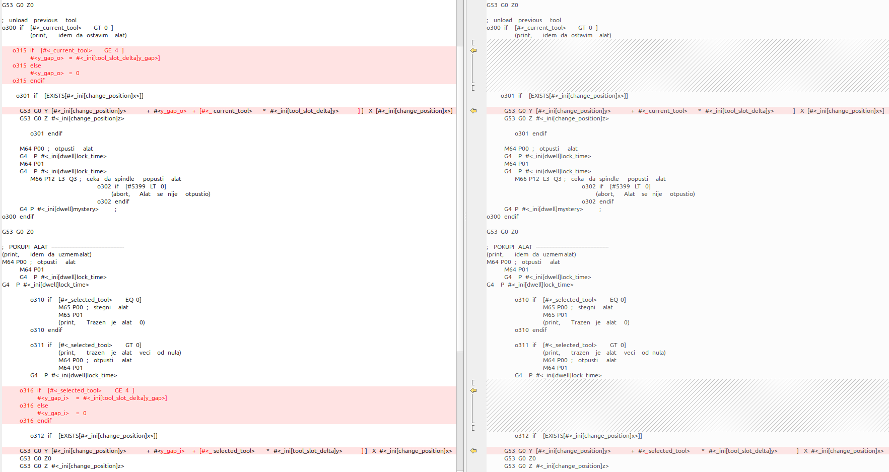

13 Dec 2025 12:52 - 13 Dec 2025 14:07 #340064
by MaHa
Replied by MaHa on topic freelancer needed to create a routine for ATC tool change (rackchange)
I modified the routine for unload and load, o315 and o 316 used. In .ini file the value for 'y_gap' should be 206, not 317 The diff shows the modification
Last edit: 13 Dec 2025 14:07 by MaHa. Reason: updated file
