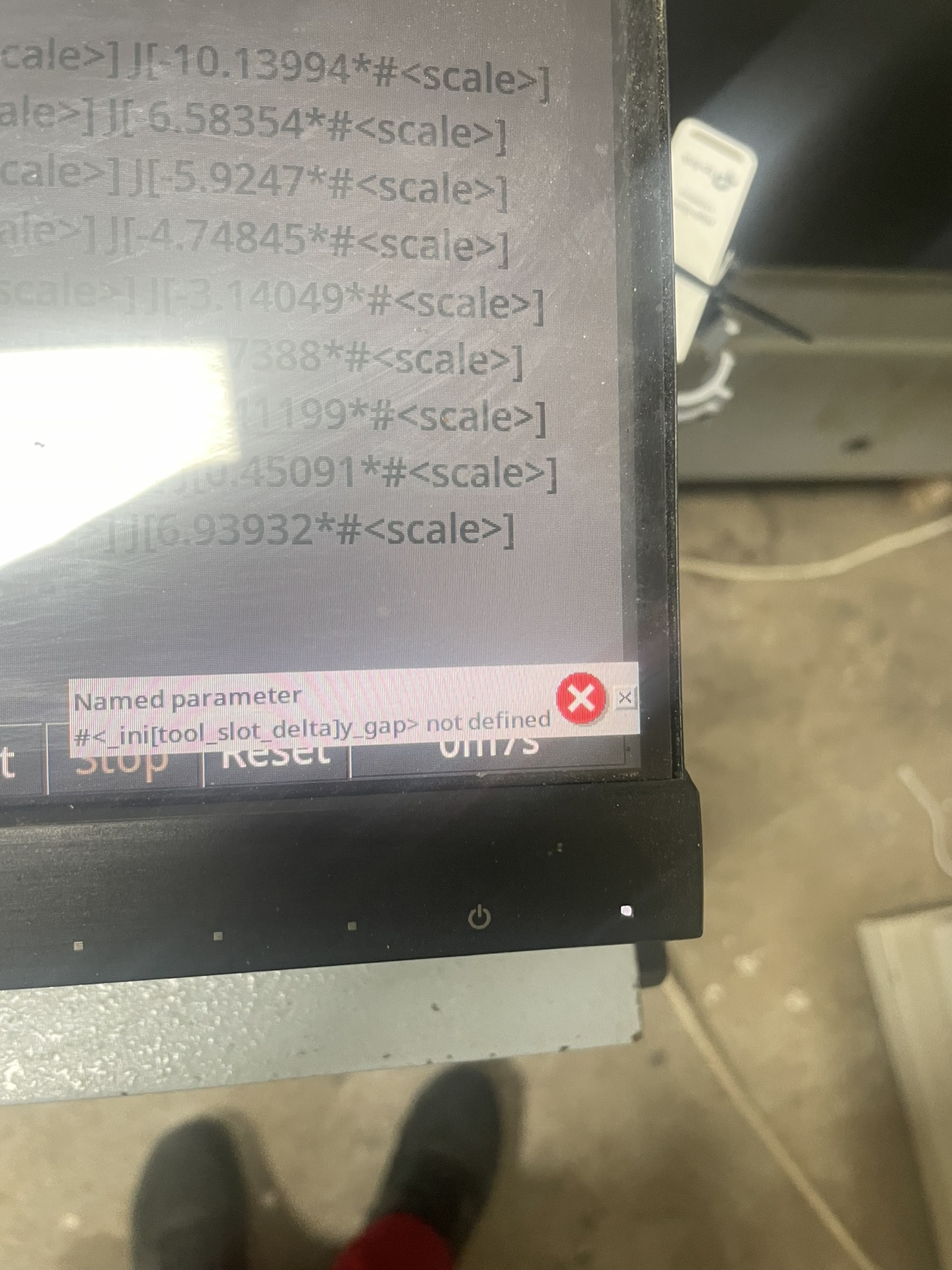

Did you add this to the .ini file, theĀ line with y_gap ?
[TOOL_SLOT_DELTA]
X = 0
Y = -111
Z = 0
y_gap = -206
[TOOL_SLOT_DELTA]
X = 0
Y = -111
Z = 0
y_gap = -206

I think the problem is, not using uppercase letter. This should work:
Y_GAP = -206
Y_GAP = -206

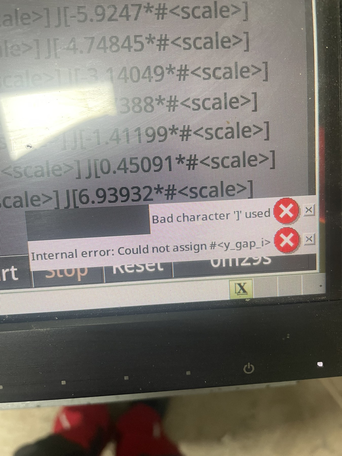

There is this bracket ']' to remove:
line 27
#<y_gap_o> = #<_ini[tool_slot_delta]y_gap>]
line 72
#<y_gap_i> = #<_ini[tool_slot_delta]y_gap>]
line 27
line 72

WOW now it works without errors, thank you very much, I'm very happy... please leave an email, I would like to do something for the favor!
