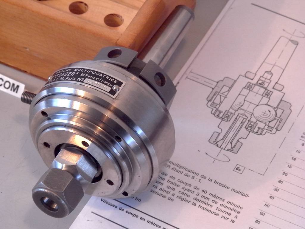

That is very similar to the variable speed drive in my lathe. I don't think it is actually variable, but the parts are very similar:
bodgesoc.blogspot.com/search/label/holbr...Drivetrain%20Autopsy
Replied by andypugh on topic Retrofitting a 1986 Maho MH400E
Another speeder with friction design.
The springs force the balls to make contact with the races
- drimaropoylos
- Posts: 265
- Thank you received: 39
12 Jun 2019 17:06 #136763
by drimaropoylos
Clever design
