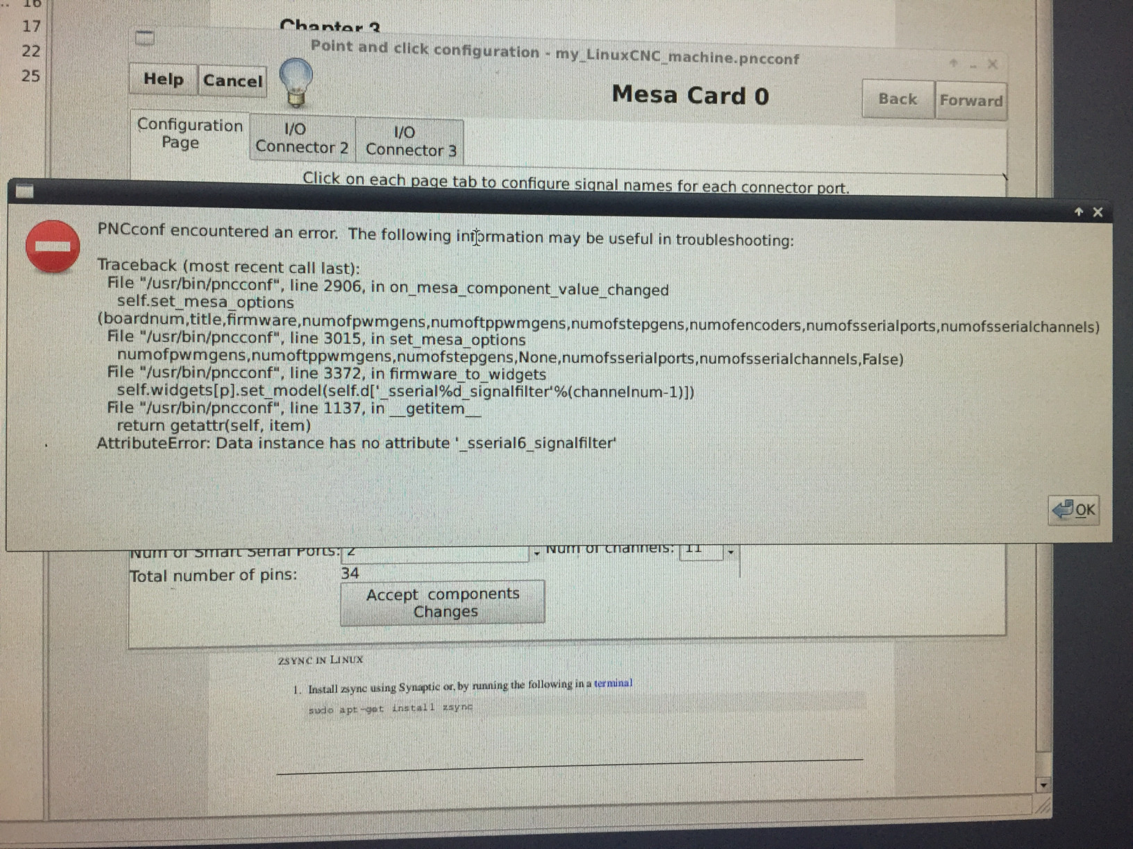

PCW, are you saying that I should use PNCConf to make a hal file for the 7i77 and then add the 7i74 manually using that line?
I'm asking because I updated the 5i25 with a firmware that's named 7i77_7i74 (extracted from the 5i25.zip file, containing all the available standard firmware from Mesa), and after copying the files to the appropriate folders so that the wizard allows me to select them I can't seem to get a config going with that setup. In fact, any setup with a 7i74 causes PNCConf to parse multiple errors (e.g two 7i74s, or the reverse 7i74_7i77), I can't move on to the next step in the config.
This behaviour does not occur with any of the other firmwares, all of them populate their respecitve lists and allow me to continue with the configuration. I'm kind of confused.
So should I select a different firmware and then change the hal file manually to include the 7i74 (which connects to a 7i84 and 7i73 via patch cables)?
BTW, all the cards apart from the 5i25 are using field power from a PSU, all the diodes seem to work, and a multimeter confirms every card gets its required 5V. The show pin command now shows some 7i77 pins in addition to the 5i25 ones, but nothing from the 7i84. Please note that I haven't yet created a config with the wizard because of the problem described above.

Unfortunately, I only understand enough basic German to not get completely lost when I'm abroad, technical language is beyond me. I tried turning on subtitles with automatic translation to English, that went about as well as one could expect
I agree about PCW's quick reply, it's just sad that I don't understand what to do with it
In your instructions, you write about checking pins on cards with the hal command; did you have a configuration file by that point?
What's really my issue at this stage is that I don't quite understand the sequence of what has to be done next. The Mesa cards are connected to power and to each other, I removed the Philips control. Should I now make a config (and if so, do I have to set one up manually if PNCconf doesn't work with the 7i77_7i74 firmware?) and then connect the hardware?
That is to say, does one edit the configuration file when each hardware component is added and test it, starting from a barebones file that doesn't really have anyhting correctly configured? Or should the machine be connected to the Mesa cards first, to help the configuration utility do its job?
EDIT: Attached the error from PNCConf, it pops up after I click to accept the selected firmware (which was installed on the 5i25 and verified).

If PNCconf doesn't have a config for the 7i74, just do the basic 5i25 + 7i77 config in PNCConf. Then in the HAL manually edit that one line PCW indicated. Then restart the system with the 7i74 connected, and use HALShow to see if the 7i74 pins are now available to you.
