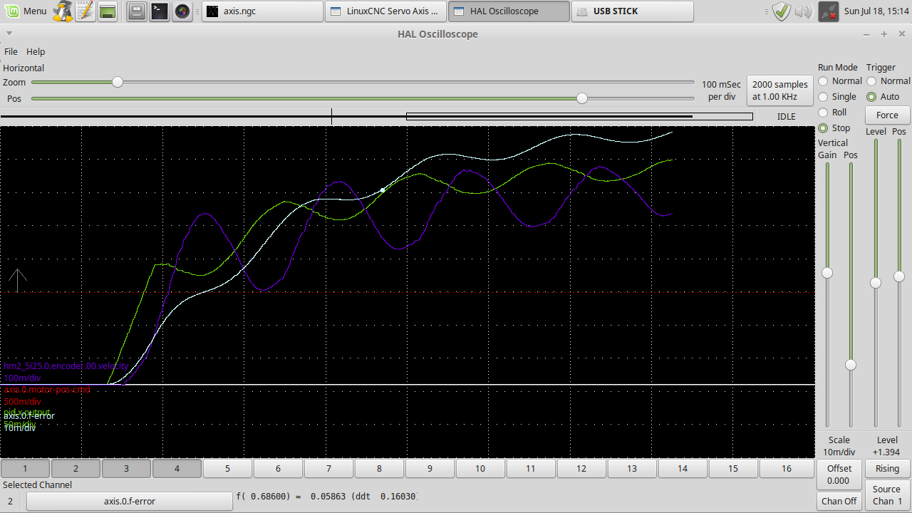

02 Jun 2022 12:05 #244463
by new2linux
Replied by new2linux on topic Set up using AMC AB15A100 drives, brushed DC motor Prototrak Plus with Encoders
This pic is of hal trace, with the values as low as it seems to go, 23.? feed (look at the rate in pic). The trace I need to watch is the "axes f error" and make this horizontal w/o over shoot. Please take a look, no "I" at all.
I was thinking about the "I" variable, to calculate the rpm I can back into the feed rate, it would seem. Use the hal scope to monitor the voltage, while adjusting POT 3.
Many thanks!
Many thanks!

02 Jun 2022 13:01 #244466
Replied by PCW on topic Set up using AMC AB15A100 drives, brushed DC motor Prototrak Plus with Encoders
If the following error is in the same direction as the velocity (which it is here)
It means you don't have enough FF1
It also look like you have very low velocity gain in the motor drive
Did you tune this? (That needs help from AMC)

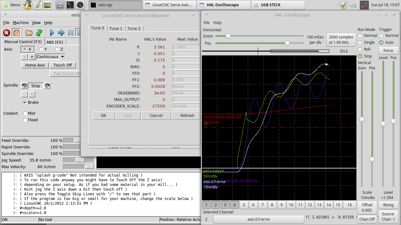

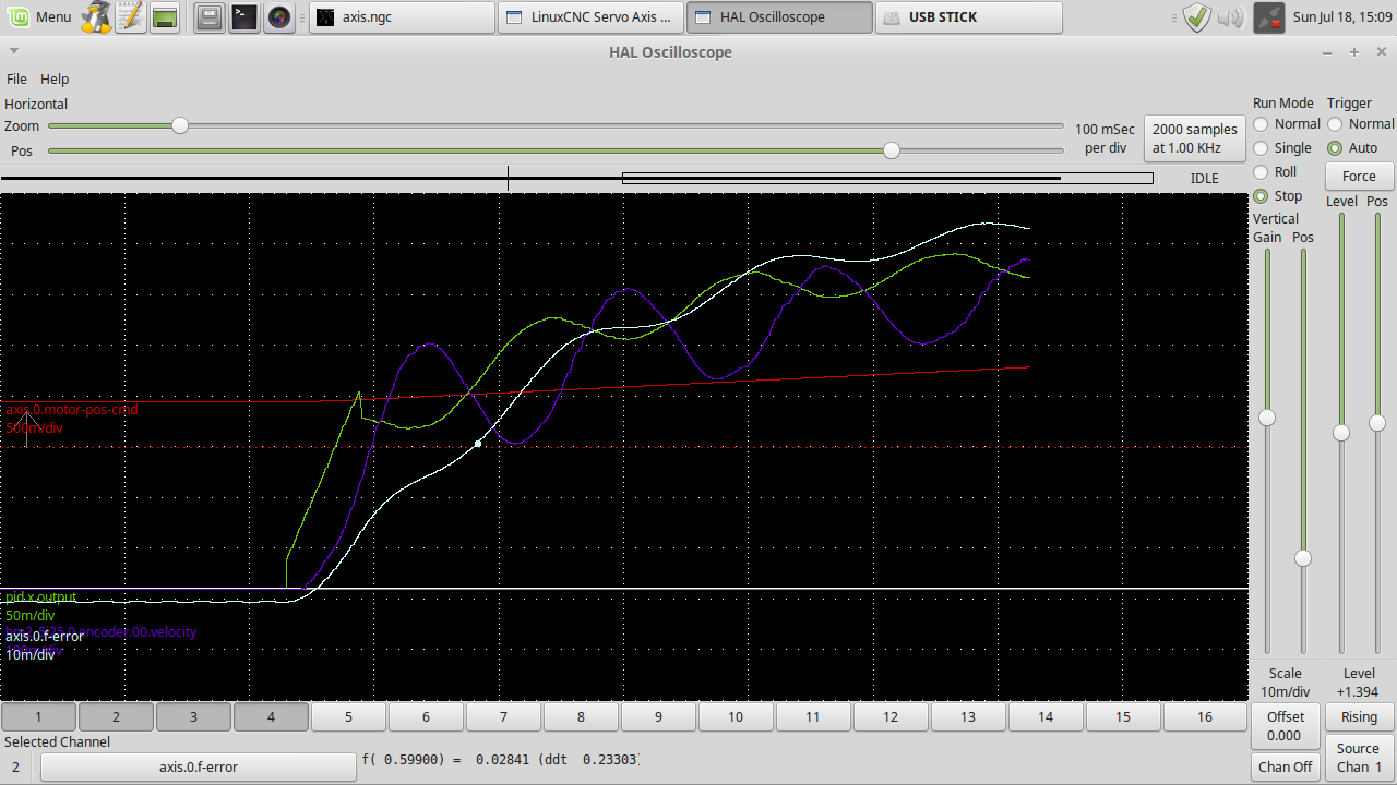

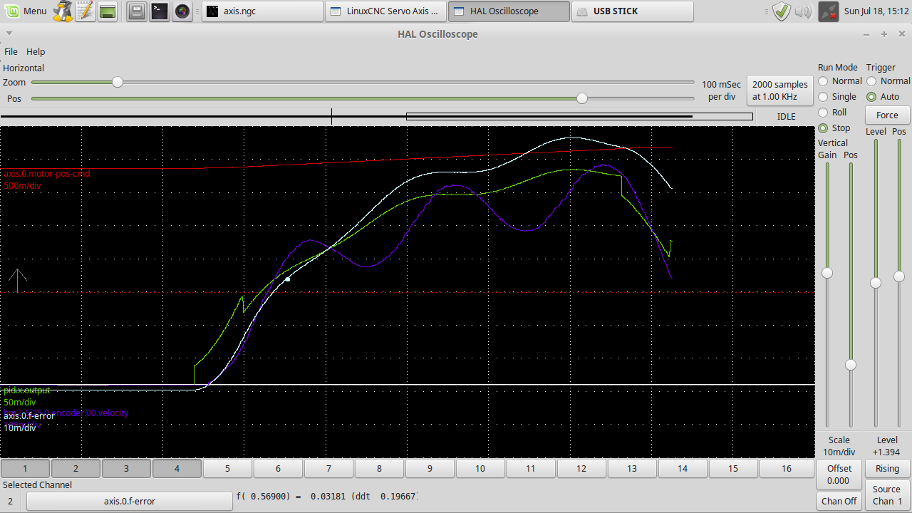

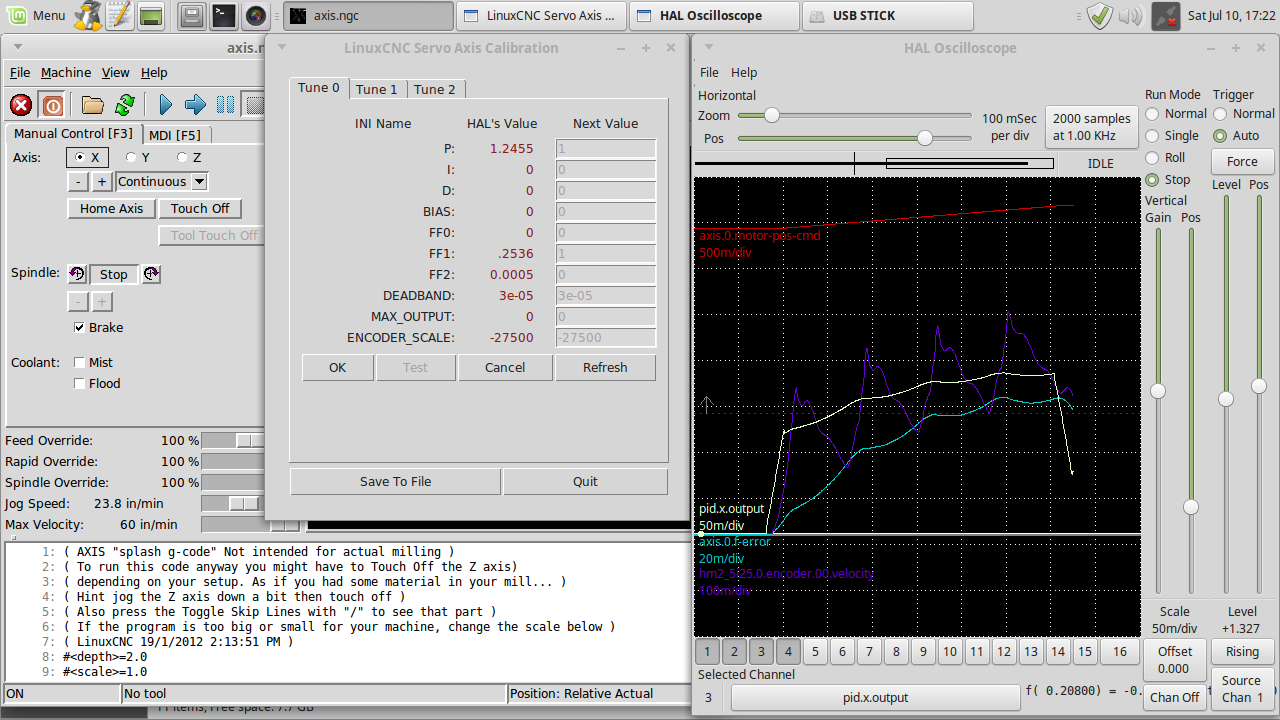

10 Jun 2022 10:00 #244875
by new2linux
Many thanks for all the support and help. I have used the .051 as the value of "I" as shown in the attached traces of the hal scope. The full screen traces show when one of the variables are zeroed out. I have used the tommylight Servo Tuning as a guide & the attached pics show the best I have been able to tune by starting low with incremental changes. Feed rate is 35"/min, read the file name to understand what changes show in the screen-shot. There is 2 traces of the same settings, 1 pic shows the screen with feed rate & other info seen, & the full screen trace of that.
I welcome any suggestions.
Many thanks
Many thanks

10 Jun 2022 11:52 #244884
The drive itself seems to not be tuned
(if it is setup for velocity mode)
There is not much point in tuning from the LinuxCNC
side until the drive itself is tuned
Does AMC have drive tuning instructions?
Are you sure the drive is setup for velocity mode?
