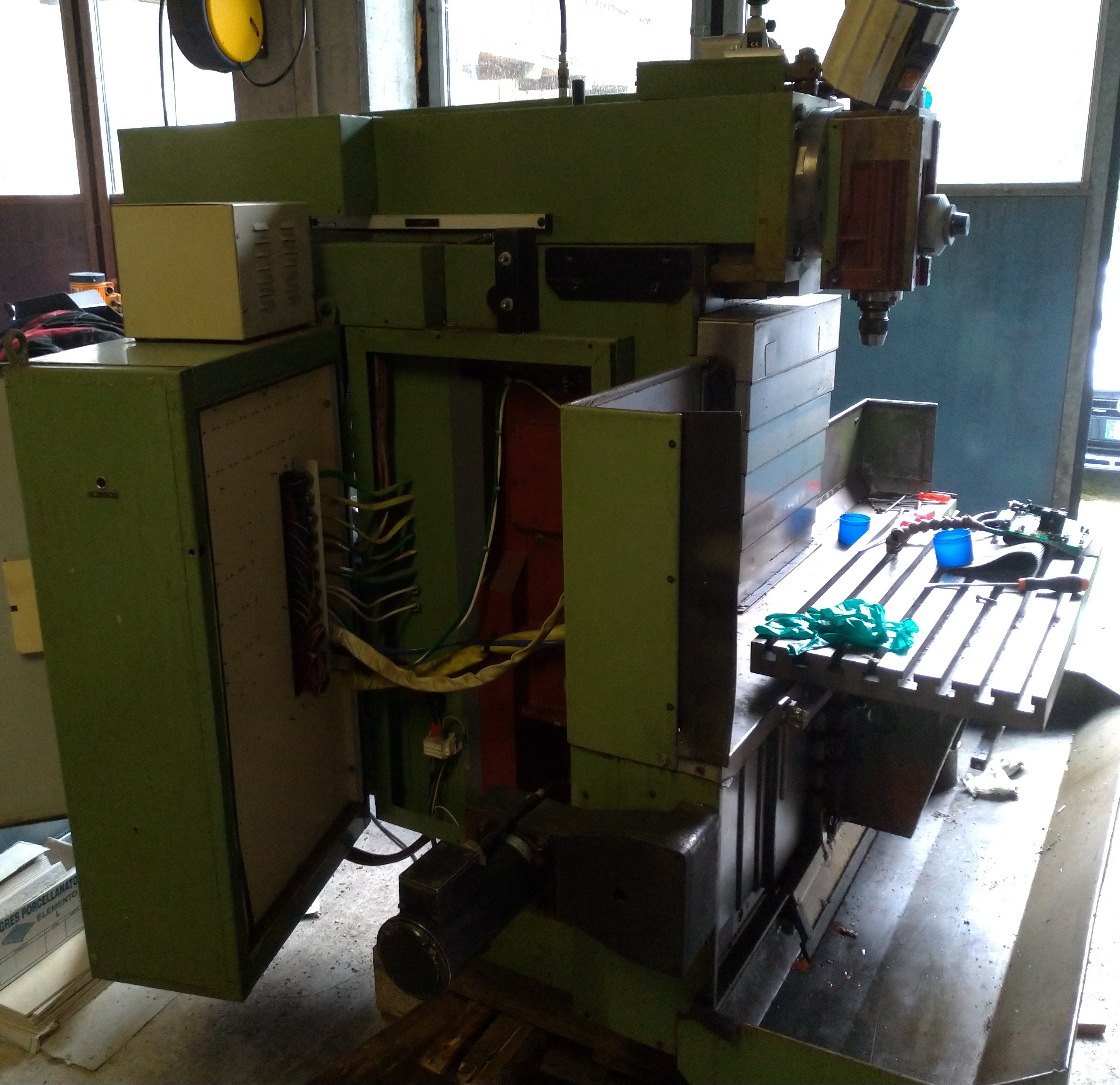

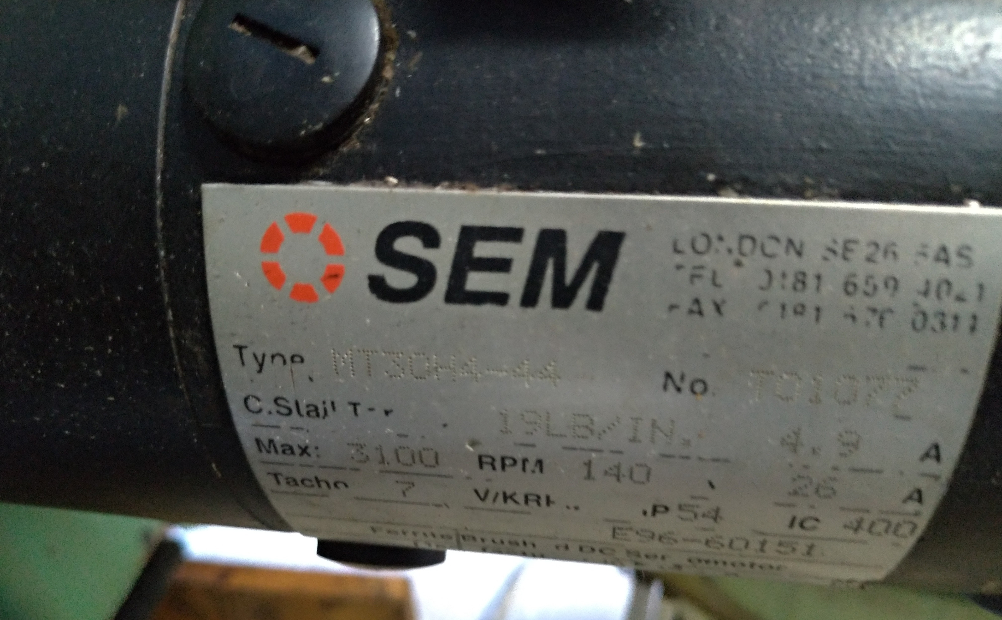

Hi,I am owner of a fngj 40 milling machine, which i want to convert to linuxcnc.
The x and y axis are already converted to ballscrews.

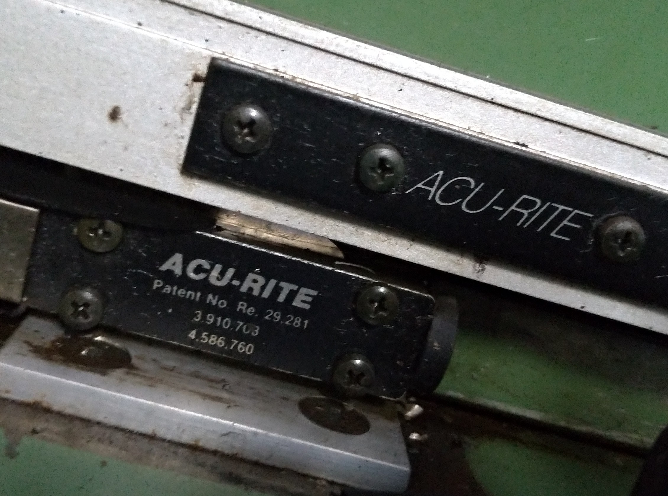

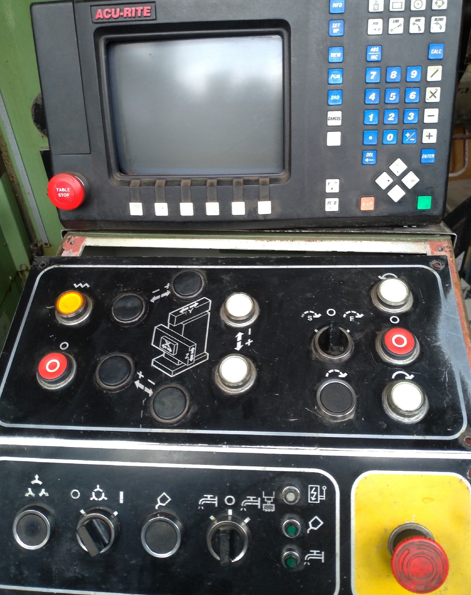

The machine mounts a broken acu rite 2 axis cnc control
At first look the glass scales seem to be incremental with index.
The servos seem to be brushed analog servos.
Thats what i know at the moment.
Now to my questions
- the Z axis mounts a acme thread with a revolving nut, which makes a conversion to basscrew a bit complicated, so if anyone has an idea or already converted such a machine, i would apreciate some help.
- I would like to realize the control with a j3455 and mesa cards. I would like to reuse the analog servos, encoders and maybe add 2 step dir axis. And of course i would need 5/5 or so digital i/o. What would be a good choice?

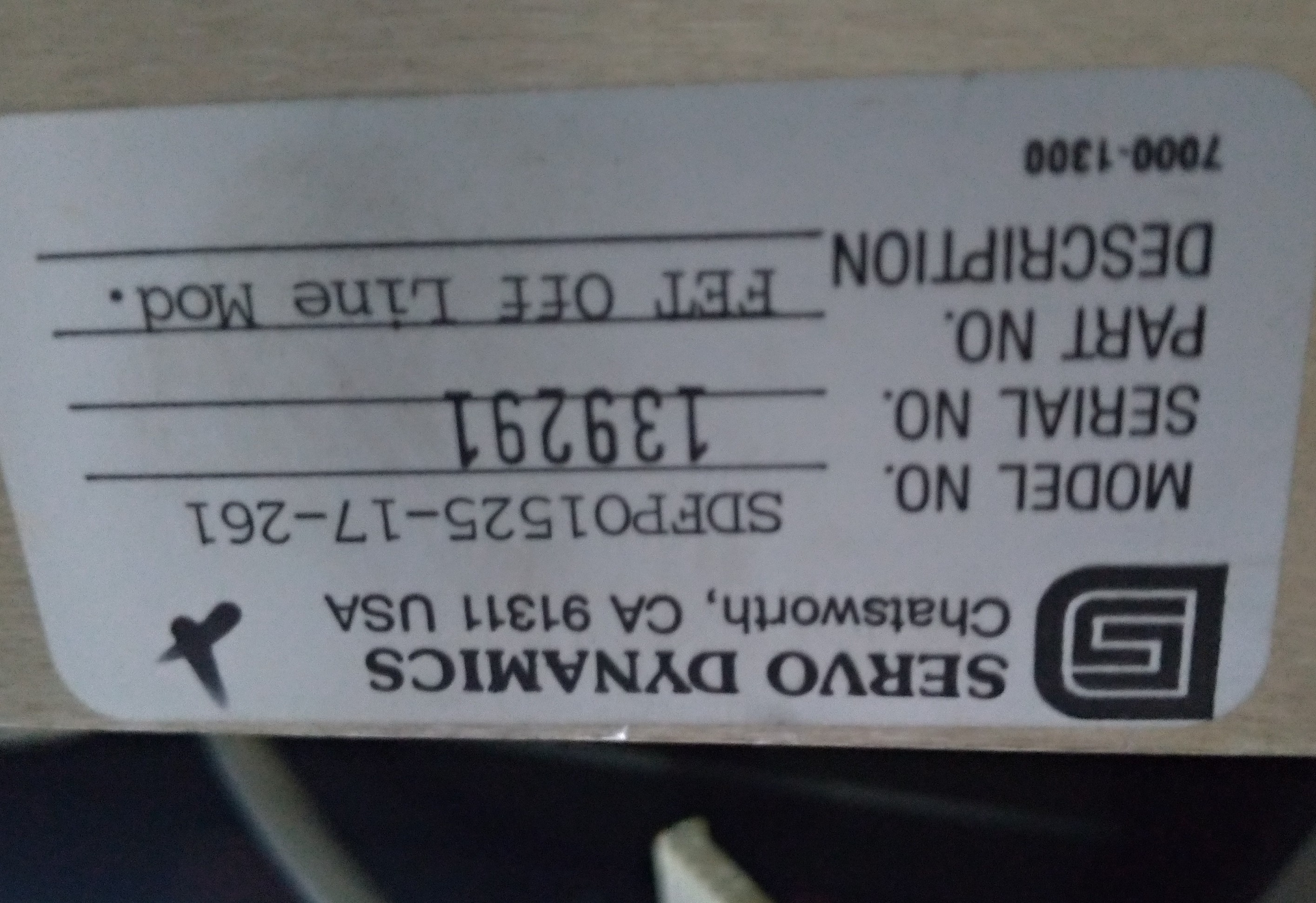

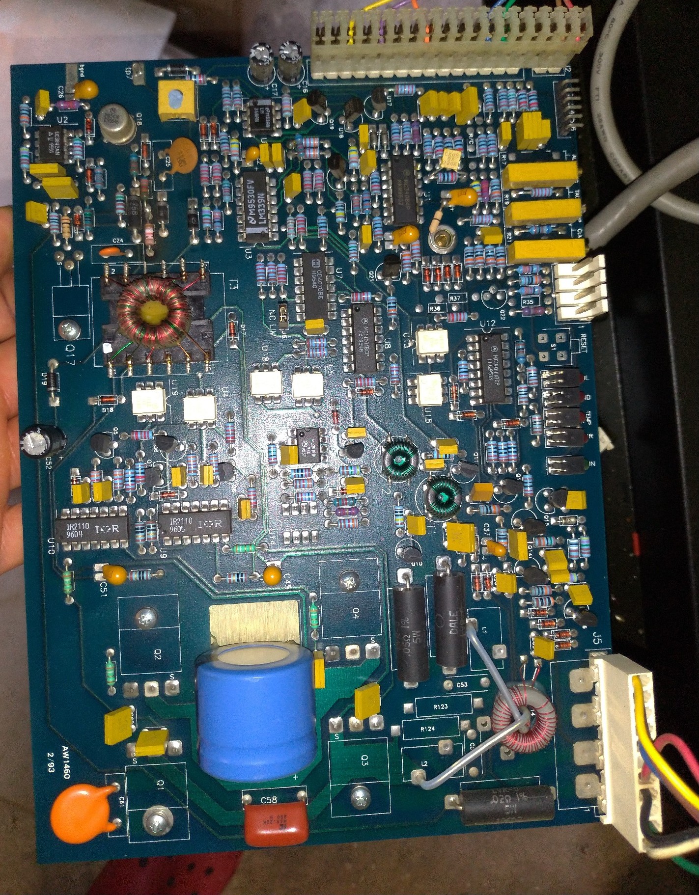

- does anyone know if those acu rite millpwr servo drives can be reused with lcnc/mesa hardware?
I an pretty shure there will be some questions over the time, so thank you in advance.
Now to my questions
Last edit: 27 Sep 2024 18:17 by FPM. Reason: clearer formulation and added photos like tommylight suggested

Oooh, nice. I always liked these.
For reference, these are basically the same is a MAHO, so all the same rules should apply.
Mine had the revolving nut for the z ram. But they way they did it was to have a normal ball screw nut mounted in a rotary mechanism. So check over what you have there already, it may be reusable with a normal ball screw.

As to the electrical... Mesa 7i77 would be where you start for analogue with quadrature encoders, but I would have in the back of my head replacing the servos with new ones.

You might be able to get away with not converting the Z screw, as long as upwards cutting forces never exceed the mass of the table. Which is quite likely.
Though in the case of my Harrison (much smaller) I needed to convert because the torque required to move the trapezoidal screw was too high.
Another consideration is if you plan to use the horizontal spindle in CNC, as upwards forces are more likely then.

Z on these machines is the ram, it is a horizontal axis.
