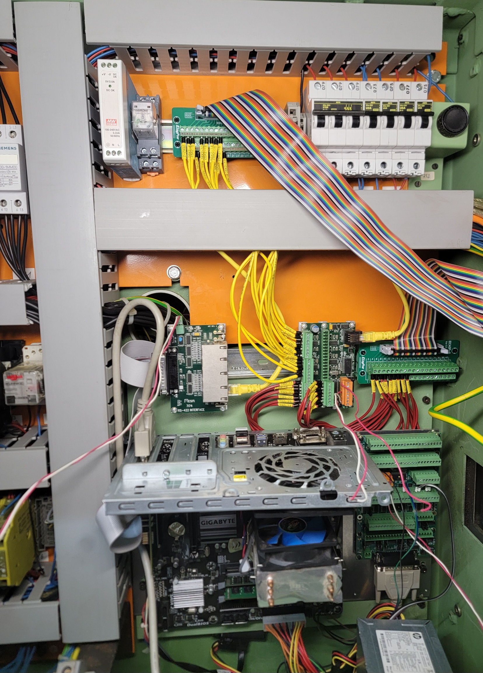

15 Oct 2025 13:14 - 15 Oct 2025 13:18 #336500
by Cooped-Up
Replied by Cooped-Up on topic Maho MH800e Retrofit Project
I have been slowly chipping away at this in my free time. Finally got to the point of removing the old computer. I made a mess of the wiring trying to test stuff but I ripped all that out and started over so here is where I am at. Waiting on another power supply for 12v as one of my cards needs that rather than 24v the machine provides. Only a few more wires to add then I believe I will be able to start carefully jogging the machine around.

18 Oct 2025 00:37 #336641
by Cooped-Up
Well I have all of the electronics mostly wired properly to the point of testing. I am struggling to get the machine out of estop as my external estop doesn't seem to want to close the circuit even though I thought the relay was closing. More investigation into the schematics are needed and then hopefully I can move forward with the testing

21 Oct 2025 13:54 #336832
by Cooped-Up
I got a little more work done this morning, the PC now boots up when power is applied, the impulseformer is wired to 12v but I found the 5v is not hooked up to the correct pin, Chinese wiring diagram or I was wrong not sure yet, and all the raceway is snapped back into place so you can't see the rats nest of wiring. Should hopefully have the machine scales reading something when I find the correct wire for 5v. All of the other pins rung out correct so it's just the one color wire. I ordered a touchscreen interface so I should be starting the build for the control panel when that arrives. I need to decide if I want the jog wheel on the interface or on a pendant or both. Regardless I have a 7i73 for that stuff. I am considering implementing a 4x20 LCD display into the pendant control but don't know if that would really add any value as my touch screen will be fairly large and easy to read or I hope from a distance.

22 Oct 2025 12:47 #336873
by Cooped-Up
Well yesterday and this morning before work I was able to not only correct the wiring for the encoders which works now, but also figured out my issue with the 2x20 pin header wiring issue. I now realize a note I read on another document that the output is not alternating between the top and bottom row but is straight across the top then the bottom. Now that the wiring is squared away I just need to figure out the gearbox shifting logic to make the machine in theory functional. Well that and build the operating panel which the screen is on its way.
