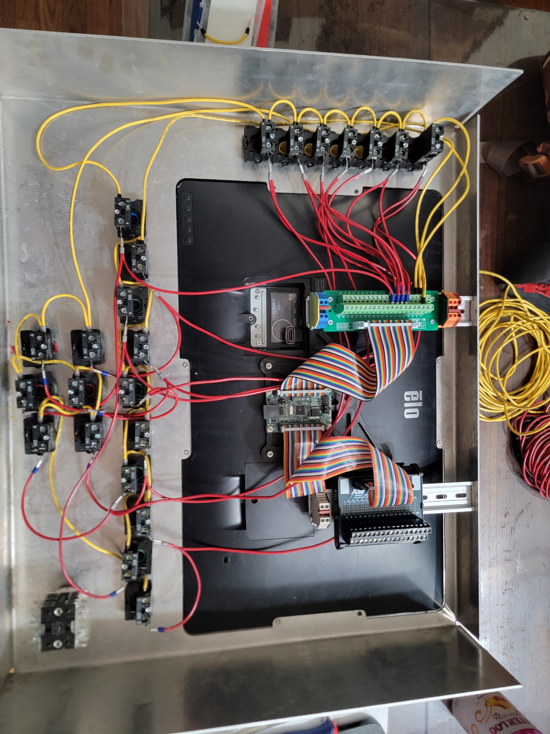

Got a bit more work done on the machines control panel. All of the buttons I currently want in it are wired in to the 7i73 so I just need to update the .hal file to use the new inputs on the button matrix. Still plan on adding buttons if needed as well as integrating my MPG and axis selector switch etc. to the panel but for now it is all wired up short of the drive enable and estop as that stuff is in the garage and I am in the house

been having some trouble with getting my 7i73 keyboard matrix to interact with the machine. could be just a me issue, it is currently abouyt 32 degrees f and I cant feel my hands out here. tried searching for answers and gotr some but the buttons dont do anything in either halshow or halscope. I have attached my hal files that involve the matrix.

rewatching rotary-smp's video on his schaublin panel I think I see my issue. I had wired the diodes for sourcing current but he mentions that it is sinking current so I need to flip my inputs and outputs to fix that like he had to in his video. I did try to bypass one buttons diode with no luck but perhaps swapping all of the around will solve this

I swapped around the inputs and outputs and that solved the issue. I was able to get all the buttons to function. I spent a while working on getting the gmoccapy jog buttons to move the axis but for some reason the only way I was able to get any of the axis to move outside of homing is to use the halshow to select the axis for jogging. Tried tying the ui pins to the pos and neg axis pins. Also almost done with the pendant with the mpg just need the rotary switches and wiring
