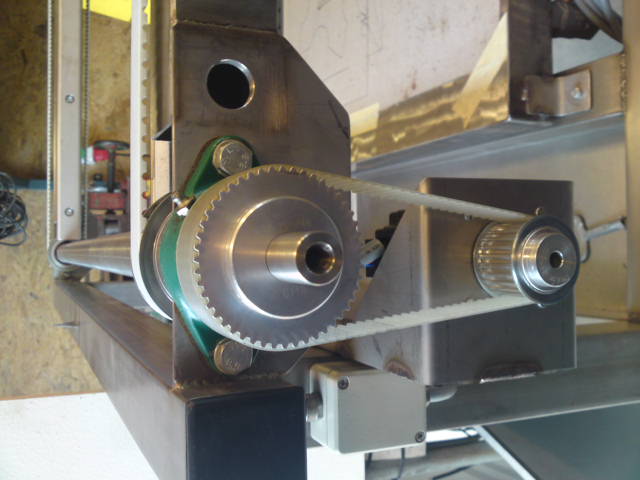

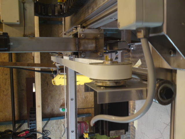

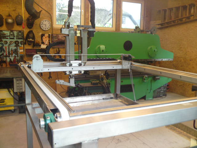

Here's what I bought
PM542 Micro Stepping Driver
ZP5A-INT 5 axis breakout board
SPS407 Power supplies 42V
SY60STH88-3008BF High Torque three stack Nema 23, 1.8 degree hybrid stepper motor
I bought a machine from a flower company where there were many of the parts I needed.
My machine runs with Belts and pulleys on the X axis, Y axis and Z axis
Z axis also runs with spindle
X axis of the motor is a T5 25 tooth to a T5 48 teeth on the shaft.
shaft goes forward it to two T10 25 teeth that pull the sled
Y axis of the motor is a 25 tooth T10 to a T10 25 tooth
Z axis of the motor is a T5 15 tooth to a T5 25 teeth on the spindle. The spindle has an increase of 2 millimeters per revolution
Hope this is understandable.
In the cnc Linux, I can see there are several different programs depending on what kind of machine you have. Mine is indeed a plasma cutter, but the only program I can get to work, it is stepconf wizard creates.

I googled the manual on your drive and it has many options for micro stepping. I'll use 2 microsteps for my example.
If you go to the X Axis Configuration page in the stepconf wizard you would enter
Motor Steps per revolution: 200
Driver Microstepping: 2
Pullet Teeth (Motor:Leadscrew) 25 : 48
Leadscrew Pitch ??? revolutions per mm
You gave the Z axis Leadscrew Pitch of 0.5 revolutions per mm so you need to figure out X and Y.
This should get you going...
John
John
