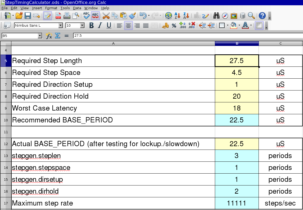

Can anyone advise me on the following.
When I open the “Step Timing Calculator”, I can high light the numbers in the yellow fields but I can't get them to change. (I've never used a spread sheet before).
How do I get this program to cooperate?
26 May 2013 14:04 #34714 by ArcEye
Replied by ArcEye on topic Help with "Step Timing Calculator"
A picture is worth a thousand words
When the yellow cell is highlighted the value appears in the long edit box above the spread sheet.
Edit that and it will be reflected in the cell
The following user(s) said Thank You: allenwg2005

26 May 2013 19:16 #34724 by allenwg2005
Replied by allenwg2005 on topic Help with "Step Timing Calculator"
Arceye,
Once again “illustration is the best instruction”. ;)
I am able to get the field to “high light”, I can even select the number in the field and give it a black background, but the numbers will not change.
Is there some kind of permission I need to adjust in the spread sheet program?
Is there a better way to address "Tuning Steppers"? (I have stalling problems on Y & Z).

26 May 2013 19:20 #34726 by allenwg2005
I see, the document is set to read only.
What is the best way to change this?
27 May 2013 15:05 #34752 by ArcEye
Not the one I downloaded
wiki.linuxcnc.org/uploads/StepTimingCalculator.ods

27 May 2013 15:15 #34754 by BigJohnT
Replied by BigJohnT on topic Help with "Step Timing Calculator"
Try right click on the link and save as...
JT

27 May 2013 17:10 #34759 by allenwg2005
JT, save as did the trick, thanks.
