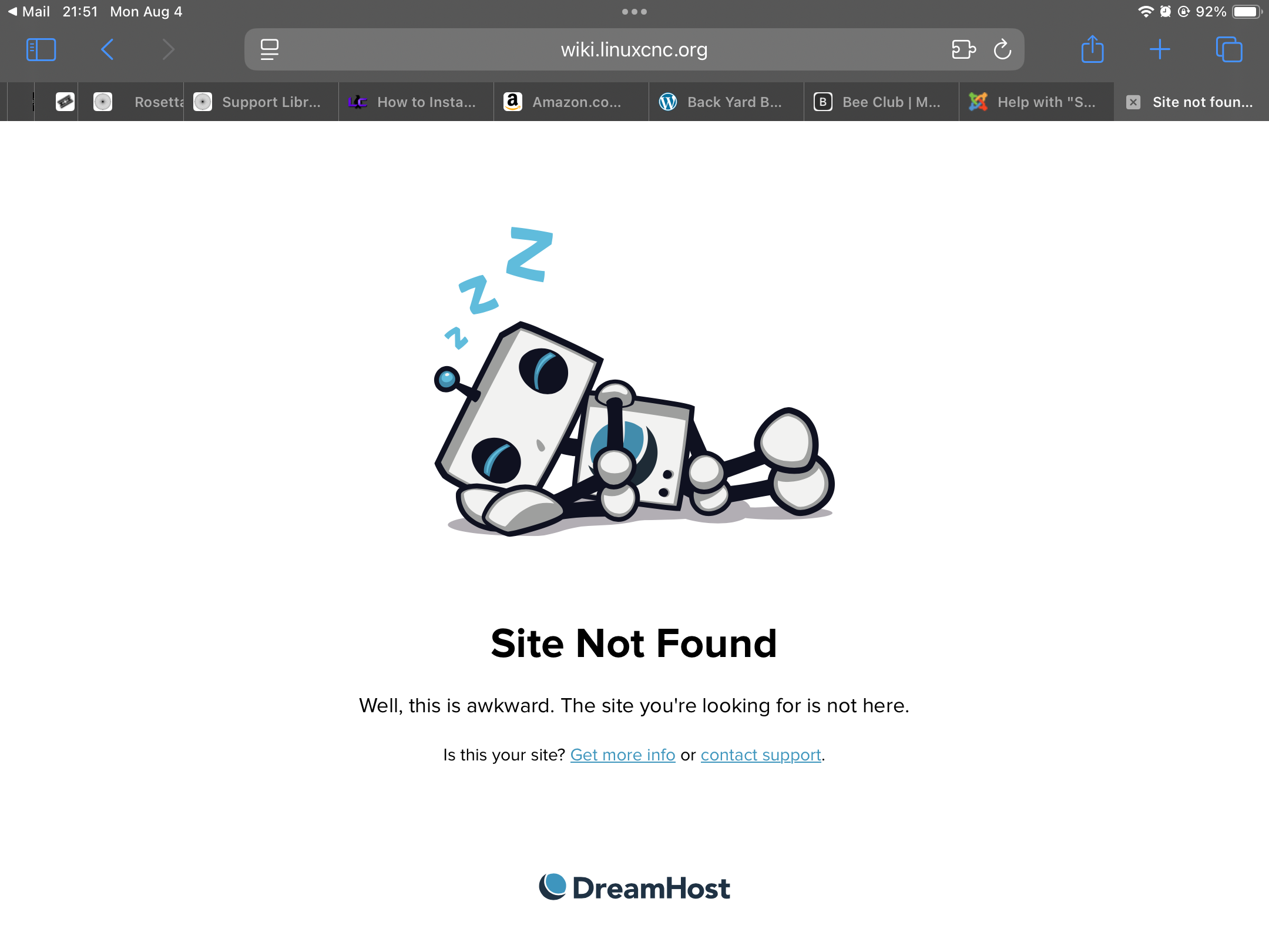

- richcolvin
- Posts: 28
05 Aug 2025 01:52 #332861
by richcolvin
Replied by richcolvin on topic Help with "Step Timing Calculator"
This is what comes up from that link
Time to create page: 0.716 seconds
