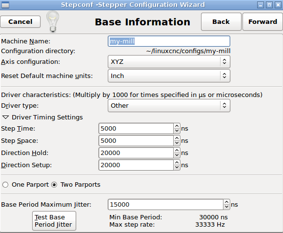

Sorry, I should have included this with my question.

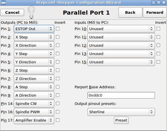

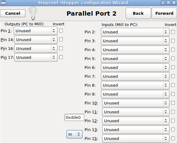

I don't normally use stepconf, but if you tell it you have 2 parports
It will show a dialog for the first one
and then the second one
Your port addresses are probably going to be 0xddc0 and 0xdde0.
Which one is the fly lead port from the header and which the port at the board edge connector is less certain,
very often however the port connected via the fly lead is the lower number.

Dennis:
What version of linuxcnc are you using?
prior to 2.7 You can select more then one parport but the signals for the second one can only be used manually by editing the HAL file.
The selection only added the command to load the second parport.
in 2.7+ you can now select signals as Arceye has shown.
Chris m
