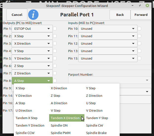

17 May 2021 04:25 #209192
by phillc54
Replied by phillc54 on topic Help with dual steppers on y axis and config
Tandem joints for StepConf were added to master only and are limited to the X and Y axes.
github.com/LinuxCNC/linuxcnc/commit/f213...27a402ba6ec66ea54dfc
- masawee
- Posts: 71
24 Jun 2023 08:46 #274164
by masawee
Replied by masawee on topic Help with dual steppers on y axis and config
how i update cnc 2.8.4 to 2.9 can add dual Y axis,
2.8 not working has try many many different forum help example all only error lot and not working newer, and home button not working at pc display, not have homind all axis or homing Y normal XYZ have and work good. but if add dual Y not working. i has write copy joint 3, joint0=X, joint1=Y joint3=Y2, joint4=Z copy same text joint1 and added joint2. not newer has working. and not can use cnc because need first all axis homing, but not can do this because not have homing buttons active and Y homing button has hide somewer not haveat display. only lot come errors to display not do anythink,
