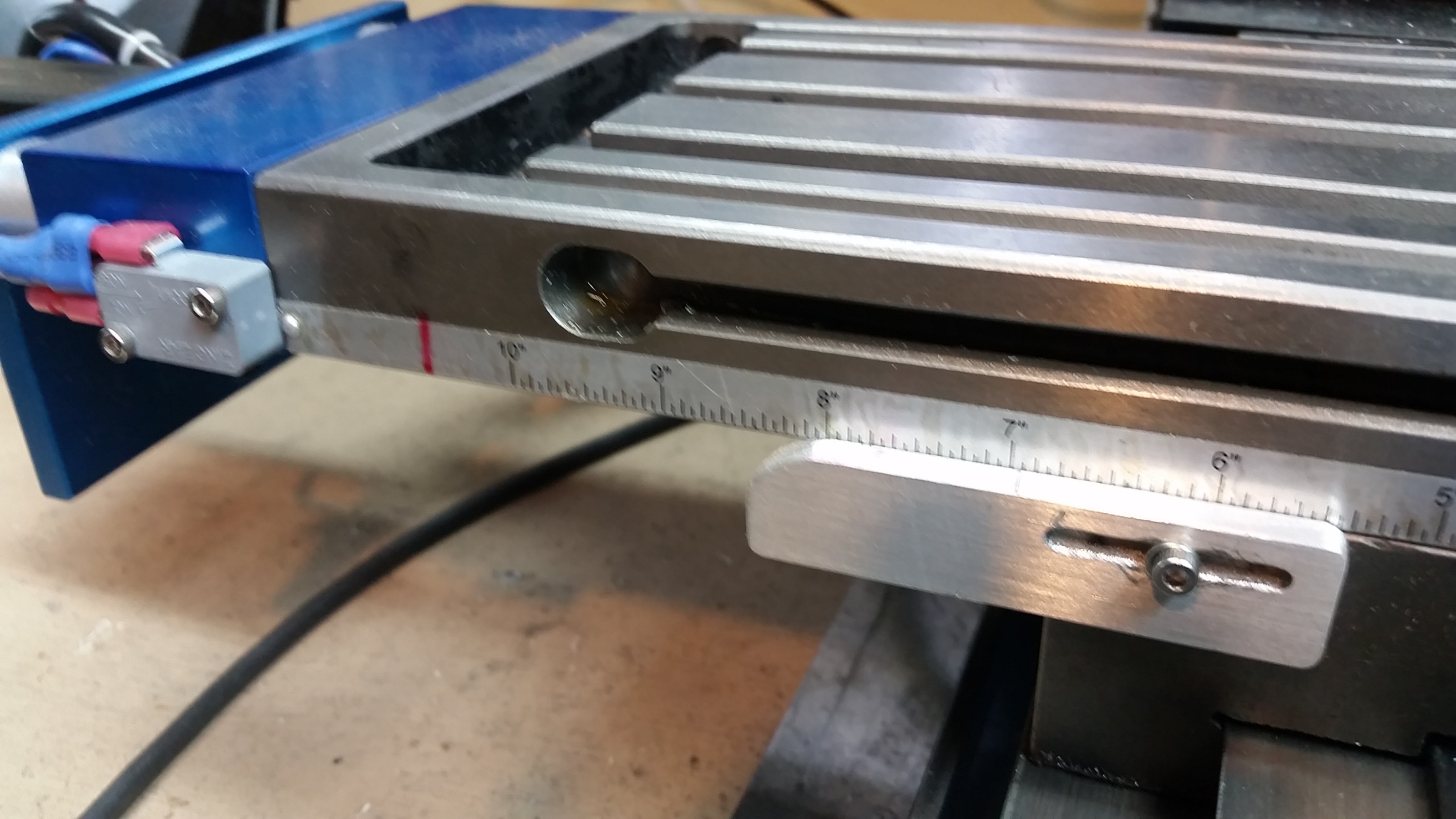

13 May 2018 17:02 - 13 May 2018 17:07 #110688 by DanMN
Replied by DanMN on topic Parallel limit switch connection problem
Also, if you're going to use the limit switch as homing switch also, make sure you leave physical distance for overshoot during latching. Usually the trip plate will be oriented so that overshoot won't crush the switch - like the example in my pic. That's why no-touch sensors are preferred for homing, but it's possible to use microswitches if you use very slow latch velocities and the trip arm of the switch doesn't get bent in overshoot.
