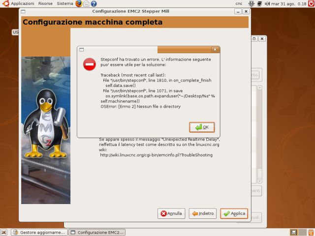

03 Sep 2010 14:59 #3971
by saviothecnic
Errore in Step Config was created by saviothecnic
- Posts: 7959
- Thank you received: 2162
05 Sep 2010 03:53 #3981
Replied by cmorley on topic Re:Errore in Step Config
This was fixed in EMC 2.3.2 . You need to upgrade to at least that.

05 Sep 2010 06:29 #3982
by saviothecnic
Replied by saviothecnic on topic Re:Errore in Step Config
Ok sorry if I write bad but use automatic translation software.
Now I reinstall from 0 to the 2.4.3 update right away and try again.

06 Sep 2010 07:28 #3994
by saviothecnic
Tutto Ok adesso funziona Grazie
Dopo aggiornato dalla 2.3.5 alla ver 2.4.3 dava un altro errore Emc2 Var
ma ho risolto rilanciando stepconfig
Adesso sto provando ad aggiornare ubuntu alla 10.04
Everything works Ok now Thanks
After upgraded from ver 2.3.5 to 2.4.3 gave another error but I resolved EMC2 Var raising stepconfig
Now I'm trying to upgrade to Ubuntu 10.04
