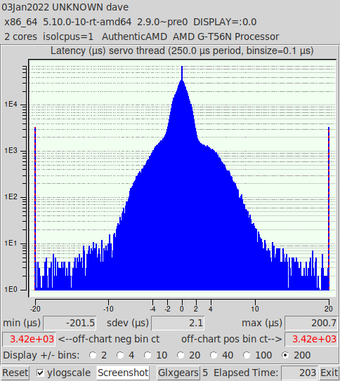

Thanks James - I tried the idle=poll method and have a servo around 193.
Ran the hog.sh script and i get the following in the terminal window -
pid 3745's current affinity mask: 1
taskset: failed to set pid 3745's affinity: Invalid argument

Why the 250us servo thread ?
I honestly think that if you had the same OS kernel and desk top environment you’d be getting the same or at least similar results.
The choice of desktop environment can affect latency due to the differing resources each consumes.
Gnome is on the heavier side where as xfce is one of the lighter ones.
When I did my respin of Mint I went for the xfce version as a base rather Mate. I tried a few kernels and decide on 4.19.106 as that gave better results than the 5 series available at the time.
Sometimes, probably more so on the lighter machines, the latest distro and kernel isn’t the best option.

In the case of this machine i suspect your issue is kernel/distro related. When i did my initial work i tried debian 10 and ended up on mint 19.3 for a very good reason.
i have not done any tests on Debian 11(bullseye). I am not surprised it performs poorly. If you are serious about needing bullseye then you might need to look at custom kernel compiles.

I wouldn't be too quick to dismiss the T610. I have Arch linux running on it with similar latency to my Mint 19.3 tests. And when it comes to "modern" or "latest and greatest" not much is going to beat Arch.

I was more thinking of the use qtpyvcp. The figures so far look like it should be good for Axis.

its fine with Axis. It's actually fine with qtpyvcp. The "killer" is VTK which is a bit of a cpu hog. But I'm going to do some more tests of that particular component now I have working monokrom-plasma sim.
