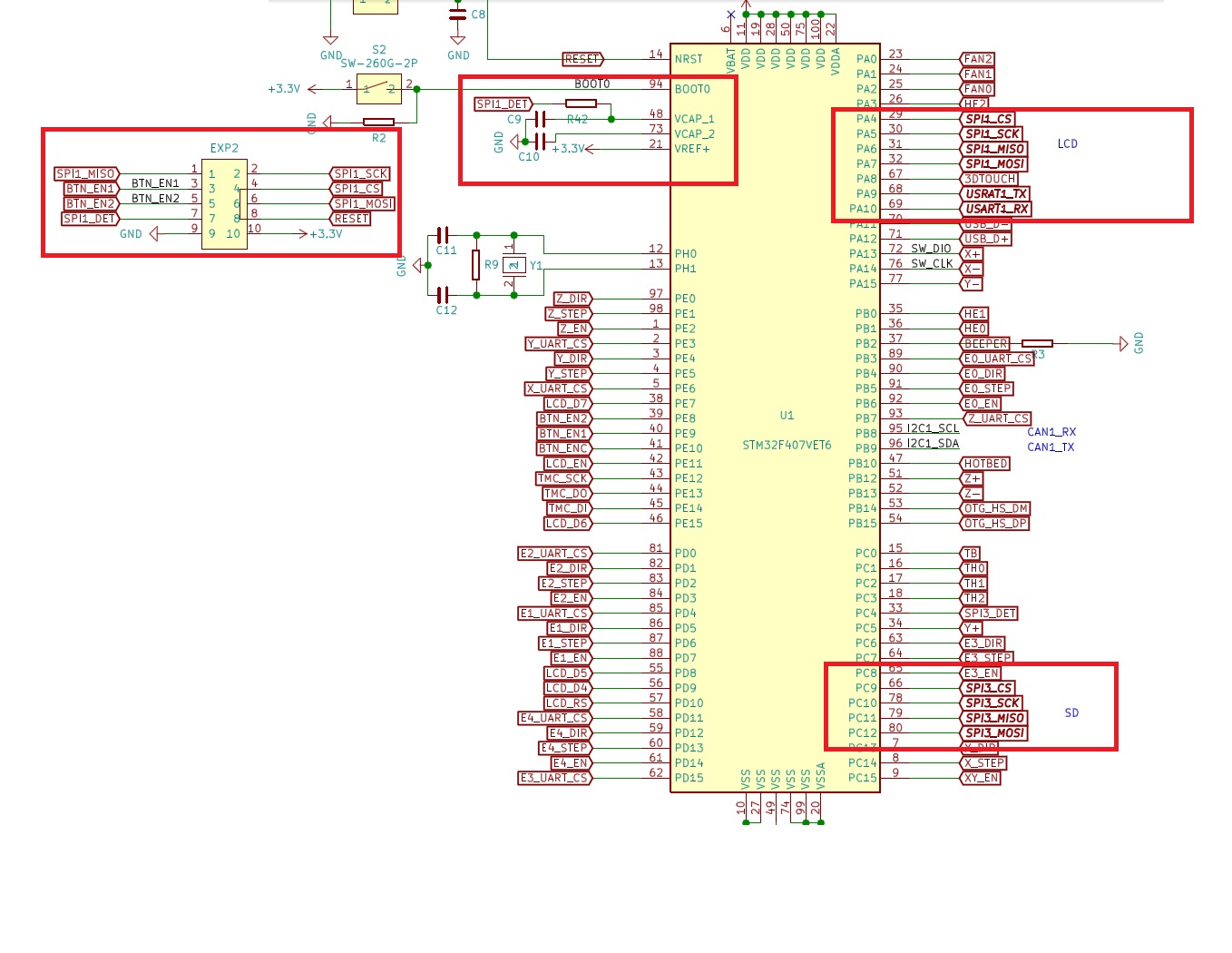

yeah it looks like they are on the same spi channel as exp, spi1
ok, and looks like the MKS monster8 has sd on spi3, will this fall under the same firmware?

ok, so as far as i can tell from the dev repo,
The MKS M8 looks similar to the mks robin, so I setup SDblockdevice for my spi3 pins, and use spi1 pa_4 as the spi interrupt because no shared SPI. The MKS Monster8 is an stm32f407
something like this i hope
, But I have some confusion with the reset pin, pin 7 on exp2 is tied to vcap_1, so would I need to shift my resetpin over to another pin on exp2, like pin5 or 3?
#elif defined TARGET_MONSTER8
SDBlockDevice blockDevice(PC_12, PC_11, PC_10, PC_9); // mosi, miso, sclk, cs
RemoraComms comms(ptrRxData, ptrTxData, SPI1, PA_4);, But I have some confusion with the reset pin, pin 7 on exp2 is tied to vcap_1, so would I need to shift my resetpin over to another pin on exp2, like pin5 or 3?

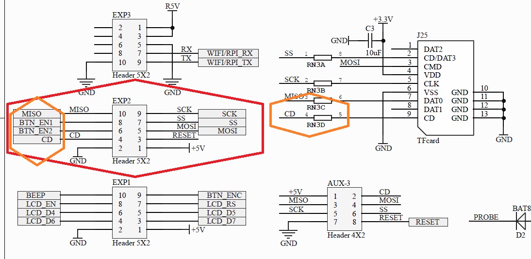

Then, for the fysetc spider, I need shared SPI, so my thing will look more like the skr_mini_e3, with sdblockdevice on spi1 with shared spi,
I have a question about the software nss pin, where do I actually connect it to? Is this another pin that goes to the RPI io? Can I connect it to what ever pin is convenient?
The pin I would be using for the reset pin (pb_10) is also shared with the SD card SD_DET/CS, does this mean I cannot use it as the reset pin?
since there is now a shared SPI option, for boards with out an SD card slot, like fysetc S6, btt rumba32, and BTT002, if I connected the spi1 to and sd-spi breakout/spi-flash breakout like the ones featured below, in the same fashion the shared SPI is connected, could I use them in place of onboard sd card slot?

Hi, we'll need to update the RemoraComms.cpp for the STM32F4 in a similar way as for the F1.
github.com/scottalford75/Remora/blob/dev...omms/RemoraComms.cpp
Here you will see in the constructor if the chip select (interrupt pin) is the NSS pin or not, ie shared.
In the init() function there is a condition for when it is shared to set software NSS and then setting it to always on.
This functionality needs to be added to:
The alternate chip select pin must also be interrupt capable, there should be one of these available on a header. You can see in the STM32F1 example that it will be possible to have different pins for different boards.
