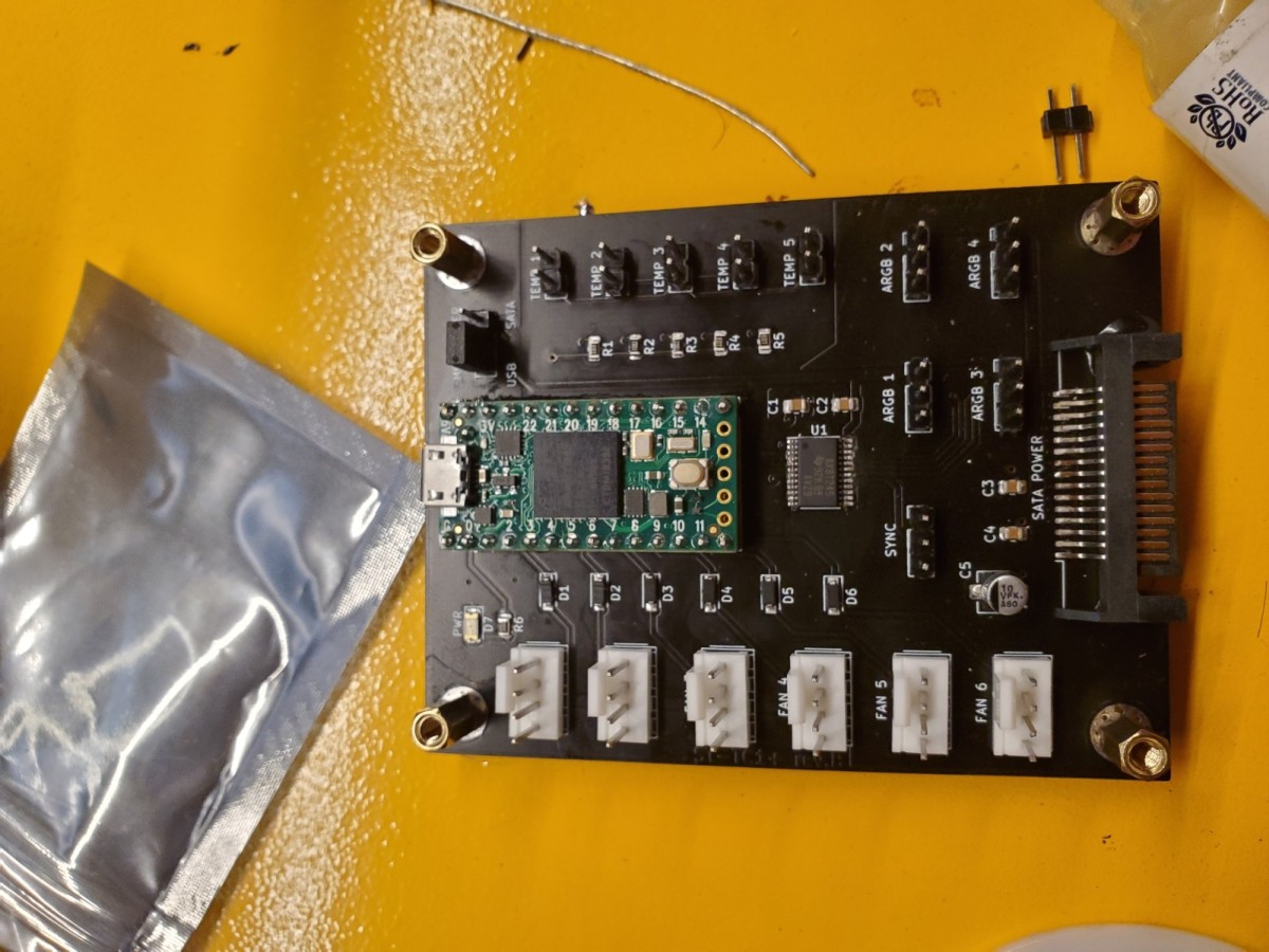

Any chance of looking at moving the Teensy 4.x into this project? Been thinking about trying to get some use out of one on my LinuxCNC machines but no real projects have popped up yet..... 600mhz (can overclock to 1ghz), 4 hardware encoders that can theoretically run @ 150mhz, ethernet, SPI, pins are a bit limited but there's ways around that.
For the hardware encoders to be utilized, a special library is used....
github.com/mjs513/Teensy-4.x-Quad-Encoder-Library
Like I said I make a few things using Teensy's so I'm hoping someone gets a LinuxCNC thing going so I can do something along those lines
- Bari
- Posts: 639
- Thank you received: 234
12 Dec 2021 20:05 #228942
by Bari
Replied by Bari on topic Remora - Rpi Software Stepping Using External Microcontroller via SPI
You already found the other thread for the Teensy 4.1 forum.linuxcnc.org/18-computer/43212-teensy-based-cnc-board
Nobody has publicly posted their intentions or code for the Teensy 4.1 yet. Just questions and some info about it so far.
