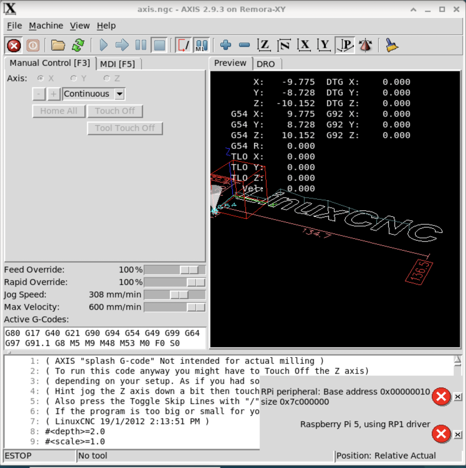

12 Feb 2025 18:24 - 12 Feb 2025 18:26 #321362
by jairobbo
Replied by jairobbo on topic Remora - Rpi Software Stepping Using External Microcontroller via SPI
Hi all,

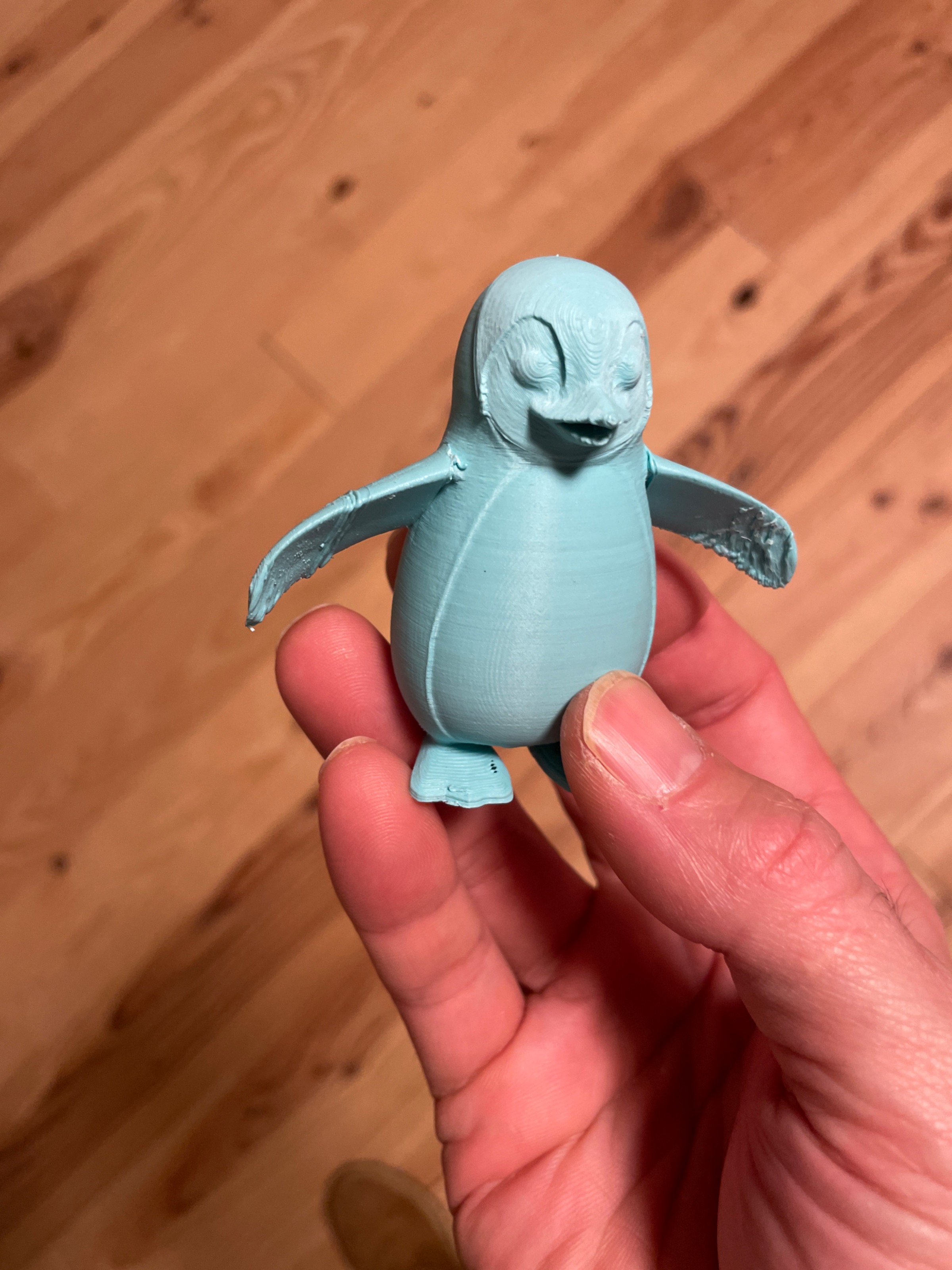

I’m quite new here and still have a lot to learn, thanks all for your patience. I have been trying my best to get good print results with an Ender3 with a 100mm round build plate on two rotational axes. I wrote a blender addon that does ‘indexed’ 5 axis printing.
My setup with the pi 5 and gpio was not a suitable solution. I am hoping to get my octopus v1.1 working with remora.
1) I successfully flashed the mcu
2) my wiring is correct
3) I get no read response from spi connection
4) when I start Linux cnc with my config, it says that joint.5.scale is not found ( extruder)
I will attach my hal and ini files in a bit.
Last edit: 12 Feb 2025 18:26 by jairobbo.

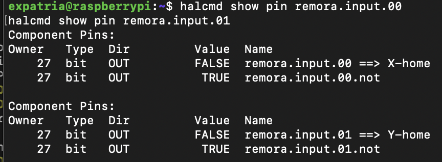

13 Feb 2025 20:23 - 13 Feb 2025 20:25 #321479
by jairobbo
Stuck in e-stop
tried using jumpers on diag0 and diag1 and monitored the pins:
halcmd show pin remora.input.00
halcmd show pin remora.input.01
nothing changed when pulling signal either high or low.
checked hal and ini files, still trying to get the hang of it, I checked if the current tool pos was out of bounds...
thanks for helping out,
Jairo

- cakeslob
- Posts: 927
- Thank you received: 280
14 Feb 2025 01:30 #321499
by cakeslob
Replied by cakeslob on topic Remora - Rpi Software Stepping Using External Microcontroller via SPI
I havent done this in a long time, but I dont think the pins will update if you are trying to do it like that. you probably need to connect to remora with loadrt or something, but it is easier to just use linuxcnc and halshow
looks like the remora comp is working correctly, but if you cannot get out of estop there is something else wrong.
remora-docs.readthedocs.io/en/latest/development/checklist.html
Go over the checklist, and make sure you have successfully completed all the tasks. there are detailed articles for every point on the list
