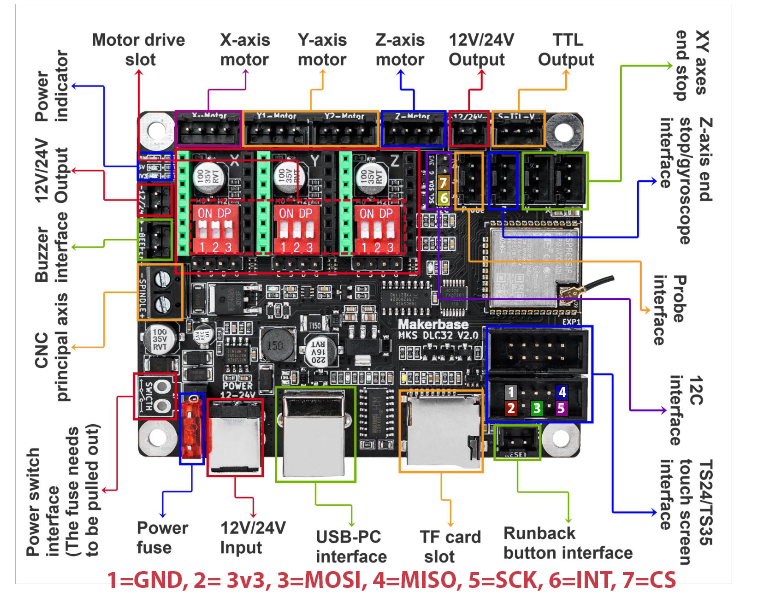

Good evening, can anyone help me, I'm using a mks dlc32 board, I managed to install the firmware on the board, but communication with Linuxcnc when trying to move the axes doesn't work, I've already installed this library on other esp32s, it always worked, I don't know if maybe not. I made the wrong w5000 ethernet on the board, could you help me, does anyone know the connection pinout on the w 5000? I don't get any errors when compiling and writing the firmware on the board so I think that must be it

This has a huge amount of stuff that can be set, so start by enabling wifi and try connecting to it from a PC or phone, there it should be easier to enable stuff and assign step/dir and IO pins.
All this should be done from the serial console first, there you can also check the W5500 wiring pins.
Just type help in the console....

Could you give me a step by step? I don't really understand what I should do

In Visual Code/PlatformIO in the upper right corner click on serial monitor, on the bootom part type help, that will show all the available commands, set the wifi mode, SSID and password, connect to that wifi.
