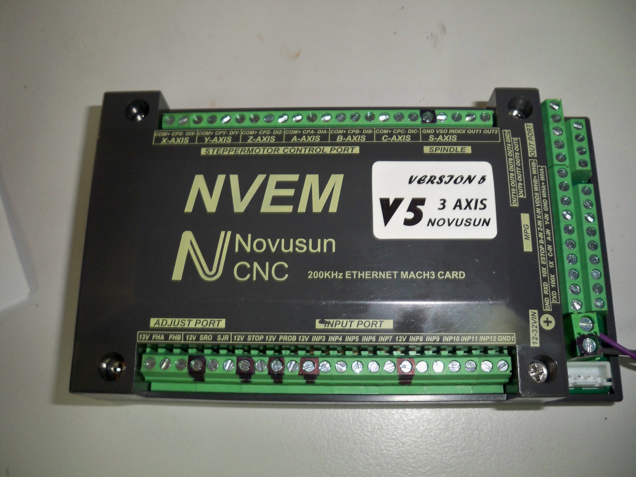

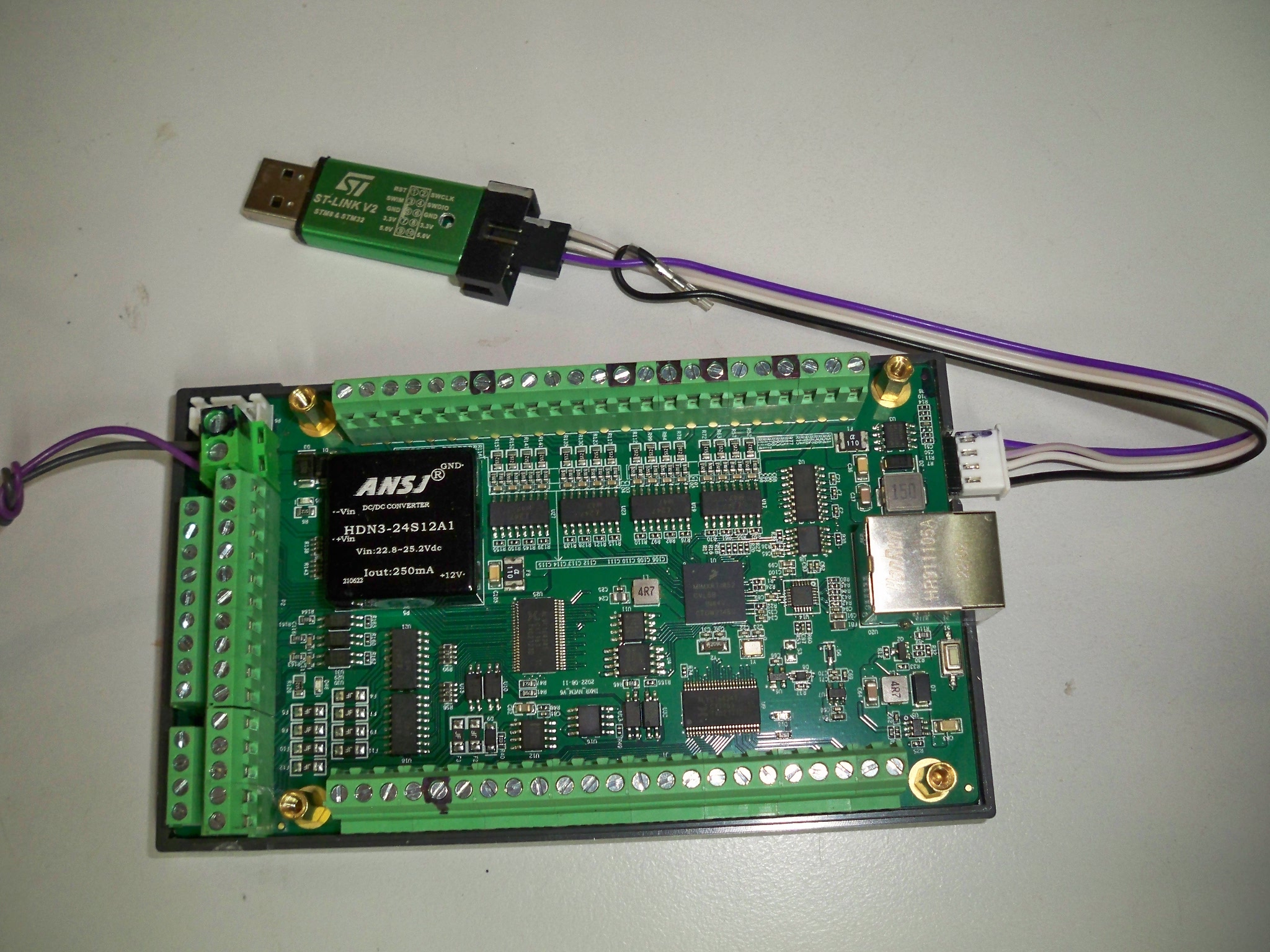

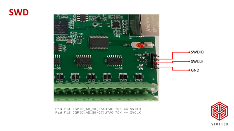

26 Mar 2023 07:28 - 26 Mar 2023 07:33 #267517
by frayja2002
Replied by frayja2002 on topic Remora - ethernet NVEM / EC300 / EC500 cnc board
Hi all
I have been playing with a NVEM RT-1052 box that I received & have been trying to flash the firmware. (My previous one was an STM32)
For the benefit of all who follow I thought I would post a summary of how I did it.
I was finding it a bit of a challenge & at one stage thought I might have blown the board. The DAPlink method didn't work for me either.
Thanks to fintech who posted the working command earlier in the thread.
So....
I used an ST-link programmer.
On a new install of Linuxcnc (Buster) install python-pip (not python3-pip)
sudo apt install python-pip
This will allow you to install pyocd....
sudo python -m pip install -U pyocd
You can then connect you ST-link via USB & connect that to your NVEM. Power on the NVEM.
I ran the following command as root because I wanted to be sure that there would be no per mission problems. If some-one would like to test this as a normal user, that would be good.
sudo pyocd flash ./remora-rt1052.bin --target mimxrt1050_quadspi
The file remora-rt1052.bin is located in the downloaded repository at Remora-RT1052-main/firmware. Make sure you are in the right place.
Set you IP address to 10.10.10.9 & try pinging 10.10.10.10
I have attached I file which shows all of the gumf you can expect to see on the screen & hope this helps someone comming in cold.
I have also attached some photos to help.
Alex
NB I Followed the pic for an EC300 board but I believe the pin connection is the same.
